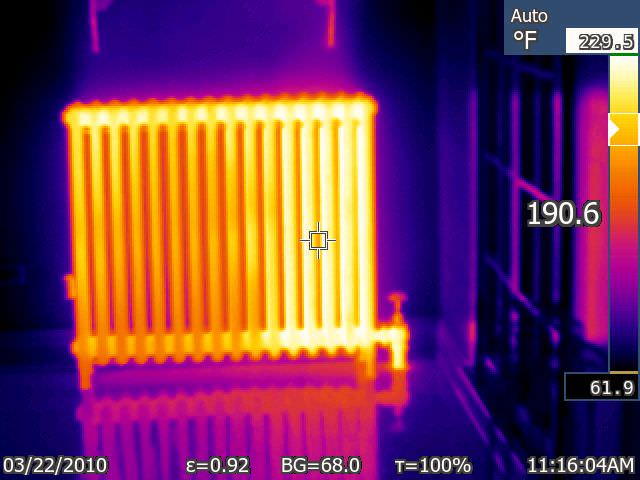

kurt Posted March 23, 2010 Report Share Posted March 23, 2010 The TiR32, that is. Played with it for a week orienting myself to the machinery, pulled it out yesterday for the first time on a job, and found a failed tile pan that had recently been "repaired". Initial establishing shot showed nothing, plugged the drain and filled the pan, looked over other stuff, came back and found a nice big spot on the ceiling, completely invisible to the eye. Even after 2 hours, nothing was visible. The camera told me where to measure, I did, 32%, voila, pan still leaking. Big smiles all around except for the listing agent. I now understand Chris' discussion of how it's only a useful tool for determining the best place to "dig"; it's not magic. Gotta have a Protimeter to go with it, or it's worthless. Here's a couple cool shots of the steam boiler and radiators........still figuring out palettes and focus stuff. I also understand the resolution part a lot more. Click to Enlarge 48 KB Click to Enlarge 60.28 KB Click to Enlarge 45.38 KB Link to comment Share on other sites More sharing options...
Chad Fabry Posted March 23, 2010 Report Share Posted March 23, 2010 That is too cool. Damn you for showing me the plumbing picture. Link to comment Share on other sites More sharing options...

kurt Posted March 23, 2010 Author Report Share Posted March 23, 2010 $8500-ish I made up my mind a while back, and now I just want to forget about it and focus on how I'm going to use it to make money. Yesterday's find has already led to an associate of my customer wanting his house "shot". I don't think one necessarily has to have a "marketing program" for this tool, and I don't think it's magic. It's another tool in the bag that I'm finding uses for, and I've already got 4 folks walking around the city telling their friends about "this inspector with an IR camera" after a single job. And I got my HVAC guys talking it up to their customers to check equipment. I just don't see how I can go wrong. I'm a total believer in more money for better resolution, though. The 160x120 jobs are OK, useful for some things, but the 320x240 rez is unbelievable; you can read the thing and actually see what you have to see. Link to comment Share on other sites More sharing options...

caryseidner Posted March 23, 2010 Report Share Posted March 23, 2010 Your camera takes waaaay sharper images than my TiR1! After I saw your photos I pulled up some of mine for a comparison and, well there is none. Click to Enlarge 18.4 KB Link to comment Share on other sites More sharing options...

Brad Manor Posted March 23, 2010 Report Share Posted March 23, 2010 I have a TiR that I use quite a bit (they're awesome when used in conjunction with a blower door). The resolution on Kurt's is incredible. -Brad Link to comment Share on other sites More sharing options...
