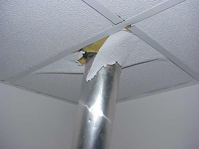

barlyhop Posted April 29, 2010 Report Share Posted April 29, 2010 I found this yesterday. Metal dryer vent ran through fiberglass flexible ceiling panel with no clearance. Ceiling panel was visibly distorted from heat. I called for removing the ceiling panel in this area. What else would you say about this? Thanks Click to Enlarge 43.42 KB Quote Link to comment Share on other sites More sharing options...
Mike Lamb Posted April 29, 2010 Report Share Posted April 29, 2010 Dryer ducts have no clearance requirements from combustibles so I see nothing wrong here as far as the duct is concerned. If the duct is over heating as you suspect, someone needs to seriously evaluate the dryer and the duct system. Quote Link to comment Share on other sites More sharing options...
kurt Posted April 29, 2010 Report Share Posted April 29, 2010 I'd bet a dime the duct is clogged up and not functional. Duct length varies wildly from mfg. to mfg. Go to the chart here, scroll down, and find your model. As a basic rule, figure about 25'-27' max length, and take off about 5' for every 90 bend, although I've read deduct anywhere from 3' to 9' for a 90 bend. If it's vertical, which yours is, you want to take reduce length considerably. So, essentially, you don't want any duct longer than about 10'-12' if there's a bend in it anywhere, and there always are a couple. Smooth walled only. No screws extending into the duct; tape the seams. Quote Link to comment Share on other sites More sharing options...

hausdok Posted April 30, 2010 Report Share Posted April 30, 2010 Rivets would not be a good idea. The rivets will collect lint - that's why CPSC recommends using foil tape. Dryer ducts get hot; that's a fact of life. That's why they don't recommend drying objects with rubber and plastic in the clothes dryer on the normal timed high heat setting. It could very well be clogged as Kurt said, or it might just have a few bends that are slowing down the air being pushed through it and making the metal hotter. Either way, I don't see some distorted plastic-faced ceiling panels with a hacked-through hole being a fire hazard. Heck the danged outlets are plastic half the time. ONE TEAM - ONE FIGHT!!! Mike Quote Link to comment Share on other sites More sharing options...

barlyhop Posted April 30, 2010 Author Report Share Posted April 30, 2010 Just above the ceiling, the metal pipe was connected to a heavy PVC pipe of the same diameter. The run had the one 90 there and then straight out through the wall about 8 feet. Maybe it was condensation damage and not heat? The plastic coating on the ceiling tile just looked distorted. Never saw a PVC pipe for a dryer run before. Thanks to all! Randy Quote Link to comment Share on other sites More sharing options...
Marc Posted April 30, 2010 Report Share Posted April 30, 2010 A 114 unit condo complex where I once lived had underslab runs of PVC pipe for the dryer exhaust on about half of the units.. I derived a lot of service calls from that because the earth would cool the exhaust too much and the water which had evaporated from the clothes would condense inside the pipe, eventually filling it, since the pipe had to rise at both ends. I would vaccum them out and clean them. You could actually hear the gurgling sounds when the dryer was on. This was after I got my ears back and once I had learned the sound of gurgling water. Marc Quote Link to comment Share on other sites More sharing options...

Chad Fabry Posted April 30, 2010 Report Share Posted April 30, 2010 PVC isn't allowed for dryer ducting. The ducting must be non-combustible. Quote Link to comment Share on other sites More sharing options...

Bain Posted April 30, 2010 Report Share Posted April 30, 2010 PVC isn't allowed for dryer ducting. The ducting must be non-combustible. I realize you're right, but it's used all the time here--in basements, slabs, crawlspaces. It's so pervasive I never call it a defect. Quote Link to comment Share on other sites More sharing options...

pete moss Posted May 1, 2010 Report Share Posted May 1, 2010 In addition to being combustible, PVC should not be used for Dryer Vents due to static. Lint will accumulate within the piping at an accellerated rate. Quote Link to comment Share on other sites More sharing options...

lockem Posted December 30, 2015 Report Share Posted December 30, 2015 It is worth noting that PVC is not combustible. It melts at a low temperature, it burns when a flame is held to it (so will steel and aluminum), and when it burns it gives off extremely toxic fumes, but it will not sustain a flame on its own. At least 1 website claims that the IRC requires a minimum of 28 gauge steel for dryer ducts. They did not quote the paragraph giving this requirement. I presume that any such requirement (if it exists) is there with the intent of containing small lint fires inside of the duct. 30 gauge steel seems to be the standard product to use, though. Does anyone know if this 28 gauge minimum is real? My question is how much clearance is needed between an ABS DWV pipe and a dryer duct? I am concerned about overheating the ABS pipe and causing it to deform or melt. Without making the duct difficult to route, I end up with about 1 inch of clearance to the bottom of the washing machine standpipe P trap. Quote Link to comment Share on other sites More sharing options...
Marc Posted December 30, 2015 Report Share Posted December 30, 2015 2006 IRC: M1502.5 Duct Construction Exhaust ducts shall be constructed of minimum 0.016 inch thick (0.4 mm) rigid metal ducts, having smooth..... 0.016 inch translates into 27 gauge. Inch to gauge Marc Quote Link to comment Share on other sites More sharing options...
