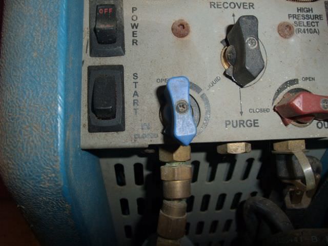

Terry, This is a photo of my recovery unit. Bought it about 10 years ago. Look at the blue dial and the setting that says 'liquid'. Now, I don't think that there is a pump installed, rather it's just an orifice or heat source that boils the incoming liquid refrigerant so that only gaseous refrigerant enters the compressor. I could be wrong.
Click to Enlarge
45.49 KB
Marc

That's for refrigerant, not oil, however I understand your point. The Robinair recovery machines we used had a liquid switch to so that you could tap the liquid line thereby evacuating the system quicker. The point is you wouldn't use a recovery machine to pull a vacuum and a recovery machine, as well as a vacuum pump, does not remove compressor oil.
A recovery machine and a vacuum pump are two different animals.
