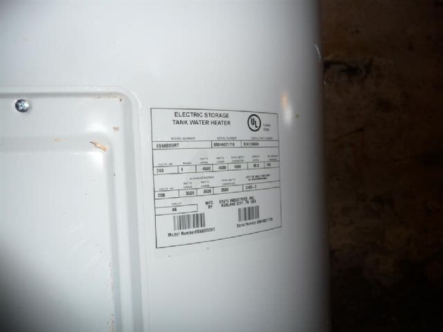

gtblum Posted May 12, 2010 Report Share Posted May 12, 2010 State 80 gallon electric # 0904A021710 How old is it? Click to Enlarge 23.13 KB Quote Link to comment Share on other sites More sharing options...
Nolan Kienitz Posted May 13, 2010 Report Share Posted May 13, 2010 State usually uses an alpha plus two, but there is a bogey of 4 digits leading. Could be 2004 or 2002. Quote Link to comment Share on other sites More sharing options...
gtblum Posted May 13, 2010 Author Report Share Posted May 13, 2010 State usually uses an alpha plus two, but there is a bogey of 4 digits leading. Could be 2004 or 2002. That's why it's here. The pain in the ass is, I really need it this time. The buyer was told It's newish. Like one or two. Could be 2004 or 2002. I don't want to guess. I thought that too. Looks like I'm making a call in the morning. Thanks, Quote Link to comment Share on other sites More sharing options...
HIS2 Posted May 13, 2010 Report Share Posted May 13, 2010 https://www.inspectorsjournal.com/Forum ... IC_ID=2542 Mike posted this in Feb of '06. I've used it a couple of times. According to this thread - it was manufactured in Jan of '02 Quote Link to comment Share on other sites More sharing options...
gtblum Posted May 13, 2010 Author Report Share Posted May 13, 2010 https://www.inspectorsjournal.com/Forum/topic.asp?TOPIC_ID=2542 Mike posted this in Feb of '06. I've used it a couple of times. According to this thread - it was manufactured in Jan of '02 The difference is that with these the code is in the first three positions of the serial number therefore a serial number C05******* What month is 0 or O? Quote Link to comment Share on other sites More sharing options...

kurt Posted May 13, 2010 Report Share Posted May 13, 2010 I'd say it was mfg. in September of 2004. Probably installed sometime in '05-ish. Of course, I'm probably wrong, but it's just a crappy water heater. I'd be more concerned about all the other stuff with water heaters. And, zero is a number. Or an integer. It's on the number line between 1 and -1. You can add, subtract, multiply, divide, and come up with answers. (I so wanted it to not be a number, so I could stuff it up Mr. "disposall takes 2 L's" keester......) I've been trying to find a date on my water heater TPRV, and I can't find one anywhere, nohow...... Quote Link to comment Share on other sites More sharing options...
gtblum Posted May 13, 2010 Author Report Share Posted May 13, 2010 https://www.inspectorsjournal.com/Forum/topic.asp?TOPIC_ID=2542 Mike posted this in Feb of '06. I've used it a couple of times. According to this thread - it was manufactured in Jan of '02 The difference is that with these the code is in the first three positions of the serial number therefore a serial number C05******* What month is 0 or O? My point was, O or 0 doesn't work. The last letter would have to be L; December. I busted a bunch of liars last month. I Just want to make sure these folks are being told the truth and I want to know why that number is different in case I run into it again. Screw it. I'm going to the golf course. Quote Link to comment Share on other sites More sharing options...

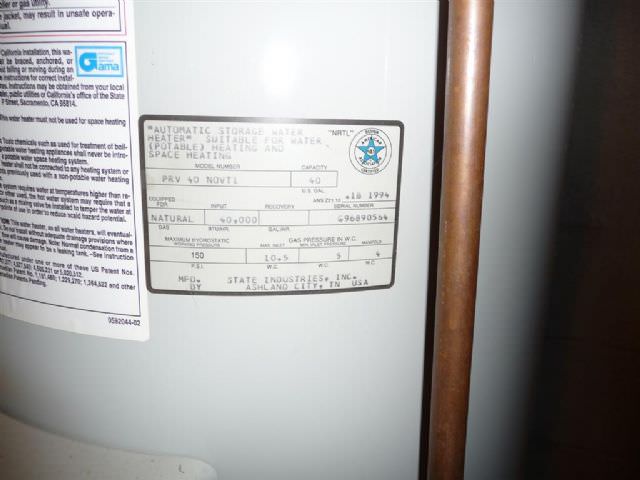

gtblum Posted May 13, 2010 Author Report Share Posted May 13, 2010 Yes, A is January and 02 is the year. It's 8 years old. I just went through my picture files. Every State heater serial number starts with a letter just like our file says they should. Not in the middle of the number. As you can see in the picture, this one has a letter in the middle. I see them as often as any other around here. I'll take your word for it that it's eight years old. But before anyone decides I'm being a pain in the ass or nuts about this, it ain't the same as all of the rest. Why? Click to Enlarge 29.22 KB Click to Enlarge 38.03 KB Click to Enlarge 25.7 KB Quote Link to comment Share on other sites More sharing options...
hausdok Posted May 13, 2010 Report Share Posted May 13, 2010 Just a guess but maybe it's a commercial type and they number them differently. I just spent about ten minutes going through everything on the State website and I couldn't find a current explanation of their numbering code. ONE TEAM - ONE FIGHT!!! Mike Quote Link to comment Share on other sites More sharing options...

Jim Katen Posted May 14, 2010 Report Share Posted May 14, 2010 . . . But before anyone decides I'm being a pain in the ass or nuts about this, it ain't the same as all of the rest. Why? . . Call State & ask them. Quote Link to comment Share on other sites More sharing options...
gtblum Posted May 14, 2010 Author Report Share Posted May 14, 2010 Call State & ask them. Here's the deal. As of the last week of 2007, State serial numbers no longer use letters. 0904A021710 April 2009 Quote Link to comment Share on other sites More sharing options...
hausdok Posted May 14, 2010 Report Share Posted May 14, 2010 Hi Gary, Thanks, that's huge because it will affect about 20 brands made by State and sold under different names. I'll update our chart. ONE TEAM - ONE FIGHT!!! Mike Quote Link to comment Share on other sites More sharing options...
hausdok Posted May 14, 2010 Report Share Posted May 14, 2010 Hi All OK, I've update the State section of the chart to reflect the new serial number code and I've posted the new chart to the file library at this link: https://www.inspectorsjournal.com/forum ... oto&id=120 I've also written to AO Smith, because they've apparently assimilated State, and have asked them to provide me iwth a list of the companies that they currently own and an explanation of how to decode those various serial numbers. I'm not holding my breath that they'll answer too soon; so, if any of you see anything that needs correction on this decoder chart, or you have some other companies that we can add to it, please email me with that information at hausdok@msn.com Thanks ONE TEAM - ONE FIGHT!!! Mike Quote Link to comment Share on other sites More sharing options...
hausdok Posted October 26, 2010 Report Share Posted October 26, 2010 Hi All, Well A.O. Smith never responded to me so I called them today. I sort of had to because I'd had one of those new AO Smith serial numbers like Gary's above. They explained that they bought State Water Heaters in 2008 and that now that factory is making some of their residential products and is using the State serial number sequence; namely that the first two numbers are the year followed by a two digit week code. That means 0805XXXXXXX is the fifth week of 2008 or February 2008. I've amended the water heater date code chart to reflect this change and have posted it in both word and pdf format. The links are below. If you are unable to download the links, go directly to the library to the first plumbing category and you'll find them there. https://www.inspectorsjournal.com/forum ... oto&id=134 https://www.inspectorsjournal.com/forum ... oto&id=131 ONE TEAM - ONE FIGHT!!! Mike Quote Link to comment Share on other sites More sharing options...
