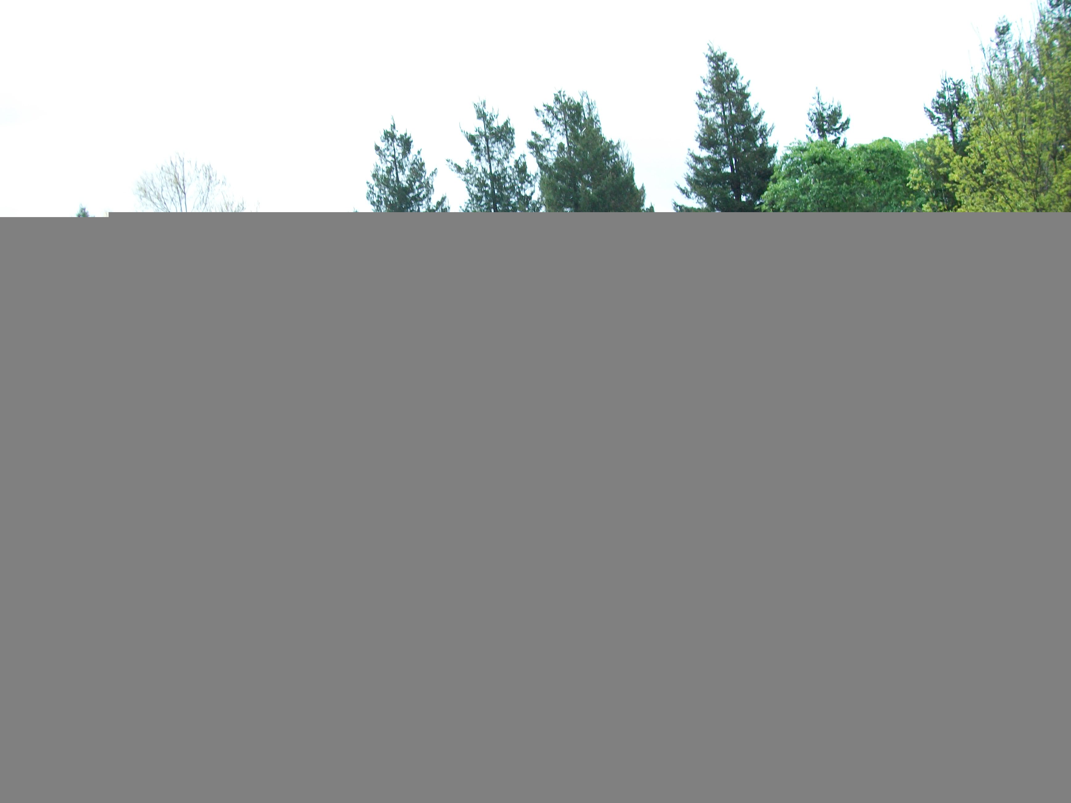

Rocon Posted May 28, 2010 Report Share Posted May 28, 2010 I saw the ridge vents installed on 20 buildings recently, all of the attics were very cool to walk in. The downside was that there were active leaks at the vents (6 of 240 units). Download Attachment: 2010 03 30 RRO 5548.JPG 1674.09 KB One word of warning. They cannot be used in California due to the roof daiphragm continuity being lost. Quote Link to comment Share on other sites More sharing options...
