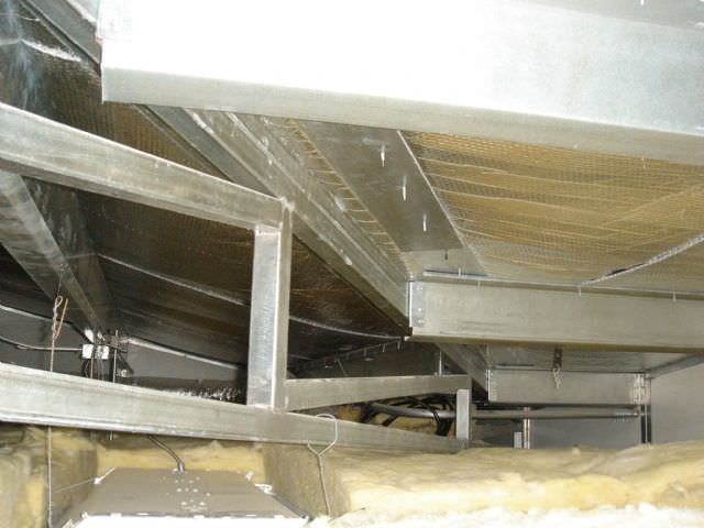

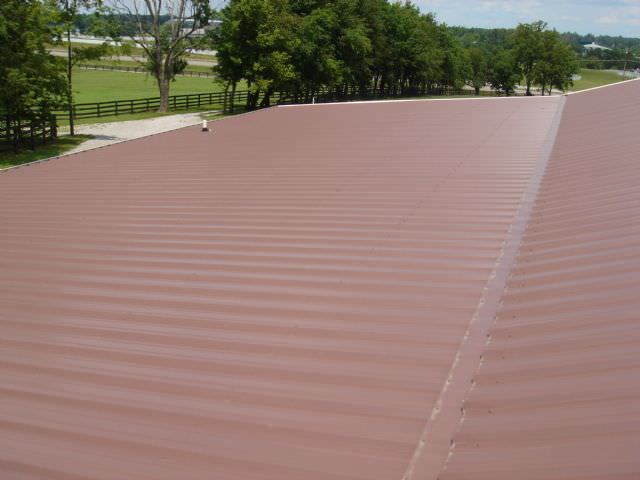

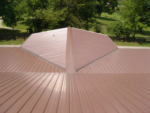

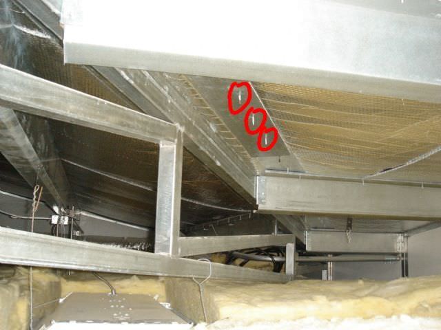

Bain Posted June 29, 2010 Report Share Posted June 29, 2010 Does anyone have expertise when it comes to metal roofs? I looked at one today that was less than a year old that has severe leakage problems, both in the valleys, and along the peripheral edges. You can see that the contractor has gooped on a bunch of rubber along the valley seams, but of course that's a temporary fix. What detail was likely screwed up when the roof was installed that necessitated the ugly repair? Insulation prevented me from seeing much from within the airspace above the lay-in ceiling. Click to Enlarge 56.3 KB Click to Enlarge 48.22 KB Click to Enlarge 39.8 KB Quote Link to comment Share on other sites More sharing options...
Erby Posted June 29, 2010 Report Share Posted June 29, 2010 Likely the valley metal doesn't extend far enough up under the roof. Water is overrunnin the valley up under the opposing side and overflowing. Don't know about the peripheal edges. Quote Link to comment Share on other sites More sharing options...
Brandon Whitmore Posted June 29, 2010 Report Share Posted June 29, 2010 How close were the fasteners to the valley centerline/ overlap? If any fasteners are near the valley overlap, water could be running between the roof panel and valley metal, and seep in there. Otherwise, I agree with Erby. About the only places that style of roof is installed around here is on shops/ outbuildings, because they tend to leak. Quote Link to comment Share on other sites More sharing options...
Marc Posted June 29, 2010 Report Share Posted June 29, 2010 Click to Enlarge 48.98 KB Click to Enlarge 40.35 KB Bain, the screws that line up just inside either side of the valley flashing aren't supposed to be there. It will definitely leak. The patch is an attempt to remedy that mistake. Decking is needed to support that flashing. It's true that many steel framed structures used metal panel roofing without roof decking successfully but that's because they didn't try to incorporate valleys like this one has. You've got to have decking for a design like that if you're going to use metal panel. I agree with you that the patch is temporary. It's an error in roof design and will always be a problem until it gets back on the drawing board. You just can't combine any building material with any building method and get good results. Marc Quote Link to comment Share on other sites More sharing options...

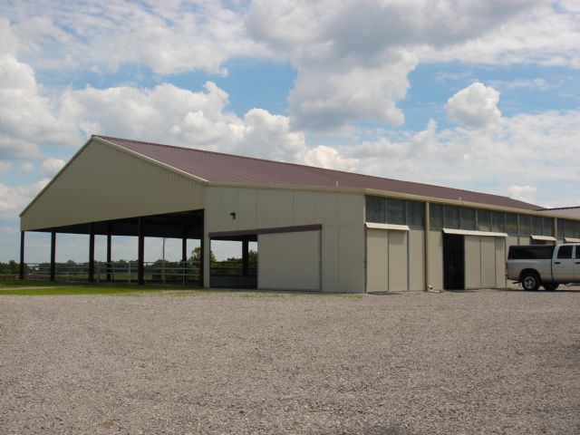

Bain Posted June 29, 2010 Author Report Share Posted June 29, 2010 Ah, got you. I don't see many metal roofs, but knew I could find help here. The exposure of the valley flashing occurred to me, but it looked fairly normal. I think the fasteners are the fatal flaw. Brandon, I always trash metal roofs--I see them on houses, infrequently--with exposed fasteners. This roof was on an equine veterinary-center buildng. The majority of the structure was an immense evaluation track, but there were two small offices attached, as well. I've looked at several houses for the CEO, and he asked me to to check out the roof to see what was up. What's the consensus? Rip out the yuck and begin anew? Click to Enlarge 34.2 KB Click to Enlarge 49.76 KB Click to Enlarge 44.26 KB Quote Link to comment Share on other sites More sharing options...

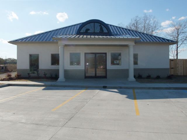

Marc Posted June 29, 2010 Report Share Posted June 29, 2010 What's the consensus? Rip out the yuck and begin anew? Yep. I did the same thing for this new Vet Hospital earlier this year. Notice the barrel roof in front. It leaked into the reception area before he even finished moving in. Click to Enlarge 37.78 KB Marc Quote Link to comment Share on other sites More sharing options...

Bain Posted June 30, 2010 Author Report Share Posted June 30, 2010 John, what's the pitch on that thing? It looks awfully shallow. If I'm right there is likely additional detailing for low slope configurations that you should be looking for, if the manufacturer even allows that panel on a low slope application. The Z flashing where the roof pitch changes will leak too, never seen one that didn't. I don't get horse folk. They'll spend a fortune on their animals but cheap out on building materials. If that were my building the roof would be standing seam, bent to follow the change in pitch, with soldered flat locks at the valley. Tom Tom, The slope was fine above the evaluation track, but between 2/12 and 3/12 on the portion above the office space. That concerned me, which is why I took the photos below. I need to Google some installation instructions to find out what's kosher and what isn't. You're right about the standing seam roof, but for a building this size, installed by someone with a reputation, the cost would have been 80-100 grand around here. I know, I know . . . but sadly it all comes back to the bucks. Thanks for the link and the .pdf, Rocon. I'll definitely take a look. Click to Enlarge 37.89 KB Click to Enlarge 57.03 KB Quote Link to comment Share on other sites More sharing options...

John Kogel Posted July 1, 2010 Report Share Posted July 1, 2010 that the patch is temporary. It's an error in roof design and will always be a problem until it gets back on the drawing board. You just can't combine any building material with any building method and get good results. Marc I agree with Marc and Erby. Any change in slope where there is a seam is a potential leak. It's a good bet water hits the valley and runs right over the top of the valley flashing. They could have folded a lip into the upper edges of the valley metal to stop that runoff from overflowing the valley. Then every screw below that lip is a potential leak. Screw holes get stretched by the expansion and contraction of the metal, so they have no place in a valley full of water. [] It can be fixed, but with new metal and solid decking in the valley. It's just a horse barn, but it's brand new horse barn, so no excuses. Quote Link to comment Share on other sites More sharing options...
