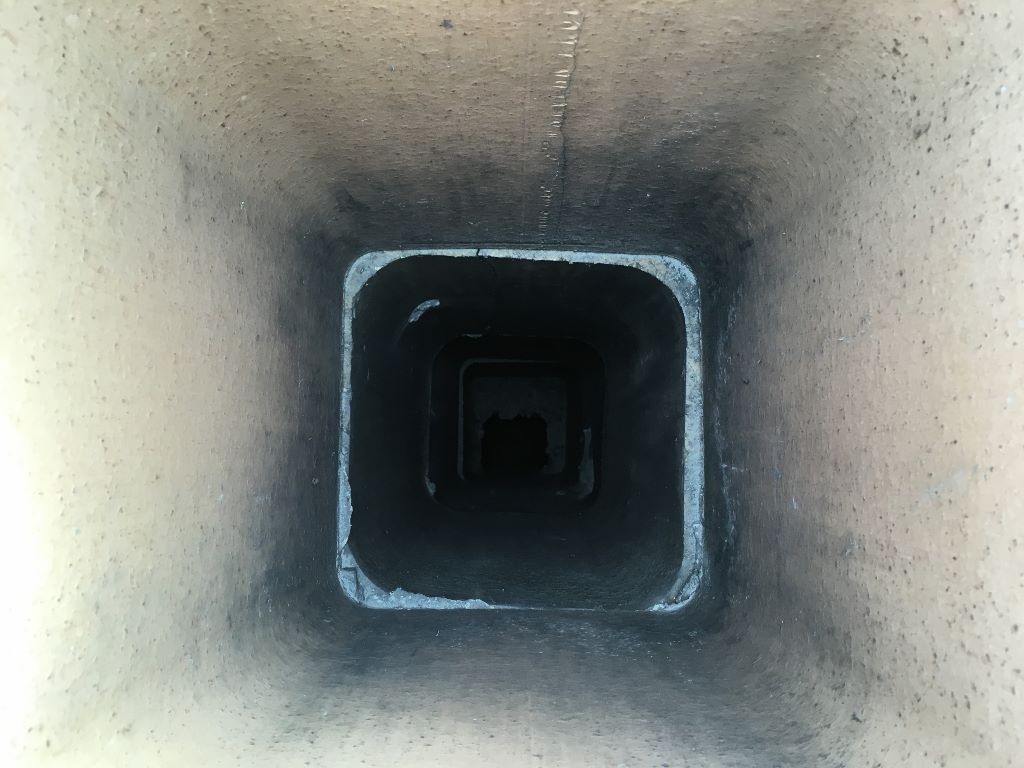

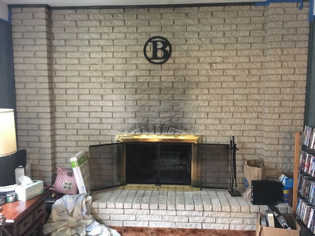

Is relining needed?
mjr6550 replied to mjr6550's topic in Fireplaces, Chimneys & Wood Burning Appliances
I agree that the soot could be from any number of things. But, I do tend to see soot stains above glass doors when it has been apparent that they burn fires with the doors closed. That is also when I tend to see creosote in the flue. Maybe minor fires in flue cause the conditions they say are present, but I am only familiar with major damage from chimney fires. -

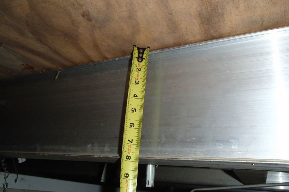

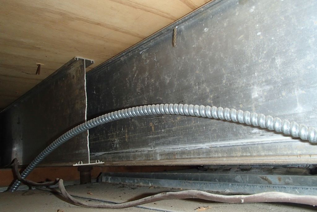

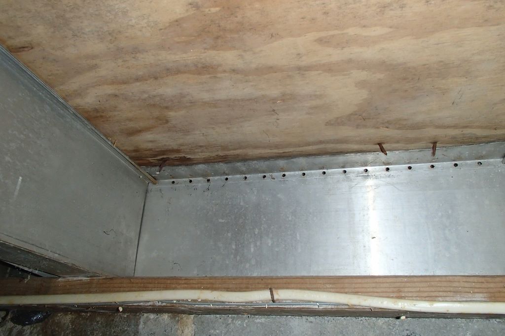

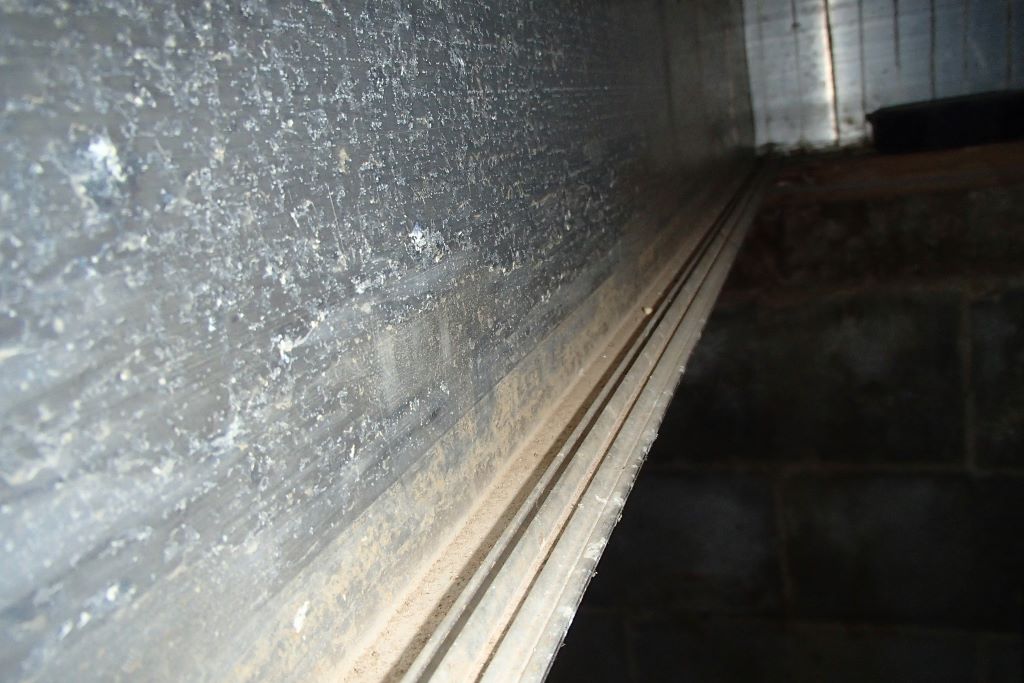

On one hand, they look fine. However, I was hired as an engineer to state that they are fine. Nothing is that easy for engineers. Considering the very narrow webs and the lack of any blocking or bridging, I question how they would perform if truly loaded to a design load, or with a concentrated load. Also, I question the performance should a fire occur. they may perform far worst than I-joists, which now have special requirements for protection from fire.
Is relining needed?
I agree with both of you. Getting an unbiased opinion may be hard. It seems like chimney sweeps/contractors want to line every flue. Most home inspectors probably won't want to give an opinion. I have not has time to look into this. I don't know what info is available regarding mortar joints and fires. The photos are not great quality either. -
1975 house. I have never seen this before. I could not find any markings on the joists. The odd cross-section makes me think they were manufactured for some other purpose and were surplus. Anybody seen these or have an idea what they may be?
I received a report with photos from my niece who lives in MI. The report indicates that there has been a chimney fire. My niece bought the house recently, so I have not history. This is a fireplace flue. No wood stove presently installed. The fireplace does have glass doors. Soot staining on the brick above the firebox says to me that someone might have been using the fireplace with the doors closed. any thoughts on whether a liner is needed? The contractor is proposing installing a cast ceramic (Fireguard) liner for about $1400.
