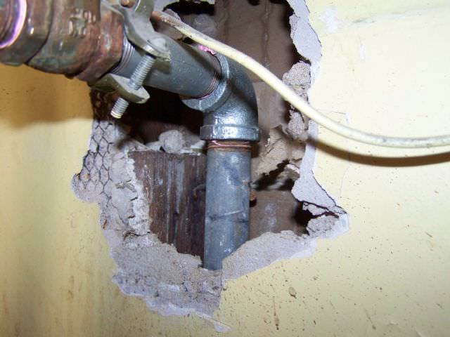

kimball gray Posted July 22, 2010 Report Share Posted July 22, 2010 house built in the 50's. the owner says the walls are cement. they look like cement. In the hot water closet I found an exposed area where damage had occured. You can see wire mesh behind the materil and no laths. What is it? Click to Enlarge 48.93 KB Link to comment Share on other sites More sharing options...
hausdok Posted July 22, 2010 Report Share Posted July 22, 2010 Interior Portland cement stucco. ONE TEAM - ONE FIGHT!!! Mike Link to comment Share on other sites More sharing options...
Mike Lamb Posted July 22, 2010 Report Share Posted July 22, 2010 That looks pretty much like plaster on metal lath to me. What's the tip off that it is stucco? Link to comment Share on other sites More sharing options...
kurt Posted July 22, 2010 Report Share Posted July 22, 2010 I guess you could call it stucco if you want. I thinks it's standard metal lath plaster. Portland scratch coat on the metal lath, gauging plaster on the scratch. Link to comment Share on other sites More sharing options...

John Kogel Posted July 23, 2010 Report Share Posted July 23, 2010 house built in the 50's. the owner says the walls are cement. they look like cement. Cement is the main ingredient, but the product is plaster or stucco.Add gravel, it becomes concrete. That's how I keep the terms straight, anyways. Link to comment Share on other sites More sharing options...
Marc Posted July 23, 2010 Report Share Posted July 23, 2010 house built in the 50's. the owner says the walls are cement. they look like cement. Cement is the main ingredient, but the product is plaster or stucco.Add gravel, it becomes concrete. That's how I keep the terms straight, anyways. I thought 'plaster' meant gypsum. Stucco is cementitious unless it's polymer based. Marc Link to comment Share on other sites More sharing options...
hausdok Posted July 23, 2010 Report Share Posted July 23, 2010 That looks pretty much like plaster on metal lath to me. What's the tip off that it is stucco? I always thought that plaster was made with crushed seashells and lime or some such and that it was white and creamy. Most plaster walls I've seen were gray when troweled on but dried to a nice white color not much darker than drywall. They looked much lighter that the stuff in that picture and had a very fine texture to them. Stucco on the other hand has always had a courser component to it and a much darker hue than the interior plasters I've seen. I've seen plaster used with wire lath before but never plaster with such course grain or such dark coloring. It looks exactly like the broken stucco I see quite often around here. That's why I thought it was plaster. Since I haven't worked with a lot of the stuff, I'll bow to Kurt's superior knowledge of the stuff. ONE TEAM - ONE FIGHT!!! Mike Link to comment Share on other sites More sharing options...
John Kogel Posted July 23, 2010 Report Share Posted July 23, 2010 Most old plaster I see from the back side, the brown coat, has a grey look, but they added a sand filler to it. AFAIK, plaster can be gypsum, cement or lime based, it's all plaster. Click to Enlarge 35.65 KB I'm no expert, but I gather Portland refers to a cement base. Link to comment Share on other sites More sharing options...
Bill Kibbel Posted July 23, 2010 Report Share Posted July 23, 2010 Kurt's got it right. By 1950, Portland cement was being used for almost all scratch coats. The final product is still called plaster. Link to comment Share on other sites More sharing options...
kurt Posted July 23, 2010 Report Share Posted July 23, 2010 Plaster's just a general term. It can be gypsum, lime based, or portland cement. "Plaster of Paris" is derived from the ancient gypsum deposit in Montmartre. It's still just gypsum plaster, although I like the idea of plaster from Paris. Lime plaster has problems, mainly that the material has to be kept in sealed containers and protected from air, or it sets up (exposure to C02 causes the calcium hydroxide to turn into calcium carbonate). Then, there's all the logistical hassles of slaking, etc. It's very time consuming. Gypsum is pretty easy stuff. That's why it's popular. That's my opinion, anyway. Link to comment Share on other sites More sharing options...
