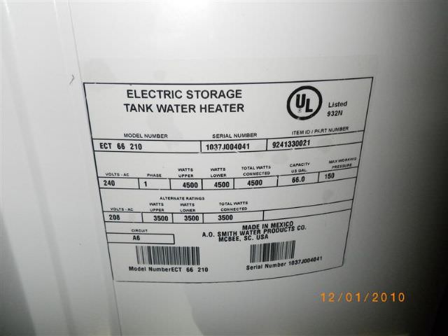

Robert Jones Posted December 2, 2010 Report Share Posted December 2, 2010 So today's inspection was a 1966 home, rambler with full/completed basement. The water that was coming out of the basement bathroom fixtures stunk horribly. My initial thought was the anodize rod in the electric water heater, but all of the other fixtures in the home did not have this odor. What else could it be? Also, anyone wanna take a stab at ageing this water heater? 2000? It is an A.O. Smith. I did look at the decoder, just didn't make sense for this one. Click to Enlarge 36.48 KB Link to comment Share on other sites More sharing options...

hausdok Posted December 2, 2010 Report Share Posted December 2, 2010 Hi Rob, I think that's a commercial tank number. If so, I believe that the month is the J and the two digits right behind it - 00 - represent the year - September of 2000. ONE TEAM - ONE FIGHT!!! Mike Link to comment Share on other sites More sharing options...

hausdok Posted December 2, 2010 Report Share Posted December 2, 2010 Strike that last. Seen the changes I added to the chart? They changed their dating method in 2008 when they bought State. Now the State plant is making most of their residential product and they are using State's numbering method. The first two digits are the year and the second two are the week. That's 37th week of 2010. https://www.inspectorsjournal.com/forum ... oto&id=131 ONE TEAM - ONE FIGHT!!! Mike Link to comment Share on other sites More sharing options...
John Kogel Posted December 2, 2010 Report Share Posted December 2, 2010 Strike that last. Seen the changes I added to the chart? They changed their dating method in 2008 when they bought State. Now the State plant is making most of their residential product and they are using State's numbering method. The first two digits are the year and the second two are the week. That's 37th week of 2010. https://www.inspectorsjournal.com/forum ... oto&id=131 ONE TEAM - ONE FIGHT!!! Mike Your chart says two digit year followed by two digit Month, not week. Is this a mistake? Link to comment Share on other sites More sharing options...
