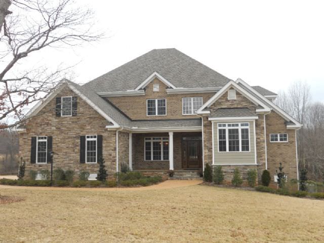

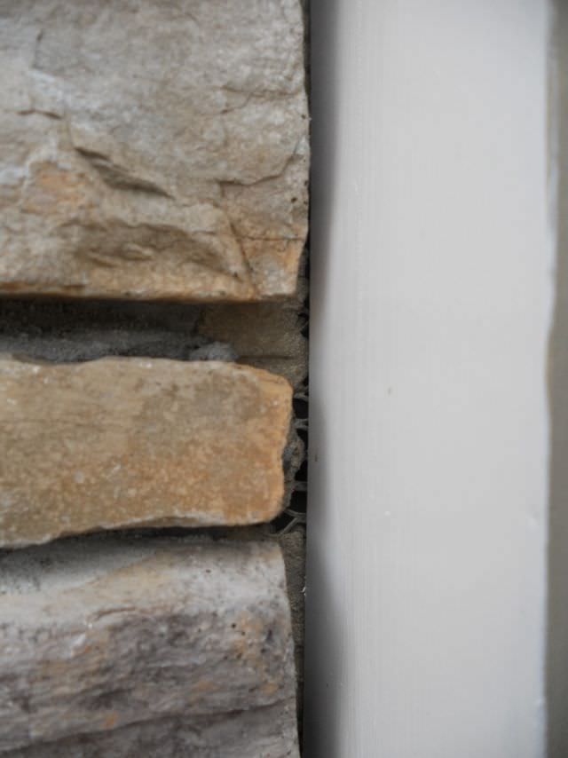

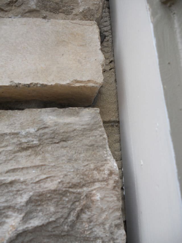

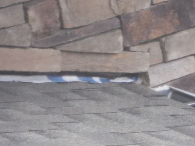

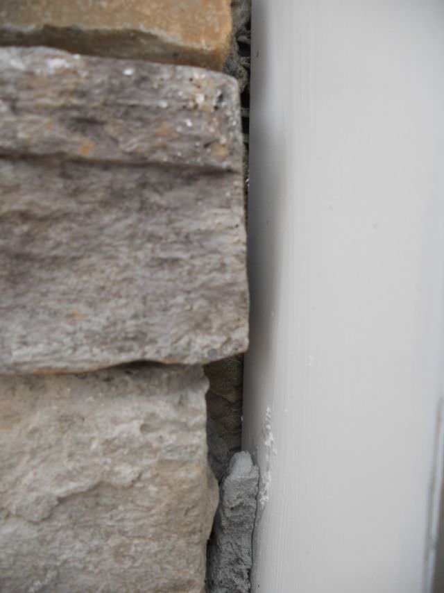

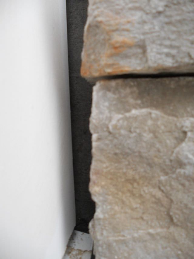

mgbinspect Posted February 5, 2011 Report Share Posted February 5, 2011 New Construction - foreclosure: I think I'll just refrain from expounding. The pics pretty much tell all in horrifying detail. I just told the buyer to consult with the largest and most reputable Synthetic stucco and stone installer in town. Be prepared to to spend a chunk based upon what the expert says and plenty in the future as well, because most of the damage can't be undone without tearing it all off and starting over. It's pretty from a distance though... Click to Enlarge 58.3 KB Click to Enlarge 48.77 KB Click to Enlarge 49.34 KB Click to Enlarge 63.58 KB Click to Enlarge 43.44 KB The photo above - that's good ole' 15 lb felt paper. Sigh.. that ought to be good for a season or two... Click to Enlarge 33.52 KB [:-sick] [:-banghea Quote Link to comment Share on other sites More sharing options...
