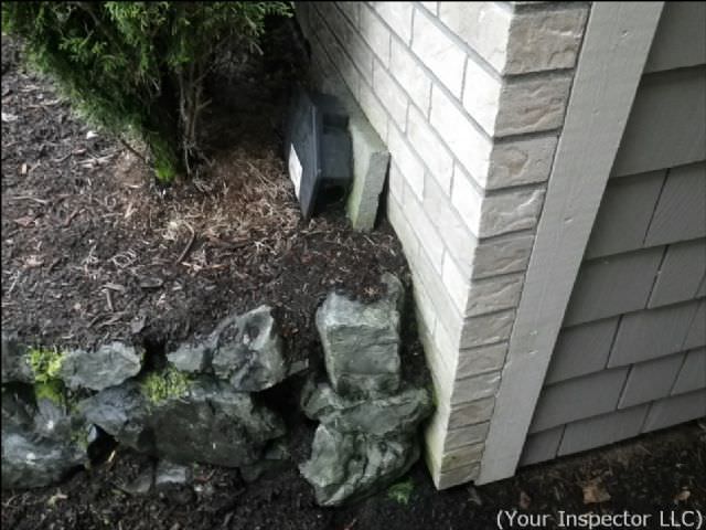

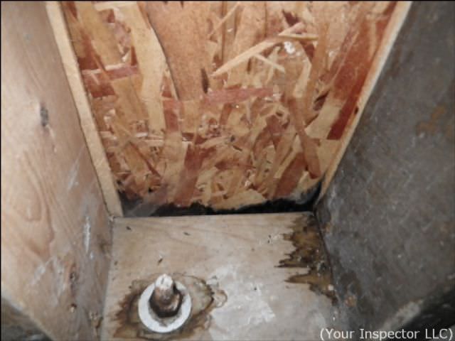

hausdok Posted February 6, 2011 Report Share Posted February 6, 2011 Here's damage from blocked weeps in veneer on the house I did yesterday. The one with the falling arches. They'd piled mulch against the bottom of the wall and water was basically trapped and backing up behind the veneer and then overflowed the flashings and caused the sheathing behind the veneer to rot all along the bottom. Click to Enlarge 64.2 KB Click to Enlarge 44.3 KB ONE TEAM - ONE FIGHT!!! Mike Quote Link to comment Share on other sites More sharing options...
