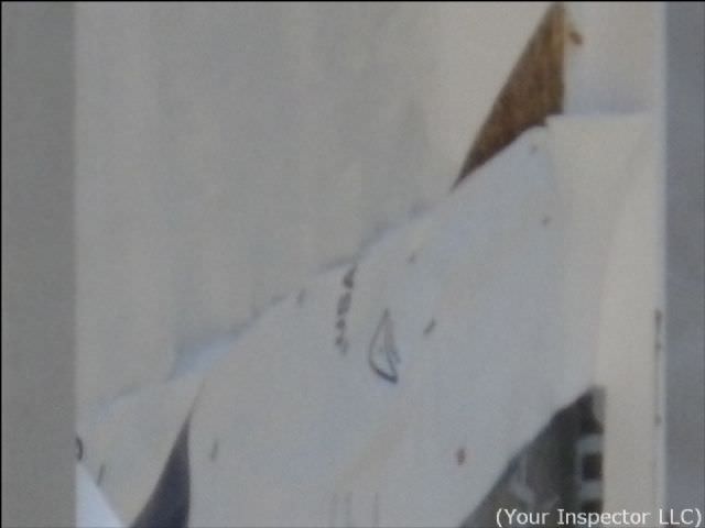

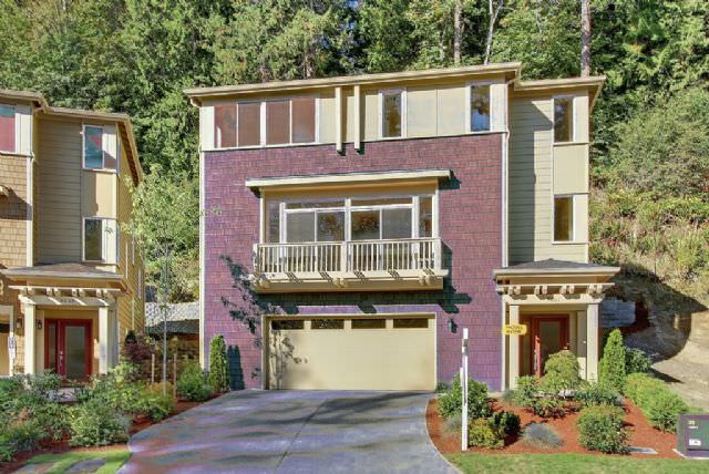

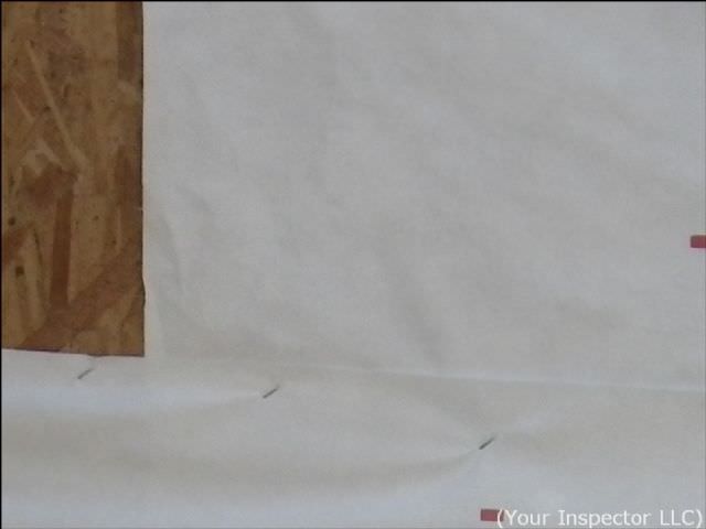

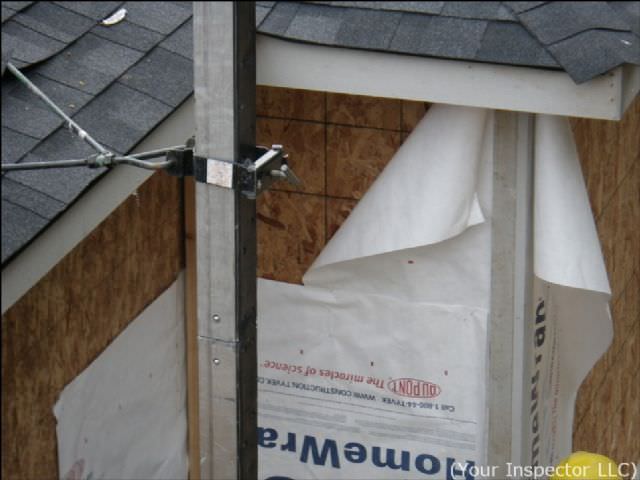

hausdok Posted April 21, 2011 Report Share Posted April 21, 2011 Did the house below yesterday. It was all buttoned up and the cliient's walk through with the builder is today. The siding contactor was installing the HardiPlank and cedar shingles next door. As I watched, they started applying wrap and by the time I was done had covered that wall. I discovered that they'd broken a whole lot of HardiPlank installation rules for penetrations over 1-1/2 inches. This installer just loves to caulk everything. The client wanted to know whether just cutting in flashings would keep things dry. What do you suppose I told him? Click to Enlarge 86.2 KB Click to Enlarge 22.39 KB Click to Enlarge 22.64 KB Click to Enlarge 43.89 KB ONE TEAM -ONE FIGHT!!! Mike Quote Link to comment Share on other sites More sharing options...
David Meiland Posted April 21, 2011 Report Share Posted April 21, 2011 Are you saying these guys are installing all the tyvek reverse-lapped? And what do you mean by penetrations over 1-1/2"? Quote Link to comment Share on other sites More sharing options...
Marc Posted April 21, 2011 Report Share Posted April 21, 2011 Did the house below yesterday. It was all buttoned up and the cliient's walk through with the builder is today. The siding contactor was installing the HardiPlank and cedar shingles next door. As I watched, they started applying wrap and by the time I was done had covered that wall. I discovered that they'd broken a whole lot of HardiPlank installation rules for penetrations over 1-1/2 inches. This installer just loves to caulk everything. The client wanted to know whether just cutting in flashings would keep things dry. What do you suppose I told him? ONE TEAM -ONE FIGHT!!! Mike No? Take it off and do it over, this time in compliance with the manufacturer's instructions? Marc Quote Link to comment Share on other sites More sharing options...

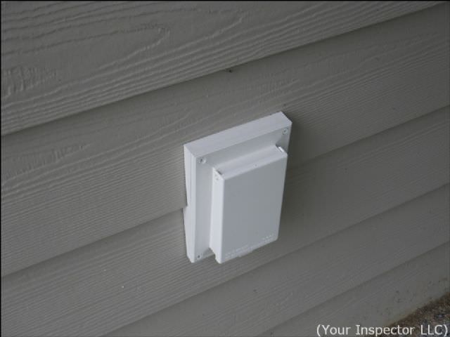

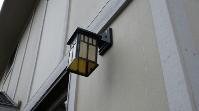

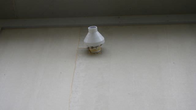

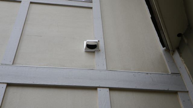

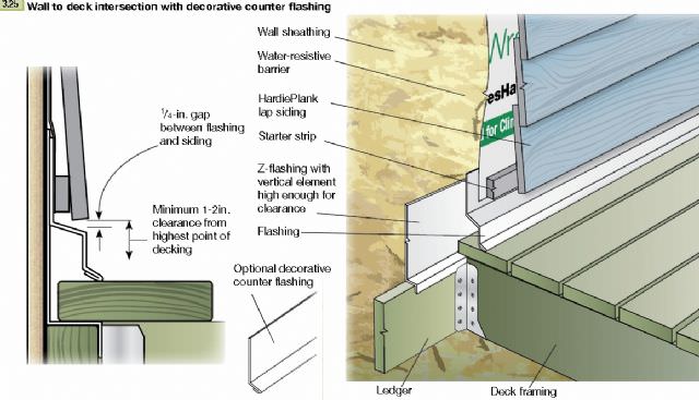

hausdok Posted April 21, 2011 Author Report Share Posted April 21, 2011 Are you saying these guys are installing all the tyvek reverse-lapped? And what do you mean by penetrations over 1-1/2"?Hi David, Yep, that's exactly what I'm saying and re. the penetrations and clearances I can give you some examples. JH wants blocking and then head flashings integrated into the wall system with a 1/4-inch gap above the flashings on everything that's larger than 1-1/2 inches that penetrates their product. So,.... This is right Click to Enlarge 24.69 KB This is not Click to Enlarge 36.03 KB This is right Click to Enlarge 53.54 KB This is not Click to Enlarge 26.89 KB This is right Click to Enlarge 46.22 KB This is not Click to Enlarge 29.69 KB JH doesn't want you securing the deck ledger to the house by trapping their product behind the ledger; so... This is right Click to Enlarge 41.4 KB or this Click to Enlarge 47.62 KB but not this Click to Enlarge 37.86 KB JH doesn't like to see concrete placed against their product or their product applied down to concrete; so,..... this is kewl Click to Enlarge 37.62 KB or this Click to Enlarge 44.13 KB but this is not... Click to Enlarge 48.2 KB JH wants proper kickout flashings and wants gutters to end 1-inch from sidewalls; so,.... This Click to Enlarge 33.95 KB not this... Click to Enlarge 66.51 KB ONE TEAM - ONE FIGHT!!! Mike Quote Link to comment Share on other sites More sharing options...

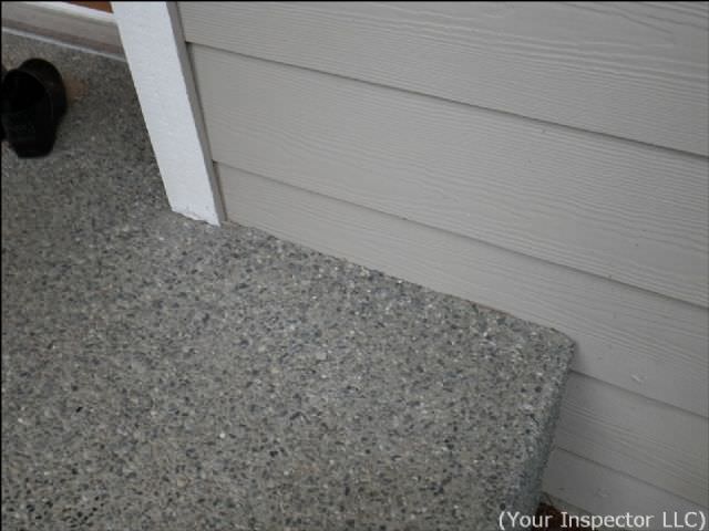

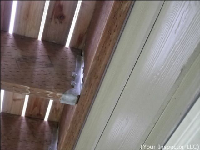

Ben H Posted April 21, 2011 Report Share Posted April 21, 2011 Was the concrete poured after the siding was installed? Quote Link to comment Share on other sites More sharing options...
ericwlewis Posted April 22, 2011 Report Share Posted April 22, 2011 " it's a new house, we don't need an inspector" Quote Link to comment Share on other sites More sharing options...
Ben H Posted April 22, 2011 Report Share Posted April 22, 2011 " it's a new house, we don't need an inspector" We need a like button. [:-paperba Quote Link to comment Share on other sites More sharing options...

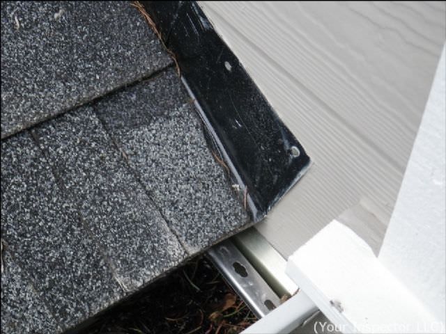

hausdok Posted April 22, 2011 Author Report Share Posted April 22, 2011 Was the concrete poured after the siding was installed? In that example it was; in this example, it was not. Click to Enlarge 46.97 KB It really doesn't matter when the concrete is placed. When they end up with that kind of a situation the builder should step up and remedy it. The most frustrating thing about yesterday's house is that HP has been used around here for over twenty years. Installers around here should know better than anyone how to install it correctly; yet I just keep finding more and more of this stuff. If I hadn't stood there and watched that contractor installing that wrap with a reverse lap, I would have felt comfortable telling the client that once the penetrations were done correctly the product would perform well. As it is, I told him it's a crapshoot, one he doesn't want to lose. He'll have to take it from here. ONE TEAM - ONE FIGHT!!! Mike Quote Link to comment Share on other sites More sharing options...

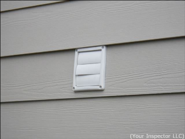

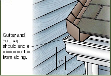

Brandon Whitmore Posted April 22, 2011 Report Share Posted April 22, 2011 Mike, Where can I find the Hardi(e) manual that shows the 1.5" recommendation/ rule? I like the details you posted, but don't recall seeing them on James Hardie's siding installation manual. At least not for the receptacle or fireplace vent. Quote Link to comment Share on other sites More sharing options...

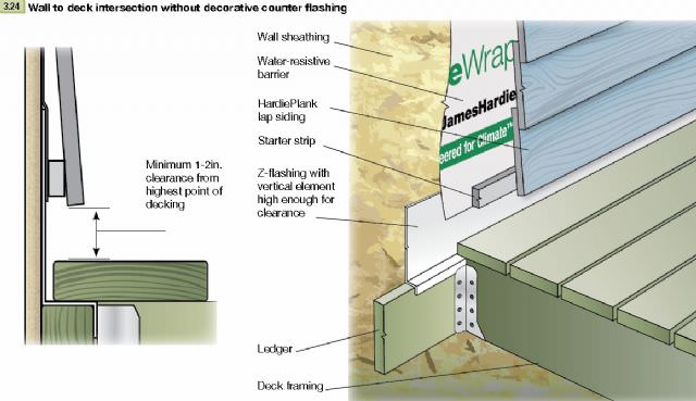

Jim Katen Posted April 22, 2011 Report Share Posted April 22, 2011 What does it mean, "Minimum 1-2" Clearance," and how is it different from, "Minimum 1" Clearance?" - Jim Katen, Oregon Quote Link to comment Share on other sites More sharing options...

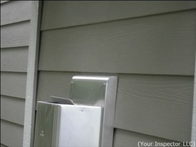

hausdok Posted April 22, 2011 Author Report Share Posted April 22, 2011 Mike, Where can I find the Hardi(e) manual that shows the 1.5" recommendation/ rule? I like the details you posted, but don't recall seeing them on James Hardie's siding installation manual. At least not for the receptacle or fireplace vent. In the James Hardie Hz10 Best Practices Installation Guide (I've underlined area for emphasis.) on Page 19 under General Installation Requirements - Penetrations, the guide shows specifically how penetrations should be detailed and states (I've underlined some areas for emphasis): "For penetrations in the building envelope such as hose bibs and holes 1-1/2" diameter or larger, such as dryer vents, a block of Hardie Trim 5/4, 4/4 boards should be installed around the point of penetration. To install a block around an existing vent pipe, it may be necessary to cut the block into two pieces. In this case, weather/cut the trim to fit it into place. Install flashings over the top of the trim block. Penetrations through a building envelope are made to accommodate needs such as hose bibs, dryer and furnace vents, electrical conduit, etc. It is important to restore the weather resistant barrier of the home after cutting a hole for the penetration." On page 20, the guide shows specifically how the combination intake/exhaust vent for a direct vent fireplace should be installed and states: "HOT AIR VENTS (Dryer, Stove, Furnace, Heater, Etc.) Any vent piping is required to have blocking and flashing at the penetration. A block of Hardie Trim 5/4, 4/4 boards should be installed around the point of penetration. The blocking should extend 3-4" along the wall from the edge of the vent. To install a block around an existing vent, it may be necessary to cut several blocks, with weather-cuts on each piece. Flashing must be installed over the top of the trim block." Also on page 20 it shows specifically how lights and electrical outlets should be installed and states: "LIGHTS AND ELECTRICAL OUTLETS Lights and electrical boxes should have the same flashing and blocking as other large penetrations such as vents. Many lights utilize square electrical boxes. Blocking a square object should still incorporate the best practices of an angled weather cut." Jim, I've always thought that was JH's way of throwing a bone to builders since the previous instructions had specified a minimum of 2-inches of clearance. I think it's their clumsy way of saying that they'd prefer two inches of clearance but won't bitch as long as there is at least an inch. ONE TEAM - ONE FIGHT!!! Mike Quote Link to comment Share on other sites More sharing options...
Brandon Whitmore Posted April 22, 2011 Report Share Posted April 22, 2011 Wow, thanks Mike. I'd glanced through the siding and housewrap guides prior to posting so I didn't have to ask. I guess it's time to re- read everything on website once again. I try to not study best practice guides too often; I don't want to write anything up if it is allowed according to the min. standards. In this case, it sounds like JH is requiring these details, but it's too bad they are written up in the best practice section. I can see an argument from a builder stating that these details are in fact not required, but best practice. I think I'll re- read their entire website, and then contact JH to ensure they'll back me on writing this stuff up. I'm fed up with citing manufacturers standards only to have them say that "oh yeah, that isn't actually required, just recommended". Any ideas on when they updated their guide to include these details? Quote Link to comment Share on other sites More sharing options...
