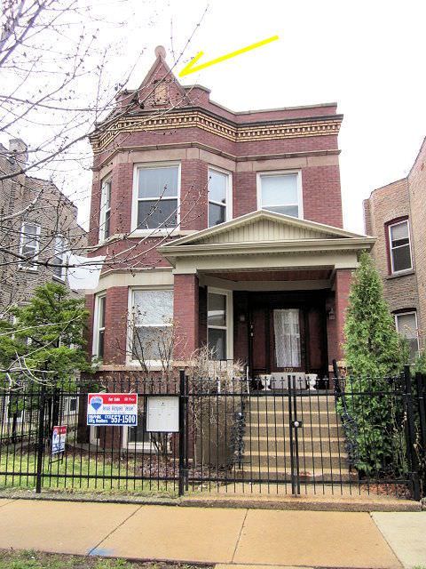

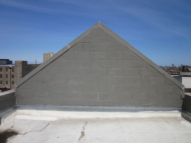

Mike Lamb Posted April 25, 2011 Report Share Posted April 25, 2011 What is the architectural name for this? Click to Enlarge 30.66 KB Click to Enlarge 65.33 KB Quote Link to comment Share on other sites More sharing options...
Inspectorjoe Posted April 25, 2011 Report Share Posted April 25, 2011 It's a pediment. Quote Link to comment Share on other sites More sharing options...
Richard Moore Posted April 25, 2011 Report Share Posted April 25, 2011 I would call it a "false front". That particular style may have its own name, but it's a false front nonetheless. Quote Link to comment Share on other sites More sharing options...
Mike Lamb Posted April 25, 2011 Author Report Share Posted April 25, 2011 Thanks. Quote Link to comment Share on other sites More sharing options...
kurt Posted April 25, 2011 Report Share Posted April 25, 2011 Joe's right. It's a pediment. From "Illustrated Architecture"....... "A pediment is a low-pitched triangular gable on the front of some buildings". Quote Link to comment Share on other sites More sharing options...
Inspectorjoe Posted April 25, 2011 Report Share Posted April 25, 2011 Actually, it's a false front pediment. Richard was right, too. Two heads are better than one! Quote Link to comment Share on other sites More sharing options...
Bill Kibbel Posted April 25, 2011 Report Share Posted April 25, 2011 It doesn't have the elements to be a pediment. It's a false-gable parapet wall. Quote Link to comment Share on other sites More sharing options...
Inspectorjoe Posted April 25, 2011 Report Share Posted April 25, 2011 Bill, what are the missing elements that prevent it from being considered a pediment? Quote Link to comment Share on other sites More sharing options...
kurt Posted April 25, 2011 Report Share Posted April 25, 2011 Yeah, it fulfills every requirement that I can find. It's a pediment, false front or not. In my reports, I call it a front gable parapet. Everyone seems to know what that means. More importantly, if there's a problem with it, which there always is, I have a picture of it with an arrow pointing at it. Quote Link to comment Share on other sites More sharing options...

Bill Kibbel Posted April 25, 2011 Report Share Posted April 25, 2011 Bill, what are the missing elements that prevent it from being considered a pediment? A pediment is not a triangle stuck onto a building. A pediment has projecting moldings of the cornice around the perimeter, resulting in a recessed area called a tympanum. The earliest had releif sculptures within the tympanum. The Greeks created the pediment. It was the decoration of the end of the roof at the gable-end of their buildings, which is the facade. The Romans took it and stuck it over doors, windows and niches. The Italians took a bite out of the peak - it's called a broken pediment. 17th century British architects stuck a finial in the gap of the broken pediment. Quote Link to comment Share on other sites More sharing options...

Jim Baird Posted April 25, 2011 Report Share Posted April 25, 2011 Kibbel is the closest here. I think the pointy part is nada more than part of the parapet, maybe call it a pointy-pet? Quote Link to comment Share on other sites More sharing options...
Jim Baird Posted April 25, 2011 Report Share Posted April 25, 2011 BTW I hope that thing has some rebar or something to stiffen it. The right puff of wind might make it a headache hazard. Quote Link to comment Share on other sites More sharing options...
mgbinspect Posted April 25, 2011 Report Share Posted April 25, 2011 BTW I hope that thing has some rebar or something to stiffen it. The right puff of wind might make it a headache hazard. Being 12" thick, I'd venture that it is brick backed with 8" block - core filled with rods and mortar. The brick and block will be tied together with duro-wall. I've laid up a few of those. Of course, now that I've posted this, it will probably topple and smash a car tomorrow... [:-wiltel] Quote Link to comment Share on other sites More sharing options...

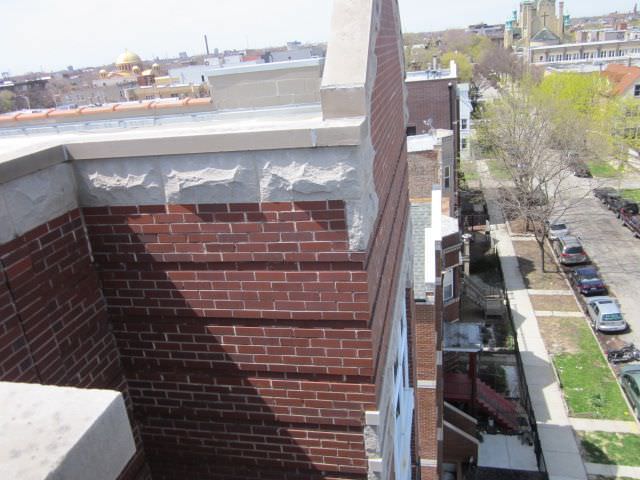

kurt Posted April 25, 2011 Report Share Posted April 25, 2011 Chicago is full of them. Here's one thing I know for sure........ If you wrap roofing up over the back of them, they condense so much moisture that the things freeze/thaw wildly and the frost heave causes them to lean outward over the sidewalk. Quote Link to comment Share on other sites More sharing options...
mgbinspect Posted April 25, 2011 Report Share Posted April 25, 2011 Chicago is full of them. Here's one thing I know for sure........ If you wrap roofing up over the back of them, they condense so much moisture that the things freeze/thaw wildly and the frost heave causes them to lean outward over the sidewalk. I gather that also causes greater than usual efflorescence, Yes? If memory serves, I don't remember ever dealing with an anchorage system for the cast coping, but it's awfully heavy. Two guys had a hard time gently easing it into place, so the wind would have a hard time budging it. Quote Link to comment Share on other sites More sharing options...
