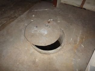

CHI Posted May 12, 2011 Report Share Posted May 12, 2011 I've got one here that I've never seen before. The home was built in 1959. This large 15-20' deep well was in the basement floor. It was approx. 3/4 full of water, but the basement was dry at the time. By the looks of the pipe coming out of the (very heavy) top, it appears a pump was once installed. I'm assuming ground water enters the well and is supposed to be pumped out??? The buyer is a bit concerned about standing water and mold growth. Any other thoughts on this and what should be done? I'm thinking a new pump, just not sure where he would pump it to. Thanks! Click to Enlarge 11.09 KB Quote Link to comment Share on other sites More sharing options...
Erby Posted May 12, 2011 Report Share Posted May 12, 2011 Do you really mean 15 - 20 FEET deep? Certainly not a typical sump setup. Quote Link to comment Share on other sites More sharing options...
Chad Fabry Posted May 12, 2011 Report Share Posted May 12, 2011 How far from the floor is the water level? Why didn't you show us a pic of how deep it is? If it's sump, fill it with gravel so it's only two feet deep and then install a pump. I bet it's more like a cistern/ well and they used it as a water source for watering the lawn or what ever. I don't think I've ever seen ground water with mold issues. The well in the pic is in a crawl- it's been out of service for close to a hundred years. Click to Enlarge 79.55 KB Quote Link to comment Share on other sites More sharing options...
fyrmnk Posted May 12, 2011 Report Share Posted May 12, 2011 Sounds like a cistern to me as well. Quote Link to comment Share on other sites More sharing options...
Tom Raymond Posted May 12, 2011 Report Share Posted May 12, 2011 How far from the floor is the water level? Why didn't you show us a pic of how deep it is? If it's sump, fill it with gravel so it's only two feet deep and then install a pump. I bet it's more like a cistern/ well and they used it as a water source for watering the lawn or what ever. I don't think I've ever seen ground water with mold issues. The well in the pic is in a crawl- it's been out of service for close to a hundred years. Click to Enlarge 79.55 KB Lemme guess, they switched to muni water[:-banghea I have a well similar to that in my yard. I'm very tempted to hook it back up, considering I spend as much on filters as I do on the mud delivered by the water dept. Quote Link to comment Share on other sites More sharing options...

CHI Posted May 12, 2011 Author Report Share Posted May 12, 2011 Thanks for the thoughts. You've pretty much confirmed my suspicions . I took several pictures but the water is approximately 5' from the top and all I could get was a reflection of the water. The concern is that the sellers mentioned there has been water in the basement in the past. They claimed they had fixed the issue, however there was still moisture wicking around the base of the foundation wall and the basement had been recently painted hmmm.. Thanks for the insight! Quote Link to comment Share on other sites More sharing options...
