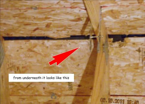

rkenney Posted June 17, 2011 Report Share Posted June 17, 2011 Could someone please identify this for me. These town homes are about 10 yrs old. Most of the adjacent homes (but not all) have this on their roof. The 1st picture is not real clear, but basically it just looks like a folded piece of strap metal as revealed by the attic photo. Does this have a purpose? Click to Enlarge 18.23 KB Click to Enlarge 31.22 KB Quote Link to comment Share on other sites More sharing options...
Ken Meyer Posted June 17, 2011 Report Share Posted June 17, 2011 It's a roof anchor, to attach safety lines. It's connected to the roof framing. Quote Link to comment Share on other sites More sharing options...
hausdok Posted June 18, 2011 Report Share Posted June 18, 2011 Yep, When you see those, make sure there is a cover on them. If they are left exposed to the weather the boot around the base will eventually degrade from UV/ozone and start to leak. When that happens, the framing inside gets wet and eventually rots. Find 'em rotting every once in a while. ONE TEAM - ONE FIGHT!!! Mike Quote Link to comment Share on other sites More sharing options...
Jim Katen Posted June 18, 2011 Report Share Posted June 18, 2011 What the others said. The one in your picture is a brand called "Super Anchor." They're a nice feature. Quote Link to comment Share on other sites More sharing options...
Greg Booth Posted June 18, 2011 Report Share Posted June 18, 2011 It may just be that the camera-flash is overwhelming daylight through the ridge vent........but, is the roofing-felt cut out at the ridge peak? ......Greg Quote Link to comment Share on other sites More sharing options...

Jim Katen Posted June 18, 2011 Report Share Posted June 18, 2011 I was just reading the Super Anchor installation instructions and I see that the anchor in Bob's photo is installed incorrectly. When you install these on a truss with a 2x4 top chord, such as this one, you're supposed to install a 2x4x24" piece of blocking under the chord. Without that blocking, the Super Anchor could shatter the truss chord if someone were to fall and stress the anchor. http://www.superanchor.com/pdfs/sancmanl.pdf Check out the requirements on figures 10 & 13 and see the possible failure scenario in figure 16. Quote Link to comment Share on other sites More sharing options...
