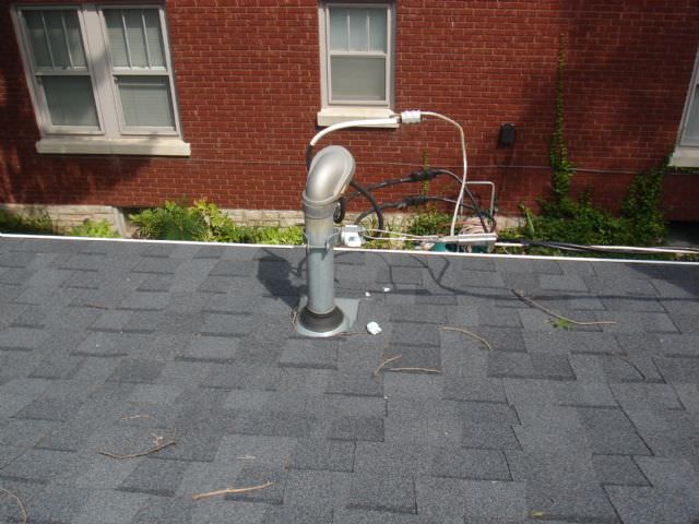

Bain Posted September 17, 2011 Report Share Posted September 17, 2011 I was cleaning my gutters earlier and saw this. Apparently a tree limb fell on the SE cables and cracked the ceramic bushing. The utility company is going to repair the anchor, but while I THINK I understand all the ramifications, I'm curious about what the gurus have to say. As an oh-by-the-way, I realize the masthead is too close to the shingles, but the installation was inspected and approved before I bought the house, and I haven't wanted to spend the dough to make corrections. Yet. Click to Enlarge 61.63 KB Quote Link to comment Share on other sites More sharing options...

Jim Katen Posted September 17, 2011 Report Share Posted September 17, 2011 I don't recall seeing connectors like that in my area. What does the piece of ceramic do? It doesn't look like it insulates the neutral from the mast. Quote Link to comment Share on other sites More sharing options...

Bain Posted September 17, 2011 Author Report Share Posted September 17, 2011 I don't recall seeing connectors like that in my area. What does the piece of ceramic do? It doesn't look like it insulates the neutral from the mast. It was circular, and it WAS intended to insulate the neutral from the mast. The half circle that broke off is on the roof. That's what I was curious about. Now that the neutral's in contact with the mast, what are the possible consequences? Quote Link to comment Share on other sites More sharing options...
Jim Katen Posted September 17, 2011 Report Share Posted September 17, 2011 A certain proportion of the imbalanced neutral current from your 120-volt circuits will be flowing over the mast. Quote Link to comment Share on other sites More sharing options...
Bain Posted September 17, 2011 Author Report Share Posted September 17, 2011 The utility guy came and went. He said some power companies never insulate the neutral from the mast, but mine does. The only danger with my kind of insulator, he said, is some companies use inexpensive anchors in which the pins aren't flared well, and the pins fail when they take a hit. I didn't think it was a big deal when I saw it, but I didn't know if there was a possible problem I wasn't aware of. Click to Enlarge 48.15 KB Quote Link to comment Share on other sites More sharing options...
Jim Katen Posted September 17, 2011 Report Share Posted September 17, 2011 The utility guy came and went. He said some power companies never insulate the neutral from the mast, but mine does. The only danger with my kind of insulator, he said, is some companies use inexpensive anchors in which the pins aren't flared well, and the pins fail when they take a hit. I didn't think it was a big deal when I saw it, but I didn't know if there was a possible problem I wasn't aware of. Click to Enlarge 48.15 KB They don't use those things around here, but the little loop of wire that holds the neutral in place is dipped in plastic by way of insulation. I can't imagine that it's very effective. Quote Link to comment Share on other sites More sharing options...

Jim Port Posted September 19, 2011 Report Share Posted September 19, 2011 The neutral should have been bonded to the mast already. Quote Link to comment Share on other sites More sharing options...
Bain Posted September 19, 2011 Author Report Share Posted September 19, 2011 The neutral should have been bonded to the mast already. Can you tell us why? It's never done that way in my area. Quote Link to comment Share on other sites More sharing options...

Jim Port Posted September 19, 2011 Report Share Posted September 19, 2011 The neutral should have been bonded to the mast already. Can you tell us why? It's never done that way in my area. If the mast were not bonded to the neutral and it became energized it would not have tripped the breaker. It would also become a shock hazard were someone to complete the circuit. Quote Link to comment Share on other sites More sharing options...

Douglas Hansen Posted September 20, 2011 Report Share Posted September 20, 2011 Originally posted by Jim Port The neutral should have been bonded to the mast already. Can you tell us why? It's never done that way in my area. The neutral must always be bonded to that mast. The place where you typically see that bonding connection is in the service equipment, and any additional bonding at the point of attachment should only be adding to what was already present. Using an insulator at the mast may provide a more reliable or durable connection from a mechanical standpoint, but not electrically. Suppose that inside the mast the insulation on a hot conductor is damaged and that it energizes the conduit. The path for current is from the conduit to the enclosure of the service equipment, across the main bonding jumper, and over to the incoming service neutral. There is no breaker in that circuit - it is on the "line" side of the service equipment. A fault as described here is going to cause something pretty bad - it could possibly cause a fire or blow up the utility transformer. If you were lucky it would trip the overcurrent protection on the primary of the transformer and just knock out power to all the customers served by it. Suppose we have the exact same thing, only this time there is no main bonding jumper in the service panel. Now nothing blows up. Instead, something much worse happens. The conduit sits there with 120-volts potential, waiting for you to touch it while also contacting a grounded surface. You become a human bonding jumper. If the service mast had been anchored with metal to metal contact instead of that insulator, we are back to plan "A" (a noticeable fire or explosion instead of a potential electrocution). The reason we require bonding jumpers around concentric knockouts on the line side of the service is to assure that we are using plan "A" rather than the human bonding jumper. Quote Link to comment Share on other sites More sharing options...

Bain Posted September 20, 2011 Author Report Share Posted September 20, 2011 Originally posted by Jim Port The neutral should have been bonded to the mast already. Can you tell us why? It's never done that way in my area. The neutral must always be bonded to that mast. The place where you typically see that bonding connection is in the service equipment, and any additional bonding at the point of attachment should only be adding to what was already present. Using an insulator at the mast may provide a more reliable or durable connection from a mechanical standpoint, but not electrically. Suppose that inside the mast the insulation on a hot conductor is damaged and that it energizes the conduit. The path for current is from the conduit to the enclosure of the service equipment, across the main bonding jumper, and over to the incoming service neutral. There is no breaker in that circuit - it is on the "line" side of the service equipment. A fault as described here is going to cause something pretty bad - it could possibly cause a fire or blow up the utility transformer. If you were lucky it would trip the overcurrent protection on the primary of the transformer and just knock out power to all the customers served by it. Suppose we have the exact same thing, only this time there is no main bonding jumper in the service panel. Now nothing blows up. Instead, something much worse happens. The conduit sits there with 120-volts potential, waiting for you to touch it while also contacting a grounded surface. You become a human bonding jumper. If the service mast had been anchored with metal to metal contact instead of that insulator, we are back to plan "A" (a noticeable fire or explosion instead of a potential electrocution). The reason we require bonding jumpers around concentric knockouts on the line side of the service is to assure that we are using plan "A" rather than the human bonding jumper. Thank you. Quote Link to comment Share on other sites More sharing options...
Garet Posted September 20, 2011 Report Share Posted September 20, 2011 If the service mast had been anchored with metal to metal contact instead of that insulator, we are back to plan "A" (a noticeable fire or explosion instead of a potential electrocution). Wouldn't that cause the service mast to act as a parallel conductor to the neutral? That seems like a bad idea. No? If not, then why the insulator? Quote Link to comment Share on other sites More sharing options...
Douglas Hansen Posted September 21, 2011 Report Share Posted September 21, 2011 If the service mast had been anchored with metal to metal contact instead of that insulator, we are back to plan "A" (a noticeable fire or explosion instead of a potential electrocution). Wouldn't that cause the service mast to act as a parallel conductor to the neutral? That seems like a bad idea. No? If not, then why the insulator? It would cause the service mast to act in parallel with the neutral. I don't see that as a bad idea. It would have current on it. It would have only barely measurable voltage. The NEC allows the neutral to be a bare (copper) conductor inside that service riser (230.41Exc.1). A bare neutral would also allow current on the service riser. We've already seen what happens in a fault situation with the bonding jumper missing. So, let's look at what happens in a no-fault situation: Suppose you have 2AWG aluminum service conductors and service drop conductors. To give us some measurable voltage on them, let's say the service drop is 100 feet back to the transformer, and that we have 10 feet of 2-inch steel conduit between the service equipment and the weatherhead. Next let's assume a really huge imbalanced load, like maybe 60 amps, which is more than you would ever see in real life. The voltage drop on the service conductors would be approximately 2 volts (60 amps times 0.0319 ohms). In the first 10 feet of that, the voltage drop would be 0.2 volts. That would be your maximum theoretical voltage potential between the service neutral and the mast at the top. In practice it would be much much less. There isn't a need to insulate it to try to maintain voltage potential between them. Again, I think the insulator is someone's idea of a mechanically more reliable connection. In the same vein, the service enclosure also carries a small amount of current, yet if everything is connected right it is safe for you to touch it. It and the grounding electrode conductor are in parallel with the service neutral. Jerry Simon has taken many pictures of his ammeter clamped around the grounding electrode conductor and showing fairly high amperages. Those grounding electrode conductors can show that kind of current while still having barely measurable voltage. Same story here at the weatherhead. Quote Link to comment Share on other sites More sharing options...
