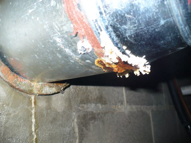

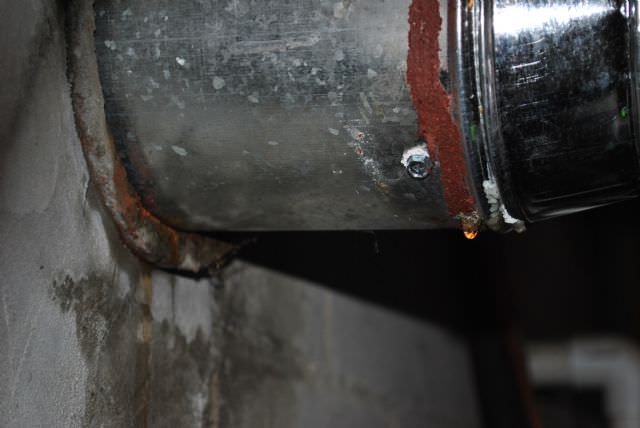

dalmat36 Posted January 6, 2012 Report Share Posted January 6, 2012 I recently had my oil furnace and ductwork replaced in my home after my existing furnace malfunctioned and filled the entire house full of white smoke. I am concerned because my flue seems to have white corrosive growth and water coming out of the seams of the metal and on the inside of the flue. I have attache photos showing the corrosion after approx 2 1/2 weeks of use. I had my chimney cleaned by a local chimney sweeping company and expressed concern of the corrosive growth and they don't seem to think this is a big thing to worry about however I am a little skeptical after ready a few articles online. I was told my chimney does not have a metal liner but rather is made of clay. If I am looking at a potential problem in the near future I would like to have this fixed immediately rather than waiting until damage is done. Am I over worrying about the water and corrosion or should I find a different contractor? Quote Link to comment Share on other sites More sharing options...

Bill Kibbel Posted January 6, 2012 Report Share Posted January 6, 2012 Pictures usually don't appear because of spaces in the file name. The white deposits are probably from condensation. It's a sign that combustion byproducts are cooling in the vent connector or in the vertical chimney flue too soon. It can be from a number of reasons. One possibility is that the new furnace output is cooler than the previous, requiring a smaller chimney flue so that the exhaust rises to the top of the chimney before cooling. Quote Link to comment Share on other sites More sharing options...
Bill Kibbel Posted January 6, 2012 Report Share Posted January 6, 2012 Now that the pics are posted, is that vent connector increased in diameter, just before entering the chimney thimble? Quote Link to comment Share on other sites More sharing options...
dalmat36 Posted January 6, 2012 Author Report Share Posted January 6, 2012 Pictures usually don't appear because of spaces in the file name. The white deposits are probably from condensation. It's a sign that combustion byproducts are cooling in the vent connector or in the vertical chimney flue too soon. It can be from a number of reasons. One possibility is that the new furnace output is cooler than the previous, requiring a smaller chimney flue so that the exhaust rises to the top of the chimney before cooling. The furnace I had installed was rated at 85% efficient oil furnace as compared to the older one which was 78%. Quote Link to comment Share on other sites More sharing options...
dalmat36 Posted January 6, 2012 Author Report Share Posted January 6, 2012 Pictures usually don't appear because of spaces in the file name. The white deposits are probably from condensation. It's a sign that combustion byproducts are cooling in the vent connector or in the vertical chimney flue too soon. It can be from a number of reasons. One possibility is that the new furnace output is cooler than the previous, requiring a smaller chimney flue so that the exhaust rises to the top of the chimney before cooling. Yes, I measured the flue pipe prior to the transition piece to be 5" dia. and the metal piece in chimney is 6.1" dia. Quote Link to comment Share on other sites More sharing options...
Jim Katen Posted January 6, 2012 Report Share Posted January 6, 2012 Pictures usually don't appear because of spaces in the file name. The white deposits are probably from condensation. It's a sign that combustion byproducts are cooling in the vent connector or in the vertical chimney flue too soon. It can be from a number of reasons. One possibility is that the new furnace output is cooler than the previous, requiring a smaller chimney flue so that the exhaust rises to the top of the chimney before cooling. Another possibility is that the furnace is too large. The resulting short cycles don't allow the flue to fully warm. Quote Link to comment Share on other sites More sharing options...
dalmat36 Posted January 6, 2012 Author Report Share Posted January 6, 2012 What would you guys suggest I do? Quote Link to comment Share on other sites More sharing options...
Tom Corrigan Posted January 6, 2012 Report Share Posted January 6, 2012 I'll bet that: 1. not only is the furnace more efficient but, the firing rate is less. 2. the chimney is located on the exterior of the building. As has been stated, condensation is occurring inside the flue. The flue will need to be made smaller and easier to heat. This will involve the installation of a properly sized stainless steel liner inside the masonry chimney. As Jim Katen mentioned, make sure that the furnace is not short cycling. Tom Corrigan, Ret. Quote Link to comment Share on other sites More sharing options...

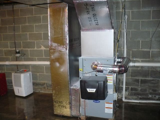

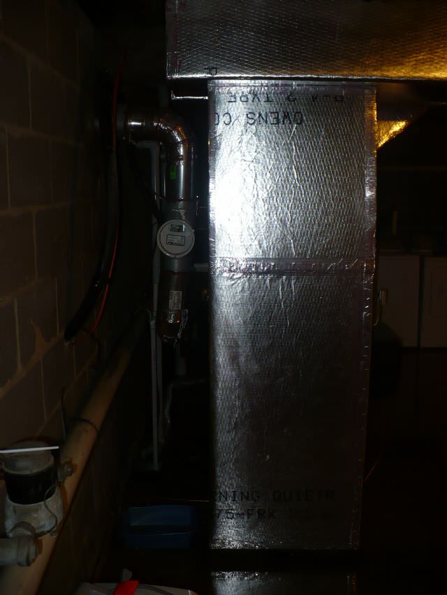

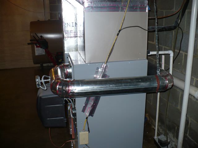

plummen Posted January 6, 2012 Report Share Posted January 6, 2012 How about a picture of the rest of the install,including where flue attaches to furnace?[:-magnify Quote Link to comment Share on other sites More sharing options...
dalmat36 Posted January 7, 2012 Author Report Share Posted January 7, 2012 How about a picture of the rest of the install,including where flue attaches to furnace?[:-magnify Here are some more photos showing the rest of the furnace and flue Click to Enlarge 48.2 KB Click to Enlarge 40.18 KB Click to Enlarge 82 KB Click to Enlarge 64.52 KB Quote Link to comment Share on other sites More sharing options...
Bill Kibbel Posted January 7, 2012 Report Share Posted January 7, 2012 The vent connector is very long with several elbows. Combine that with the increase in it's dimension, prior to the termination at the vertical chimney flue, is likely the primary cause of the condensation. (Do the horizontal sections slope the right way?) They probably put the sealant and tape on the joints of the vent connector because combustion byproducts, having already cooled before rising up the chimney, were spilling out. A properly installed natural-draft vent system needs nothing added to the joints and nothing leaks out. Quote Link to comment Share on other sites More sharing options...
plummen Posted January 7, 2012 Report Share Posted January 7, 2012 The vent connector is very long with several elbows. Combine that with the increase in it's dimension, prior to the termination at the vertical chimney flue, is likely the primary cause of the condensation. (Do the horizontal sections slope the right way?) They probably put the sealant and tape on the joints of the vent connector because combustion byproducts, having already cooled before rising up the chimney, were spilling out. A properly installed natural-draft vent system needs nothing added to the joints and nothing leaks out. Here I go agreeing with the home inspector again! [:-bonc01] The first piece of pipe after the 90 coming out of the furnace is running down hill,then it looks like its running flat to the next 90. Then it must start climbing at some point to hit the chimney going out. Why didnt they take and spin the furnace 90 degrees when they installed it to atleast cut down on the offsets?[:-weepn] With that many offsets its no wonder they needed that big of a flue pipe to vent it,but by the time it reaches the chimney im suprised it has enough force behind it to properly vent! [] And as far as the aluminum tape on the flue pipe it must be to keep all the condensation from dripping out of all the joints in that flat/reversed sloping pipe! [:-yuck] Quote Link to comment Share on other sites More sharing options...
Tom Corrigan Posted January 7, 2012 Report Share Posted January 7, 2012 Here I go agreeing with a contractor but, Note also that the minimum required clearance between the single wall smoke pipe and the plastic condensate drain, the plastic plumbing waste pipe and (if the code guy is on his game) the combustible refrigerant tube insulation is required to be at least 18"! You will need to install a type L smoke pipe and/or change to non-combustible pipes and insulation. Tom Corrigan Quote Link to comment Share on other sites More sharing options...

Neal Lewis Posted January 8, 2012 Report Share Posted January 8, 2012 Note also that the minimum required clearance between the single wall smoke pipe and the plastic condensate drain, the plastic plumbing waste pipe and (if the code guy is on his game) the combustible refrigerant tube insulation is required to be at least 18"! Tom Corrigan Some newer oil fired units have a requirement for only 9 inches clearance from the single wall flue pipe. Quote Link to comment Share on other sites More sharing options...
beal73 Posted January 11, 2012 Report Share Posted January 11, 2012 Why does the floor appear wet? Quote Link to comment Share on other sites More sharing options...
plummen Posted January 11, 2012 Report Share Posted January 11, 2012 Probably all the water leaking past the red rtv hes got slopped all over the joints on the single wall fittings! [:-yuck] Quote Link to comment Share on other sites More sharing options...
HVACMASTER Posted March 15, 2012 Report Share Posted March 15, 2012 First things first guys, this is an oil furnace which requires tuning to set the air fuel mix and dial in the stack temp to ensure condensation doesnt occur in chimney. The first thing that should be done is a combustion analisys by an oil tech and make sure the burner is set up properly. Oil is not like a gas unit ( plug and play) it must be tuned up annually. One can make many adjustments from O2 levels, oil pressure, and oil flow rate, all of which affect stack temps therefore the potential for condensation. I wont touch an oil burner without performing combustion analisys. Or could be rain water infiltration Install notes; the exhaust/ flue piping MUST always have a positive pitch, yours does not and this is a major concern! around here its against code to add sealant or tape to metal flue piping as its not needed therefore is used to conceal a problem.. Get a good oil tech out to inspect/correct installation. Quote Link to comment Share on other sites More sharing options...
