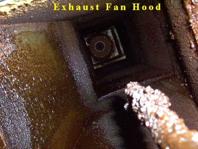

Mike Lamb Posted January 29, 2012 Report Share Posted January 29, 2012 It's OK to have a fan on the roof; that's how every commercial hood is set up. But, it's gotta be a fan rated for the purpose. I've mixed and matched components with range hoods before. If someone wants to get worked up because now it's not listed by the mfg., oh well......it's really not a big deal. It's a hood, ductwork, and a fan. I happen to have access to commercial equipment, so we mix stuff up all the time. But, if someone does something as moronic as the hood in the pic, that's different. Who knows what the heck else they did. I was not implying there is something wrong with roof top fans. But the owner/operator better know what they have on their hands. Kitchen fires are a big deal and this buyer isn't likely to know what the hell is going on. I'd get worked up over mixing and matching here. I did an inspection of a restaurant not long ago. The owner (my client) was leasing the property to a very large, well known franchised burger chain that I will not name and he was very unhappy with how his tenant was keeping his equipment maintained. Click to Enlarge 69.39 KB Click to Enlarge 68.1 KB Quote Link to comment Share on other sites More sharing options...
kurt Posted January 29, 2012 Report Share Posted January 29, 2012 Like I said, it's gotta be rated for the purpose. After that, they pretty much all are a mess. I've never been on a Chicago restaurant roof that wasn't a freakshow mess. Quote Link to comment Share on other sites More sharing options...
