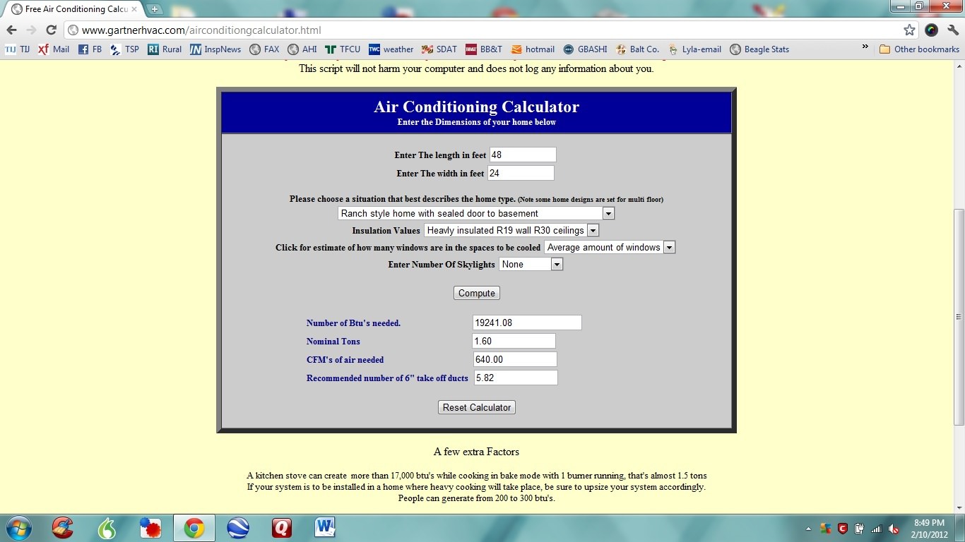

John Dirks Jr Posted February 11, 2012 Author Report Share Posted February 11, 2012 Here's a calc for the AC. 2 ton is more than enough. Download Attachment: AC-calc.jpg 193.54 KB BTW, how efficient do you think the 50 year old Mueller Climatrol is? 50-60% maybe? It has never struggled to keep up even on the coldest days. If its 60% and listed at 120k then that comes out to 72k actual usable heat for the living space. We never even came close to struggling with it on the coldest day. So, if a new Lennox 90% efficient is listed at 70k, that would come out to 63k usable. I bet that would do it. It might be a tad under sized in the coldest weather but that's not frequent. Even then, new and more efficient windows could be coming soon too. So based on my experience of living for and extended time with what I have now, the way my house acts and what my family needs to feel comfortable, that too can help me decide what I need as good as any calculator, can't it? I'll go look up some heat calcs now. Link to comment Share on other sites More sharing options...

John Dirks Jr Posted February 11, 2012 Author Report Share Posted February 11, 2012 This might explain why my current furnace cycles, even in the coldest weather. This quicky calc includes the zip code too so I suppose it gives a value to the average climate in my area. This and all the other reading I've done says 70k is more than enough. Even a two stage on low speed would keep up. Download Attachment: heatcalc.jpg 301.93 KB Link to comment Share on other sites More sharing options...
