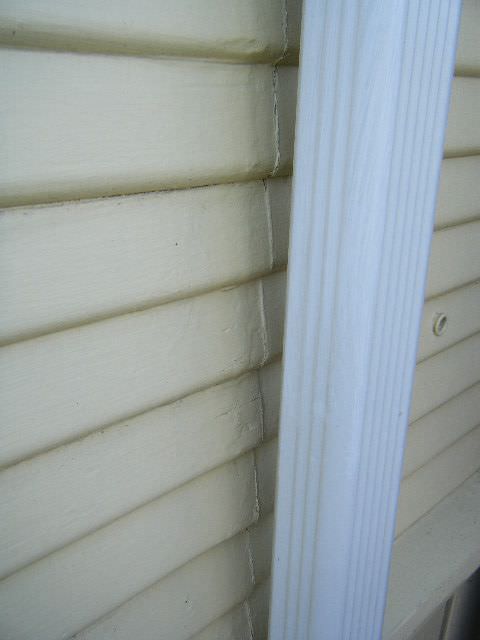

Denray Posted February 29, 2012 Report Share Posted February 29, 2012 They put exterior ventilation into this addition with these extra small vents then painted them, which reduced their capacity a lot. Click to Enlarge 30.34 KB Click to Enlarge 45.39 KB Click to Enlarge 26.18 KB Quote Link to comment Share on other sites More sharing options...
hausdok Posted February 29, 2012 Report Share Posted February 29, 2012 They didn't intent to put in "Exterior Ventilation" - they retrofitted the home with blown-in insulation. It's possible that they used UFFI in the exterior walls and the slits in these caps helped the UFFI off-gas and cure more quickly, but I don't think the intent is to ventilate the walls. If the intent were to "ventilate" the walls why wouldn't we have it in every wall of every home? We see retrofits of blown-in a lot here. Many times the plugs are solid and when you poke your finger behind you find cellulose. Many times the plugs are slitted like those and you poke your finger in there and you find UFFI. Sometimes you find the ventilated caps used for both types - sometimes the solid caps are used for both types. You are correct, painting the slits in the caps reduces their "ventilation" ability, but it doesn't seem to make any difference in building performance unless water is actually getting into the wall and it usually isn't getting in through those. ONE TEAM - ONE FIGHT!!! Mike Quote Link to comment Share on other sites More sharing options...
Bill Kibbel Posted February 29, 2012 Report Share Posted February 29, 2012 I've never seen those vents as an indication of added insulation. They're typically installed in areas where the paint persistently blisters, due to vapor getting trapped behind the paint "skin". The vapor doesn't have to be from water entering the wall. These are usually older homes without any type of vapor barrier. Subsequent repainting always results in the vents becoming blocked. A simple metal wedge at the bottom edges of siding panels can be quite effective and not as likely to be completely blocked with paint. From http://www.buildingscience.com/document ... enclosures Quote Link to comment Share on other sites More sharing options...

John Kogel Posted February 29, 2012 Report Share Posted February 29, 2012 I've seen them used to fill holes in stucco after blowing chopped cellulose insulation in. So I don't think the hole plugs themselves give much of a clue as to what was done, but it is a good guess that insulation was blown in, IMO. Quote Link to comment Share on other sites More sharing options...
leeboy Posted March 1, 2012 Report Share Posted March 1, 2012 Same concept as siding nails with round heads, allowing wood to dry by letting air flow behind the siding Quote Link to comment Share on other sites More sharing options...
hausdok Posted March 1, 2012 Report Share Posted March 1, 2012 I've never seen those vents as an indication of added insulation. They're typically installed in areas where the paint persistently blisters, due to vapor getting trapped behind the paint "skin". The vapor doesn't have to be from water entering the wall. These are usually older homes without any type of vapor barrier. Subsequent repainting always results in the vents becoming blocked. A simple metal wedge at the bottom edges of siding panels can be quite effective and not as likely to be completely blocked with paint. From http://www.buildingscience.com/document ... enclosures Agreed, but not here. I used to see siding wedges all the time back east but I've never seen then here and never seen a need for them here. ONE TEAM - ONE FIGHT!!! Mike Quote Link to comment Share on other sites More sharing options...
Jim Katen Posted March 1, 2012 Report Share Posted March 1, 2012 I've never seen those vents as an indication of added insulation. They're typically installed in areas where the paint persistently blisters, due to vapor getting trapped behind the paint "skin". The vapor doesn't have to be from water entering the wall. These are usually older homes without any type of vapor barrier. Subsequent repainting always results in the vents becoming blocked. A simple metal wedge at the bottom edges of siding panels can be quite effective and not as likely to be completely blocked with paint. Agreed, but not here. I used to see siding wedges all the time back east but I've never seen then here and never seen a need for them here. That's interesting. We have lots of houses with blistering paint issues. Every winter, I see several where I can poke a hole in the water-filled blisters and have water pour out from behind the paint. You don't see that in your area? Quote Link to comment Share on other sites More sharing options...
