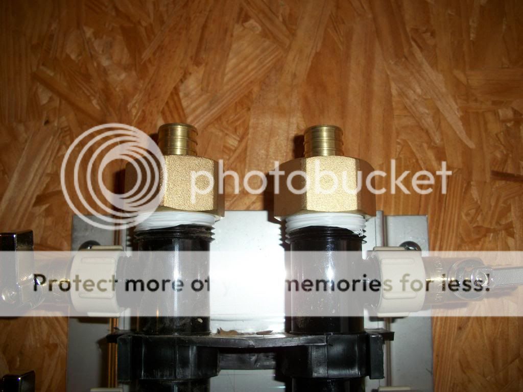

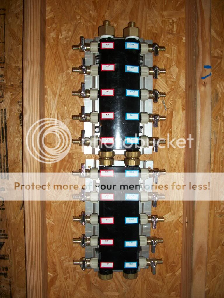

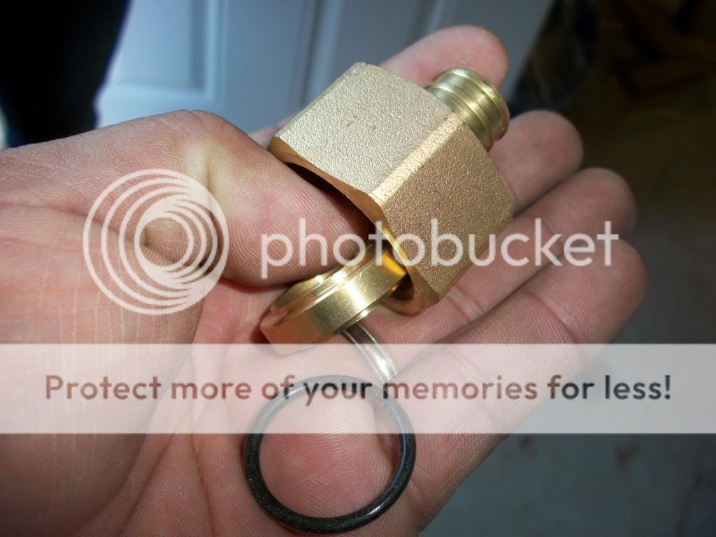

JosephVelder Posted December 3, 2012 Report Share Posted December 3, 2012 I'm in the process of installing PEX plumbing in a new construction house. I just mounted the manifold (Apollo brand) but I can't figure out how a couple of the fittings connect. this is the manifold; this are the fittings in question; This is the ONE o-ring that came with the manifold, which side does it go on? the manifold side or the PEX hose side of the fitting? It doesn't quite fit on the brass insert, it doesn't stay put on it. Or is the o-ring optional? Is there an o-ring missing? Link to comment Share on other sites More sharing options...
Marc Posted December 3, 2012 Report Share Posted December 3, 2012 That looks like an exterior wall you have that manifold installed within. It should be in the attic or some other location where you can get to it if you need to. Joseph, are you building this whole house yourself? When I visited the City of West Monroe website, I got the impression that there was very little code enforcement in place in this town. Lots of towns like that in La. The state is being lax in pushing for uniform code enforcement. Marc Link to comment Share on other sites More sharing options...
Nolan Kienitz Posted December 3, 2012 Report Share Posted December 3, 2012 Attached is the installation sheet from the Apollo PEX website. Does not appear that you have enough space on the sides for adequate connection of the PEX pipe ... Turns are to be "gradual". Location between those studs will end up with "sharp" turns unless you plan on extra connections to put in right angle turns, but then that would increase odds of leaks with many more connections/crimps. Download Attachment: Apollo-PEX-Installation_A9R1CB0.pdf 665.07?KB . Link to comment Share on other sites More sharing options...
hausdok Posted December 3, 2012 Report Share Posted December 3, 2012 Hi, Yeah, the first thing I thought when I saw the photo - not enough space. We're inspectors. We don't see those taken apart. One of might swag a guess about the placement of that O-ring and screw it up. You're on the net. You can find the installation instructions on the net as quickly as one of us can. Go for it! ONE TEAM - ONE FIGHT!!! Mike Link to comment Share on other sites More sharing options...

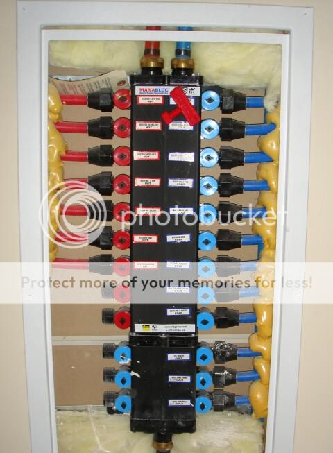

JosephVelder Posted December 3, 2012 Author Report Share Posted December 3, 2012 Marc, yes, I am building the entire house myself [:-wiltel] I did pay someone to do the slab and the plumbing in the slab, other than that it's been all me...and yes it is an exterior wall, I plan on building a box around the manifold like this guy did; with a nice, cabinet style door for it. I haven't had any dealings with the inspectors in West Monroe yet but I haven't heard any horror stories yet so...[:-thumbu] Mike, I have been looking all over online about those fittings, I usually do that before I come to you guys. Maybe I can call Apollo and ask them? Mike, Nolan (thanks for the Apollo PDF), Concerning the radius of the hoses, I plan on drilling the studs and going through them with the hoses so the radius will be very gradual. Like this guy did; I'll post pictures as I go along to make sure I'm not making any mistakes along the way. Link to comment Share on other sites More sharing options...

Nolan Kienitz Posted December 4, 2012 Report Share Posted December 4, 2012 JV - I like those sweeps and the access, but consider "down the road" if there is a failure and you have to replace a line. Make sure you don't have to re-invent the wall should you have to have access. Not that you ever want to or hope to, but I'm just retentive about 'planning ahead' for (as Jim L. commented: You don't know what you don't know). Being on an exterior wall I would do everything I could about wrapping each of those supply lines with an insulation wrap. Sort of similar to what is on an A/C refrigerant line. Even thought you are "South" and in LA ... we are similarly "South" in the Dallas area, but they still wrap each of the PEX distribution lines with the insulation sleeves. Just better to safe than sorry and when it is open it is far easier to do it now. . Link to comment Share on other sites More sharing options...
Scottpat Posted December 4, 2012 Report Share Posted December 4, 2012 I think drilling through the studs to provide a nice arc for the PEX as it connects to the manifold is just fine. This is also a very common method to support the PEX and provide a gradual bend in the line so the fittings are not stressed. I would not worry about unknown down the road repairs; really not any different than a copper line in a wall needing to be repaired. I would have a concern with the manifold being on the outside wall and it being subject to freezing. I know that you are in West Monroe LA, but Y'all still get some freezing temps from time to time. Link to comment Share on other sites More sharing options...
