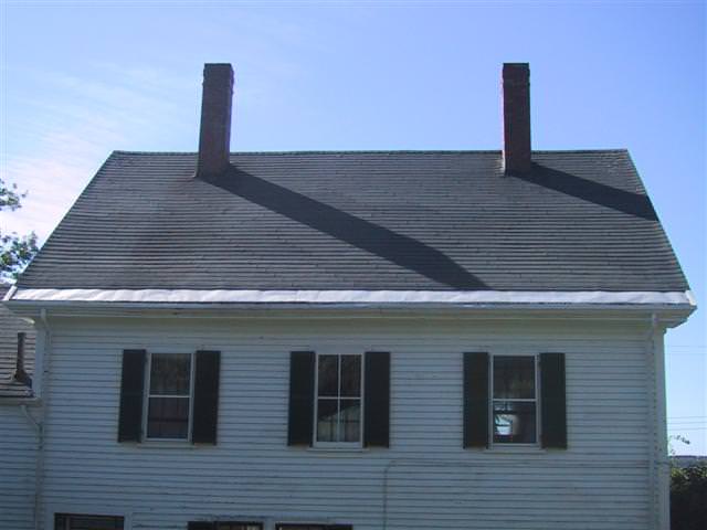

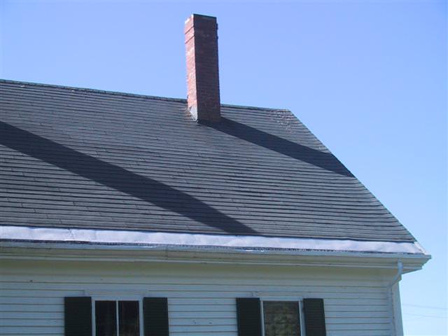

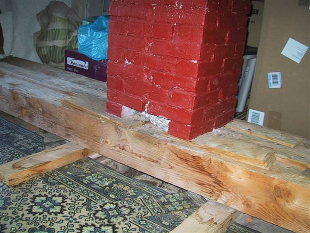

holmer Posted August 5, 2005 Report Share Posted August 5, 2005 I know that there is a lot going on in this picture but the subject in question is the chimney on the right. Download Attachment: Denisechimneyext1.jpg 41.93 KB Download Attachment: Denisechimneyext2.jpg 40.57 KB The next two photos are taken of the chimney viewed from the attic. The home was built around 1870 or so. Current owner has no idea when the modification was made. All the fireplaces below have been removed as well as the partition walls to make bigger rooms on both the first and second floor. Download Attachment: Denisechimneyattic3.jpg 36.99 KB Download Attachment: Denisechimneyattic4.jpg 68.17 KB Do any of you folks out there see this kind of thing very often? Link to comment Share on other sites More sharing options...
David C. Argabright Posted August 5, 2005 Report Share Posted August 5, 2005 I saw a one room school that was built around 1840 with a suspended chimney in the center. The difference is that it was made for a free standing stove to attach to and provide heat in the building. It had a simple beam system on each side to hold the weight of the masonry. Metal bars and under-carriage transferred the weight onto the beams above the ceiling. It was still a very solid structure after all these years. Sorry I can't locate the photos. What you have pictured appears to serve no purpose other than to hold the top of a now useless chimney. Are the tops of the chimneys open and allow water entry? Did they plan on building a new firebox and using the old chimneys? Do they have clay flue liners or exposed brick? If I saw them I'd recommend they be removed. Then they could do a little something with the upper area. Link to comment Share on other sites More sharing options...
Steven Hockstein Posted August 5, 2005 Report Share Posted August 5, 2005 Is it possible that the home is in an historic district and changing the exterior is not permitted? Or maybe the owner felt that the exterior balance of the two chimneys was an important element that needed to be maintained. Link to comment Share on other sites More sharing options...
Bill Kibbel Posted August 5, 2005 Report Share Posted August 5, 2005 Do any of you folks out there see this kind of thing very often? Eric, I come across it pretty regularly. It's usually an interior renovation that takes out most of the chimney. They usually don't want to remove the exterior portion as it would break the symmetry, or they're waiting for the next re-roof. The "temporary" structures added to support them are rarely adequate. Link to comment Share on other sites More sharing options...
Chad Fabry Posted August 5, 2005 Report Share Posted August 5, 2005 My house had three chimneys supported the way Bill's pic shows. My wife had a tantrum when I told her they were the reason the dining room floor was three inches out of level. I used the bricks to build a nice garden wall, but she still wasn't happy. I have to admit, the house looked better with them, but they were death to the structure. Link to comment Share on other sites More sharing options...
Jim Baird Posted August 5, 2005 Report Share Posted August 5, 2005 Have seen similar "support" "systems" from time to time, though usually not as stout. Time was when kitchens had these little masonry flue columns that served a "Franklin" woodstove. My grandmother had one in her kitchen. She didn't cook on it, but she loved to stoke it up just for the cheer and warmth. When it got hot she might put a black skillet on it to fry up little corn meal "Johnny cakes". Have seen several "remodeled" kitchens where the column was removed below the ceiling and the upper column "supported" by angle iron screwed to the ceiling joists. Usually the sag in the ceiling is quite noticeable. The remodeler was thereby relieved of the rest of the chimbley removal and consequent roof repair. Link to comment Share on other sites More sharing options...
