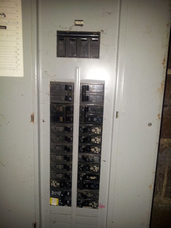

Mike Lamb Posted November 3, 2013 Report Share Posted November 3, 2013 Got a picture of your main electrical panel? Curious. Quote Link to comment Share on other sites More sharing options...

awfarmington Posted November 3, 2013 Author Report Share Posted November 3, 2013 Got a picture of your main electrical panel? Curious. Yes, I do Click to Enlarge 51.35 KB Click to Enlarge 49.63 KB Quote Link to comment Share on other sites More sharing options...
Marc Posted November 3, 2013 Report Share Posted November 3, 2013 It a common occurrence. Main panel is updated but the antique wiring is left alone. It makes fast money for the electrician but leaves electrical hazards for the homeowner. Marc Quote Link to comment Share on other sites More sharing options...
awfarmington Posted November 3, 2013 Author Report Share Posted November 3, 2013 They did that, and also added 4 gfci outlets above the kitchen counter before we bought the house. Then my father in law added wiring for a dishwasher. Which may or may not be jerry rigged. That's about it for updated wiring. Quote Link to comment Share on other sites More sharing options...
