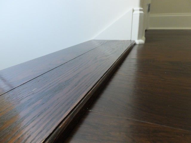

JPLomeo Posted September 4, 2014 Report Share Posted September 4, 2014 Just say this yesterday on my inspection where the owner-builder laminated the stairway too. I'm calling it a potential trip Hazard but can't find anything against this in the IRC? Any suggestions appreciated. Thanks Click to Enlarge 33.03 KB Quote Link to comment Share on other sites More sharing options...
Jim Baird Posted September 4, 2014 Report Share Posted September 4, 2014 I have never seen such as this. How high is it? Are these treads nosed? Quote Link to comment Share on other sites More sharing options...
Jerry Lozier Posted September 4, 2014 Report Share Posted September 4, 2014 Whether it is a code violation or not, they are paying for your opinion. It can be a trip hazard without being IRC violation. My comment would be if I felt it was unsafe: "Raised trim on stairway steps is a potential trip hazard. For your families and guests enhanced safety recommend a qualified professional remove the trim so this hazard no longer exists" Quote Link to comment Share on other sites More sharing options...

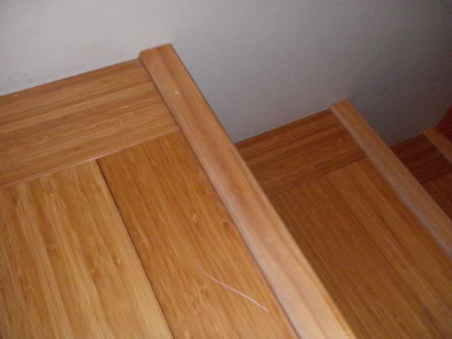

Marc Posted September 4, 2014 Report Share Posted September 4, 2014 Had one on a new construction last week. Click to Enlarge 32.51 KB He put the tread on top of the floor finish. It's a long way down. Marc Quote Link to comment Share on other sites More sharing options...
Steven Hockstein Posted September 4, 2014 Report Share Posted September 4, 2014 Just say this yesterday on my inspection where the owner-builder laminated the stairway too. I'm calling it a potential trip Hazard but can't find anything against this in the IRC? Any suggestions appreciated. Thanks Click to Enlarge 33.03 KB Not to be picky (but this comment is -[:-bigeyes- sorry). I suggest you remove the word potential. I would just call it a trip hazard. Aren't all trip hazards "Potential" ? I see this a lot when the stair treads are designed for hardwood and the adjacent floors are carpeted or covered with vinyl tiles. Quote Link to comment Share on other sites More sharing options...
JPLomeo Posted September 4, 2014 Author Report Share Posted September 4, 2014 Thanks guys, I agree that trip hazard is always potential, and wether it's in the code books or not does not matter- it not right and is unsafe-period Thanks JP Quote Link to comment Share on other sites More sharing options...
Mike Lamb Posted September 4, 2014 Report Share Posted September 4, 2014 Take a look at ASTM F 1637. This is what attorneys will review in a lawsuit. I had some communication with Doug Hansen a couple years ago about trip hazards and building standards. His reply to my inquiries about uneven/raised walking surfaces: "Basically what the standard says is that the maximum deviation is 1/2 inch, and that any deviation over 1/4 inch has to be beveled." This may also be applicable to your situation: ASTM, F1637-95, 6.1.2; F1637-07, 7.1.2 - Step nosings shall be readily discernible, slip resistant, and adequately demarcated. Random, pictorial, floral, or geometric designs are examples that can camouflage a step nosing. I would consider that nosing to be camouflaged. Quote Link to comment Share on other sites More sharing options...

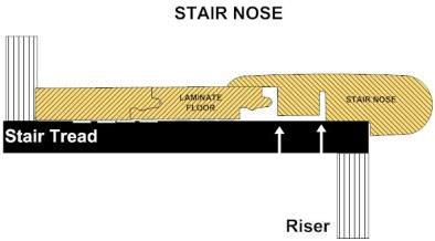

Garry Sorrells Posted September 6, 2014 Report Share Posted September 6, 2014 LP, Was the riser flush to the tread and a transition strip added? Did the tread extend past the riser by 3/4"? Was the tread material a laminate or was it solid (such as BRUCE Flooring)? I ask because of what looks like a micro grove in picture. Either way it's wrong...either in design or application. Click to Enlarge 21.17 KB Quote Link to comment Share on other sites More sharing options...

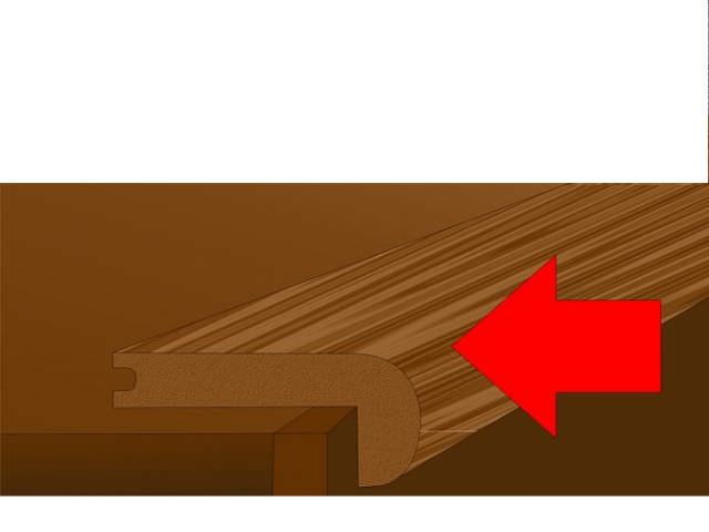

Garry Sorrells Posted September 6, 2014 Report Share Posted September 6, 2014 A little something to look at:[:-magnify http://www.armstrong.com/pdbupimages/2127188114.pdf Look at pg 390, 391 and 392 9. DO NOT USE THE STEP NOSE ON INDIVIDUAL STAIR TREADS. K. FLUSH STAIR NOSE INSTALLATION FOR STAIR TREADS AND RISERS IMPORTANT SAFETY NOTICE: The installation of laminate flooring on stairs is a fully adhered system. Under no circumstances should foam underlayment be placed on stair steps or risers. This will result in an unsafe condition. Do not use over-the-top step nose moulding on individual stair treads. Quote Link to comment Share on other sites More sharing options...
Garry Sorrells Posted September 7, 2014 Report Share Posted September 7, 2014 Thought I saw installation instructions that may have been used. Despite Installation Instructions it will boil down to an argument over opinion and design. You will have to choose between personal opinion and manufacture installation instructions. Should the occasion arise. http://www.homedepot.com/catalog/pdfIma ... 2360af.pdf Page 8 Click to Enlarge 12.78 KB Quote Link to comment Share on other sites More sharing options...
