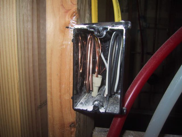

John Kogel Posted December 3, 2014 Report Share Posted December 3, 2014 I have never seen a pigtailed installation; everything is in series/feed through. Is pigtailing common elsewhere? Nice machine, btw...... Here for the wiring rough-in inspection, the muni inspector wants to see all the boxes wired with wire nuts in place and two pigtails sticking out. If that passes, the receptacles go in. No small wonder back-stabbing takes place at that stage. It certainly simplifies the electrical inspection. The wire nuts have proven to be satisfactory, except yes sometimes a wire pops out and you lose power. Pigtails allow for easy replacement of receptacles, cheap 'upgrade' for a house flipper. Quote Link to comment Share on other sites More sharing options...
Jack Davenport Posted December 7, 2014 Report Share Posted December 7, 2014 Originally posted by kurt I have never seen a pigtailed installation; everything is in series/feed through. Is pigtailing common elsewhere? Nice machine, btw...... Here for the wiring rough-in inspection, the muni inspector wants to see all the boxes wired with wire nuts in place and two pigtails sticking out. If that passes, the receptacles go in. No small wonder back-stabbing takes place at that stage. It certainly simplifies the electrical inspection. The wire nuts have proven to be satisfactory, except yes sometimes a wire pops out and you lose power. Pigtails allow for easy replacement of receptacles, cheap 'upgrade' for a house flipper. [/quote Out of curiosity - Is that by chance a Canadian code thing ? There is no such requirement in the NEC ( other than neutrals on a multi-wire circuit) Then there is the good ole fashioned Local amendment thing. Quote Link to comment Share on other sites More sharing options...
Jim Katen Posted December 7, 2014 Report Share Posted December 7, 2014 Here for the wiring rough-in inspection, the muni inspector wants to see all the boxes wired with wire nuts in place and two pigtails sticking out. If that passes, the receptacles go in. No small wonder back-stabbing takes place at that stage. It certainly simplifies the electrical inspection. The wire nuts have proven to be satisfactory, except yes sometimes a wire pops out and you lose power. Pigtails allow for easy replacement of receptacles, cheap 'upgrade' for a house flipper. It's basically the same here. However, if you wanted to wire through the receptacles, you could just leave those wires sticking out. There's no requirement to use wire nuts as opposed to the lugs on the receptacle, but if there are going to be wire nuts, then the inspectors like to see them in place. Examples attached. Click to Enlarge 43.3 KB Click to Enlarge 46.18 KB Quote Link to comment Share on other sites More sharing options...
