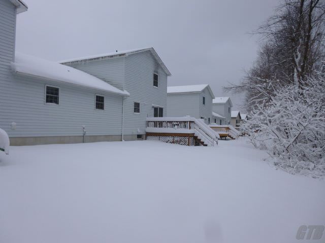

gtblum Posted December 15, 2014 Report Share Posted December 15, 2014 A row of townhomes built in 94. The staining is over the top of bedroom windows that face west, without any treeline obstruction to sunlight. Any ideas? Click to Enlarge 36.41 KB Click to Enlarge 46.26 KB Click to Enlarge 32.94 KB Quote Link to comment Share on other sites More sharing options...

Tom Raymond Posted December 15, 2014 Report Share Posted December 15, 2014 Cheap ass windows, no insulation at the headers, no insulation in the RO. It's the same ghosting phenomenon that happens on the inside at missing insulation and thermal bridges. Quote Link to comment Share on other sites More sharing options...

Garry Sorrells Posted December 16, 2014 Report Share Posted December 16, 2014 2nd fl window. Window in bathroom? Bathroom vented? Is there a heating register below window? Would also question insulation at header. Side of house also looks like staining. Might look to sump pump location as a cause. Or HVAC duct work location as cause. Then insulation again. Quote Link to comment Share on other sites More sharing options...
David Meiland Posted December 16, 2014 Report Share Posted December 16, 2014 Air leakage out/around the window. Quote Link to comment Share on other sites More sharing options...

Tom Raymond Posted December 16, 2014 Report Share Posted December 16, 2014 Conditioned air. It carries water vapor out that then condenses on the cold siding, dust and dirt stick to that before it freezes. It is directly above the windows because the leak is at the RO or between the sash and head jamb, or both. Quote Link to comment Share on other sites More sharing options...

Tom Raymond Posted December 16, 2014 Report Share Posted December 16, 2014 It's just like ghosting that occurs on the inside of the building. It can vary based on any one of hundreds of variables. I would think that all the openings have some degree of this. I'd have to see it first hand, and possibly open it up, to see why it's worse on the west side. Quote Link to comment Share on other sites More sharing options...
gtblum Posted December 16, 2014 Author Report Share Posted December 16, 2014 Never seen it in my climate. Why only on the west sides? Why would trees obstructing the sun prevent this from happening? Jim, Not preventing it, promoting what looks like the fungal growth typically seen on the north side of a wall, due to the lack of sunlight. Why only on the west side of all of these places is what I'd like to know, too? Because of exposure to the afternoon Sun? Quote Link to comment Share on other sites More sharing options...
Les Posted December 16, 2014 Report Share Posted December 16, 2014 Building orientation on site. Residual heat from sun for west side. Most weather in my area and that area is from south and west. I can sit in the street and watch hoary frost move around these houses. We also see the stain as green on occasion and really black when the building is in wide open fields that have lots of palaces and no trees. The same ghosting is common for us on nearly all vinyl siding. Especially that siding that is directly on foam and no tyvek. Quote Link to comment Share on other sites More sharing options...

David Meiland Posted December 17, 2014 Report Share Posted December 17, 2014 Why only on the west sides? I bet it has more to do with those being bedrooms than it does with the windows facing west. Bedrooms are often small, heavily occupied rooms. It could also be the case that those rooms have supply registers but no returns, leading them to be slightly pressurized when the doors are closed and the heat's on, causing exfiltration. Quote Link to comment Share on other sites More sharing options...

Marc Posted December 17, 2014 Report Share Posted December 17, 2014 Folks sleeping in bedrooms with the door closed makes those bedrooms sources of humidity. Compounded with no sunlight at night time to warm the siding and leaky window installations and you have is a 'perfect storm' for that sort of result. Marc Quote Link to comment Share on other sites More sharing options...
