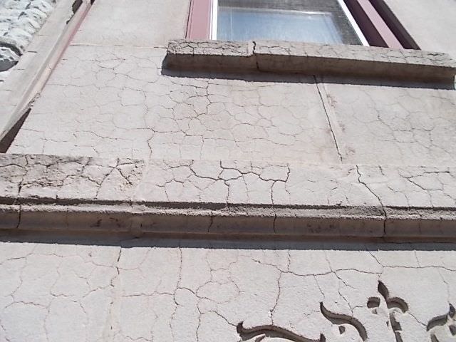

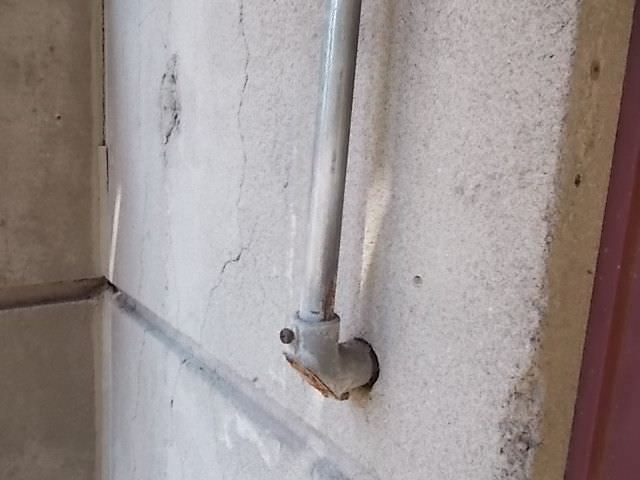

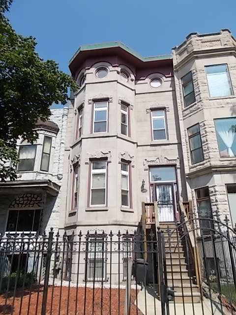

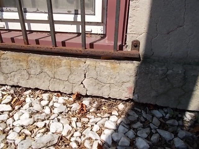

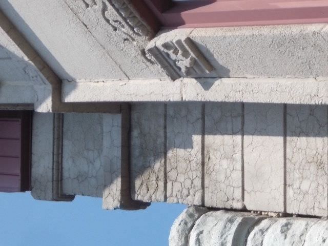

Mike Lamb Posted July 26, 2015 Report Share Posted July 26, 2015 The front of this 100 year old bldg. has bad spider cracking everywhere. There has been very little patching of cracks. None of it has fallen out and even the badly cracked window sills did not feel loose. I want to recommend repair but grouting would probably accelerate its ruin. I also don't know if my client should buy into this. It is not a cheap buy. Opinions? Click to Enlarge 77.08 KB Click to Enlarge 61.97 KB Click to Enlarge 62.08 KB Click to Enlarge 55.89 KB Click to Enlarge 60.82 KB Quote Link to comment Share on other sites More sharing options...
Mike Lamb Posted July 26, 2015 Author Report Share Posted July 26, 2015 Right now I'm writing the front has advanced deterioration and needs major repair. Quote Link to comment Share on other sites More sharing options...
kurt Posted July 26, 2015 Report Share Posted July 26, 2015 It looks like there's some sort of skim coat on the limestone. Is there a cementitious type "paint" on this thing? Quote Link to comment Share on other sites More sharing options...
kurt Posted July 26, 2015 Report Share Posted July 26, 2015 A close up of that last pic doesn't look like limestone. It looks like a cast cement material. How old is this thing? There are cast cement decorative elements on some teens and a lot of 1920's buildings. The more I look at it, the more I think it's not limestone. Got any super close ups? With real limestone, you can see the remains of old sea shells and organic materials turned to stone. This stuff looks cast. Quote Link to comment Share on other sites More sharing options...

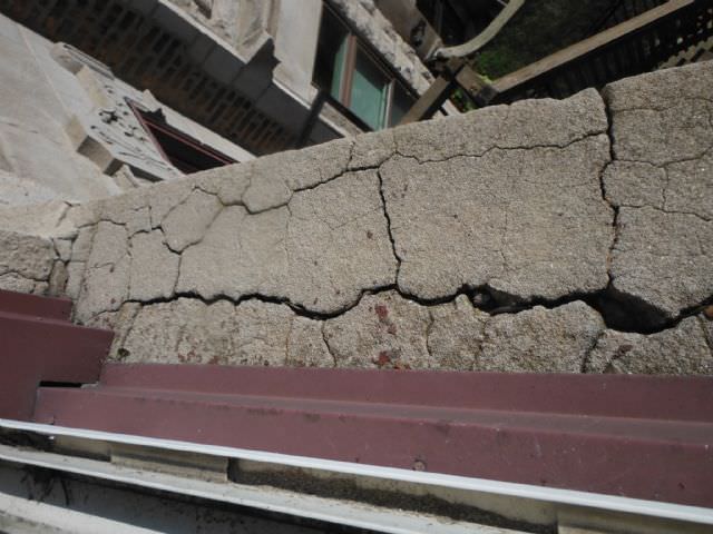

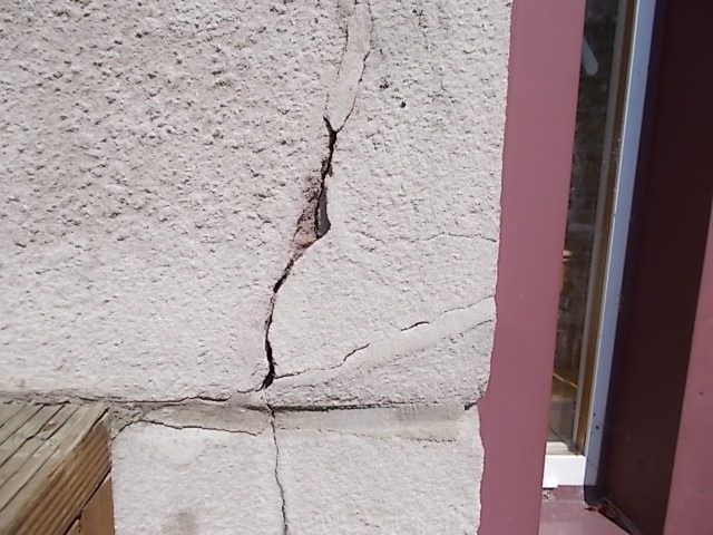

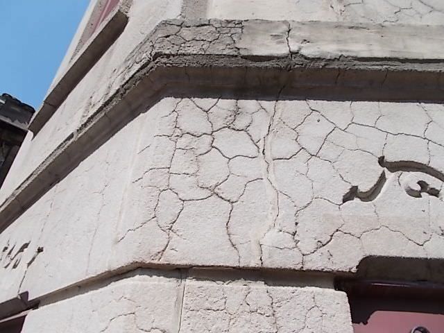

Mike Lamb Posted July 26, 2015 Author Report Share Posted July 26, 2015 I don't know age for sure. I guess turn of the century. Would the material matter considering the condition? Click to Enlarge 42.5 KB Click to Enlarge 71.91 KB Click to Enlarge 65.46 KB Click to Enlarge 54.1 KB Quote Link to comment Share on other sites More sharing options...
kurt Posted July 26, 2015 Report Share Posted July 26, 2015 Yes. Limestone doesn't do that. Material matters. That's cast. It's trash. I'd can it. I wouldn't even say it needs repair because it can't be repaired. I know a couple of those up in Rogers Park....trash. The only cast I see that works is the new calcium silicate stuff, so long as no one sprays sealant on it. Quote Link to comment Share on other sites More sharing options...

Jim Katen Posted July 26, 2015 Report Share Posted July 26, 2015 It certainly looks like cracking cement rather than stone. I have no experience with buildings like this. Is that stuff just a facing that was applied separately from the structure or is it the "decorative" side of some kind of block assembly? Quote Link to comment Share on other sites More sharing options...
kurt Posted July 26, 2015 Report Share Posted July 26, 2015 Solid, no cavity, and from the age, I'd guess the interior wythes are commons and the cast stuff is an overlay. The cast stuff from the teens and 20's goes all spiderwebby and to powder right about now. I'm guessing someone Thoroseal'ed the joint back in the 70's or 80's. Quote Link to comment Share on other sites More sharing options...

mjr6550 Posted July 27, 2015 Report Share Posted July 27, 2015 I agree with Kurt. Cast stone coated with something. Looks like late 1800's to early 1900's. At that time the quality of Portland cement varied widely. Although I am not fond of calling for further evaluation, this is a case where if they want to think about buying this thing I would recommend that they consult with a very experienced contractor or architect with a background in historic masonry restoration. Or, wire lath and stucco over the whole building will buy them 10-20 years (maybe more) and then maybe the whole thing falls apart (I'm not recommending this as an option, its just what many people would do around here). Quote Link to comment Share on other sites More sharing options...
Bill Kibbel Posted July 27, 2015 Report Share Posted July 27, 2015 Yes, it's cast stone with many previous attempts at repairs before the elastomeric coating was applied. There's no useful repair that will do anything long term. It was all cast with a horrible mix. Around here there are many 75-120 year-old all cast stone buildings and buildings with cast stone details that have survived quite well. Quote Link to comment Share on other sites More sharing options...
