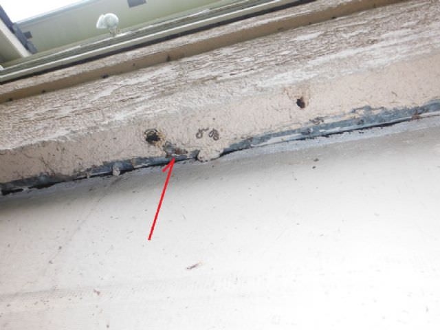

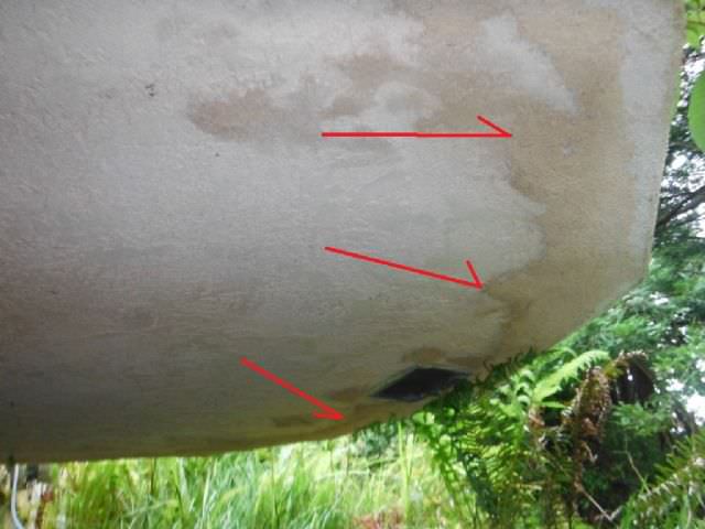

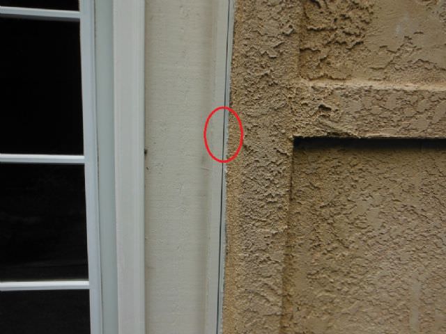

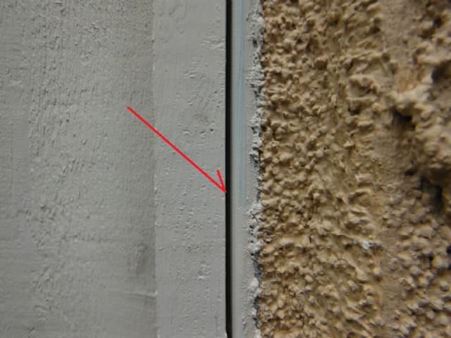

Denray Posted April 12, 2016 Report Share Posted April 12, 2016 Second time I've seen this kind of stuff. Is this EIFS? EIFS done wrong? Looks like water stains below that overhang? Window detail wrong? Click to Enlarge 72.52 KB Click to Enlarge 43.15 KB Click to Enlarge 48.43 KB Click to Enlarge 53.36 KB Click to Enlarge 53.89 KB Quote Link to comment Share on other sites More sharing options...
John Kogel Posted April 12, 2016 Report Share Posted April 12, 2016 Well spotted, old chap. [] Actually true EIFS will have the insulation board behind the stucco, so it could be slurpy one coat stucco on sheathing, can't tell from here. Quote Link to comment Share on other sites More sharing options...

Marc Posted April 12, 2016 Report Share Posted April 12, 2016 Jeez, what a mess. I see horizontal surfaces pretty regularly in residential and always recommend a complete strip and do over, even on new construction. The horizontal surfaces degrade rapidly, leak and eventually cause mold growth on the inside of the wall. Note: All foam trim and projecting architectural features must have a minimum 1:2 [27 degree] slope along their top surface. All horizontal reveals must have a minimum 1:2 [27 degree] slope along their bottom surface. Increase slope for northern climates to prevent accumulation of ice/snow and water on surface. Where trim/feature or bottom surface of reveal projects more than 2 inches (51 mm) from the face of the wall plane, protect the weather exposed sloped surface with waterproof base coat. Avoid the use of trim and features that exceed the maximum allowable thickness of foam permitted by code (typically 4 inches [100 mm]) unless approved by the code official. Periodic inspections and increased maintenance may be required to maintain surface integrity of finish on sloped weather exposed surfaces. Limit projecting features to easily accessible areas and limit total area to facilitate maintenance and minimize maintenance burden. Refer to Sto details. The horiz surfaces are just the beginning. Marc Quote Link to comment Share on other sites More sharing options...

Scottpat Posted April 13, 2016 Report Share Posted April 13, 2016 Any band, quoin or horizontal detail must have a slope to allow water to flow off and to help keep rain from hitting straight on as it will wear that lamina coat off quicker. The slope should be around 5-7 degrees this way water will runoff and rain will hit at an angle. Quote Link to comment Share on other sites More sharing options...

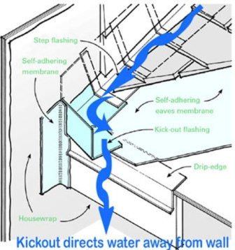

inspector57 Posted April 14, 2016 Report Share Posted April 14, 2016 It's on Styrofoam type stuff. Look at the chimney. I wonder what makes those black marks? Lack of kickout flashing at the chimney. Click to Enlarge 30.03 KB Quote Link to comment Share on other sites More sharing options...
