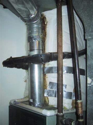

Mike Lamb Posted January 13, 2017 Report Share Posted January 13, 2017 Click to Enlarge 31.21 KB Quote Link to comment Share on other sites More sharing options...

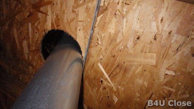

AHI in AR Posted January 17, 2017 Report Share Posted January 17, 2017 Just curious... I've seen problems with single wall pipe, but has anyone ever seen problems with double wall (B vent) piping closer than 1" to combustibles? Honestly, in 17 years I can't recall that I ever have. Quote Link to comment Share on other sites More sharing options...

Jim Katen Posted January 17, 2017 Report Share Posted January 17, 2017 Just curious... I've seen problems with single wall pipe, but has anyone ever seen problems with double wall (B vent) piping closer than 1" to combustibles? Honestly, in 17 years I can't recall that I ever have. Click to Enlarge 28.13 KB Click to Enlarge 25.33 KB Click to Enlarge 24.72 KB Quote Link to comment Share on other sites More sharing options...

Mike Lamb Posted January 17, 2017 Author Report Share Posted January 17, 2017 This is from my website: http://www.inspection2020.com/newsletter.pdf I also have personally never seen a problem with B-vents next to combustibles. Jim's pictures are certainly atypical. Maybe they put the B-vent on after the single wall vent did the damage? Quote Link to comment Share on other sites More sharing options...
