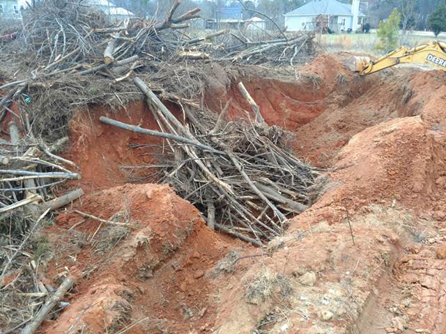

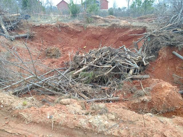

Jim Baird Posted January 30, 2018 Report Share Posted January 30, 2018 These photos are of an L shape ditch a spec builder is making at the rear of a cpl of lots he is building two houses on. Half acre lots generally, some 3/4 ac, all septic tanks. Neighbors don't like it. Their call to state environmental officer got zero answer. In nearby metro areas sinkholes from buried c&d wastes caused numerous problems that only occurred up to 15 yrs after the deed, in a state where this kind of violation has an 8 yr stat limit. Is this practice allowed where you guys live? Quote Link to comment Share on other sites More sharing options...
Tom Raymond Posted January 30, 2018 Report Share Posted January 30, 2018 Suburban sites it gets removed, rural (even quasi rural) it gets burned. Quote Link to comment Share on other sites More sharing options...
Chad Fabry Posted January 30, 2018 Report Share Posted January 30, 2018 If the material was inert, it wouldn't be an issue. It'll settle as it rots. The uncompacted fill will settle too, but unless the site plan specifies "clean fill" or for compaction rates, it's OK to bury wood if it doesn't affect the structure(s) Quote Link to comment Share on other sites More sharing options...
Jim Baird Posted January 30, 2018 Author Report Share Posted January 30, 2018 I'm told there is a real estate law that says if you bury anything on a site for sale you have to disclose. In our county there was an official inert materials landfill that went broke about the time of the finance/housing collapse. In the case of this builder, I have determined that he owns an adjacent odd shaped lot in this subdivision which is where he may be putting this stuff. In our county many subdivisions were approved, platted, and recorded but never built on, so that cleared parcels became overgrown with pioneer and weed species like sumac and chinaberry. These lots are some of those, that have to be scraped off to build on. Quote Link to comment Share on other sites More sharing options...
Jim Baird Posted January 30, 2018 Author Report Share Posted January 30, 2018 Incidentally, in our state it is legal to bury a person on your property, so I guess if you put Uncle Ralph out there in the yard you would have to disclose his location. Parcels I have visited where little graveyards lie have usually had them fenced off with guaranteed ingress/egress easements recorded on plats for memorial visits. Quote Link to comment Share on other sites More sharing options...
Marc Posted January 30, 2018 Report Share Posted January 30, 2018 (edited) No one does that here. It's burned or trucked out instead. Architects and engineers here on commercial construction that I've done draw inspections on will require testing for organic content before construction begins. Above a specified amount, excavation or 'grubbing' is required to whatever depth it takes to get organic matter content down to a specified maximum. Edited January 30, 2018 by Marc Quote Link to comment Share on other sites More sharing options...
mjr6550 Posted February 1, 2018 Report Share Posted February 1, 2018 In my area you cannot bury organic construction materials. Trees? I don't know. It also generates methane gas as it decays. Quote Link to comment Share on other sites More sharing options...
Jim Baird Posted February 1, 2018 Author Report Share Posted February 1, 2018 Our state defines "inert" waste as material unlikely to create "leachate", such as stumps, trees, concrete. Quote Link to comment Share on other sites More sharing options...
Chad Fabry Posted February 1, 2018 Report Share Posted February 1, 2018 Why would they refer to such substances as inert when the reason they're objectionable is the fact that they are not inert? Quote Link to comment Share on other sites More sharing options...

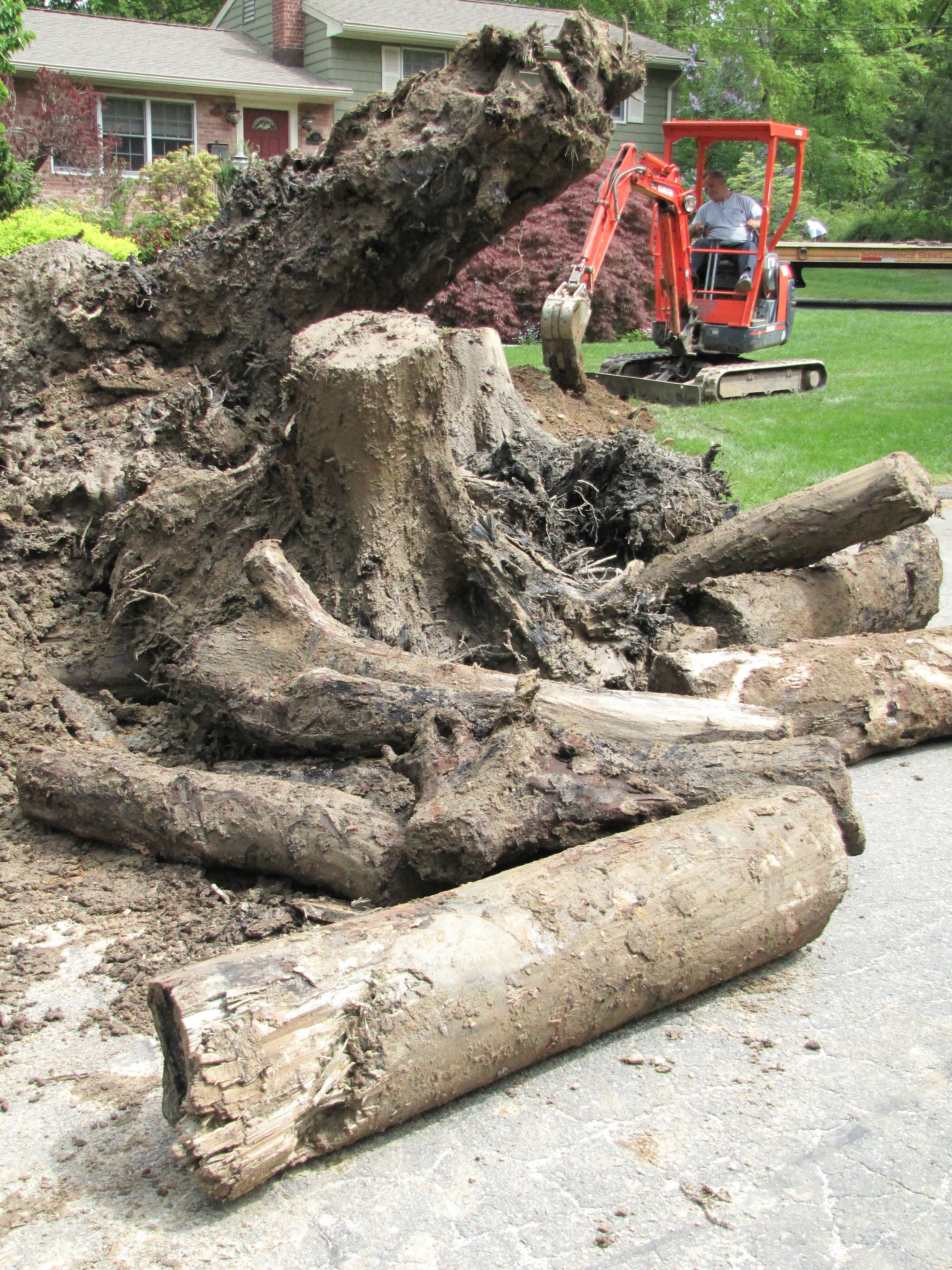

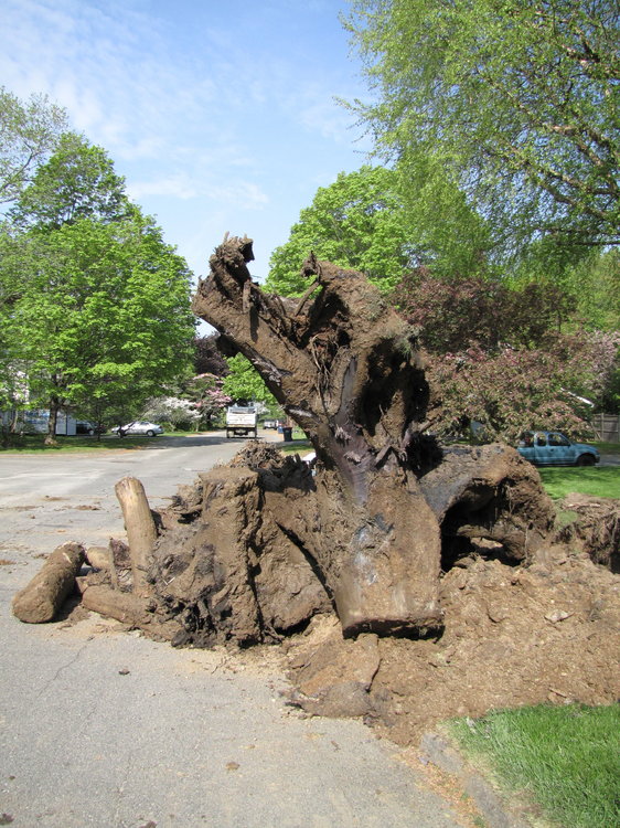

John Ghent Posted February 4, 2018 Report Share Posted February 4, 2018 These are Elm tree stumps and parts that the builder buried on my property in 1960 when the house was built. The cross street is named "Old Elm". They were discovered when I was having a curtain drain installed in 2011. 2 Quote Link to comment Share on other sites More sharing options...

Marc Posted September 29, 2018 Report Share Posted September 29, 2018 On 2/4/2018 at 9:03 AM, John Ghent said: These are Elm tree stumps and parts that the builder buried on my property in 1960 when the house was built. The cross street is named "Old Elm". They were discovered when I was having a curtain drain installed in 2011. It's amazing that it has yet to deteriorate after 51 years in the ground. Quote Link to comment Share on other sites More sharing options...
John Ghent Posted September 29, 2018 Report Share Posted September 29, 2018 I think the immersion in water, (ground water and septic water) created a perfect environment. Quote Link to comment Share on other sites More sharing options...
