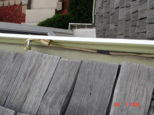

fyrmnk Posted June 5, 2006 Report Share Posted June 5, 2006 Here's a picture of a light gauge extension cord laying in a gutter on the roof and tightly wound around the gutter nail sleeve. It had even been damaged and taped up in the area where it would be laying in water. This was running out over a sharp metal edge onto the roof below, then tucked into the wood shakes and entering the home near the eave. Never could locate where it went inside, but it appears to have been hard wired in. As soon as I saw this I expected multiple other electrical problems, and there were. I try to always climb the roof. This one I could barely make it up, but glad I did. This couldn't be seen from the ground. Download Attachment: DSC00073.JPG 140.96 KB Download Attachment: DSC00074.JPG 140.16 KB Download Attachment: DSC00075.JPG 118.75 KB Quote Link to comment Share on other sites More sharing options...

kshepard Posted August 25, 2006 Report Share Posted August 25, 2006 The extension cord looks like the typical "permanent" christmas lights extension. Quote Link to comment Share on other sites More sharing options...
