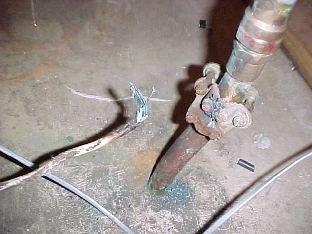

Jerry Simon Posted February 21, 2004 Report Share Posted February 21, 2004 I'm the guy who always checks water piping with my clamp ammeter, and find a few amperes of current in the pipe coming from the panel ground wire (those homes with metal muicipal supply pipe). Here's today's pic...this is the water meter ground jumper cable. It literally "fried" right off of the pipe clamp. No current currently in pipe. Any thoughts on why this may have occured. NOte: vacant house, and neighbor volunteered to my Client that prior owners had been having some electrical problems. Thanks! Download Attachment: MVC-005S.JPG 35.87 KB Quote Link to comment Share on other sites More sharing options...
Terence McCann Posted February 22, 2004 Report Share Posted February 22, 2004 Jerry: That was some picture. Electrolysis of some sort? I'll wait for Doug to weigh in. Quote Link to comment Share on other sites More sharing options...
Richard Moore Posted February 22, 2004 Report Share Posted February 22, 2004 Any chance that could be the result of a lightning strike...perhaps at the service drop or mast? Quote Link to comment Share on other sites More sharing options...
hausdok Posted February 22, 2004 Report Share Posted February 22, 2004 Hi Richard, That was my thought. Maybe corrosion caused by galvanic reaction, making the resistance in the wire too high to carry the current from a strike. OT - OF!!! M. Quote Link to comment Share on other sites More sharing options...
DLRambo Posted February 22, 2004 Report Share Posted February 22, 2004 Obviously we'd all be just guessing, so what did the Professional Electrician that is repairing it say caused it when you showed him the photo. Quote Link to comment Share on other sites More sharing options...
Jim Katen Posted February 22, 2004 Report Share Posted February 22, 2004 On my monitor it looks more like corrosion than burning. BTW, in response to your past findings, I've been clamping ground wires every now & then for the past year or so(has it been that long?) I almost never find anything though occasionally the strangest thing happens. My meter would show a small reading but it would come & go. After puzzling over it for a while I realized that it had to do with the physical orientation of the meter. Have you ever had that happen or should I just start shopping for another meter? - Jim Katen, Oregon Quote Link to comment Share on other sites More sharing options...
Jerry Simon Posted February 22, 2004 Author Report Share Posted February 22, 2004 This wire over-heated...wasn't from corrosion. If you look closely at the end of the white wire insulation (may be hard to see well), it turned very brown from the heat, just like you'd see the end of a neutral wire turn brown at a bus bar connection that over-heated from sharing two hots on the same phase. In person, it is very obvious this was from heat. Lightning? Don't know. This was the only thing with damage...nothing in the panelboard like I'd expect from lightning. Again, neighbor said Sparkys have been to the home before 'cause of "problems"...don't know the nature of the "problems"...vacant house, neighbors hearsay. Jim...I posted on ASHI about a year ago about current bleeding from ground to water pipe. I even posted a picture of my ammeter with a record finding of 23 amperes in the pipe! Have also seen current run into gas pipe that was lying on the water pipe. From the ground?...Yes...I disconnect the ground, current in pipe disappears. Some local utility guy said the older utility co. infrastructure is undersized for the tear-downs(very common around CHi-Town) and resulting service size increases in the new, bigger homes...the utility co. older neutral is undersized, and can't handle all (increased) return current...thus, it bleeds to ground & into house water pipe. Would love to hear Dougs thoughts. Quote Link to comment Share on other sites More sharing options...

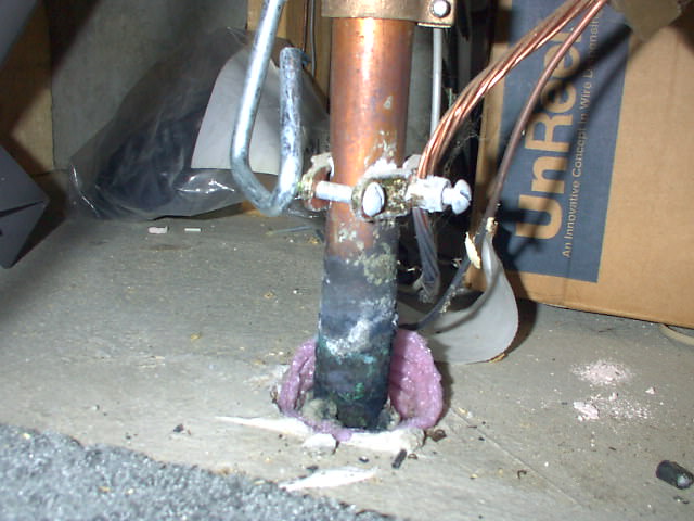

Rob Amaral Posted February 23, 2004 Report Share Posted February 23, 2004 I ran into something similar this weekend. Copper water service is burned, sintered and damaged. Looked like lightning to me. Clamp felt tight. Download Attachment: IMAGE085.JPG 88.18 KB Quote Link to comment Share on other sites More sharing options...
Rob Amaral Posted February 23, 2004 Report Share Posted February 23, 2004 BTW, have any of you had experience with 'how far into the ground' this type of damage on the pipe can go? Quote Link to comment Share on other sites More sharing options...
mcramer Posted February 23, 2004 Report Share Posted February 23, 2004 Originally posted by Rob Amaral BTW, have any of you had experience with 'how far into the ground' this type of damage on the pipe can go? Yes, here in central FL, lightning capital of the US, it's been known to cause pinhole leaks in the copper far removed from the connection of the grounding wire. Quote Link to comment Share on other sites More sharing options...
hausdok Posted February 23, 2004 Report Share Posted February 23, 2004 Hi Rob, Just looking at your photo. I should imagine that if that pipe is completely wrapped in foam all the way to the meter that very little of it is actually in contact with the earth. Was there a ground rod besides? ONE TEAM - ONE FIGHT!!! Mike Quote Link to comment Share on other sites More sharing options...
Rob Amaral Posted February 24, 2004 Report Share Posted February 24, 2004 Mike: I have no way of knowing how deep the pipe is wrapped. I advised them to have the town shut off the water at the curb valve, remove the meter, examine the pipe more closely and try to determine the 'depth' of the damage. Very brittle pipe. Thanks for the FL response. FL is indeed the lightning capital of the US. I'll pass that along. Quote Link to comment Share on other sites More sharing options...

Jerry Simon Posted February 25, 2004 Author Report Share Posted February 25, 2004 Mark Cramer...you make good sense...it is VERY common, and this "stray" earth current is ONE explanation. However, on more than a few occasions, I (& Seller's electrician in one instance), noted the current, then disconnected the panel ground, and voila!...no more current to the water pipe. None,..zippola. But like you say, other times current remains, so must be coming from the earth. Doug...I too apologize for the other board comments, though I don't remember them. But knowing me, I most certainly contributed to the lack of humor. By the by, I use a SPERRY Model DSA 600 (digital readout).... & thanks for your input. Quote Link to comment Share on other sites More sharing options...
Rob Amaral Posted February 25, 2004 Report Share Posted February 25, 2004 I remember a fellow inspector of mine telling me about the neutral thing. This was a new neighborhood... The entire neighborhood is new. Looked like high heat from lightning. Quote Link to comment Share on other sites More sharing options...
hausdok Posted February 25, 2004 Report Share Posted February 25, 2004 Hi, Most new construction around here the below grade pipe is wrapped with the equivalent of a wide black plastic electrical tape and padded like that with foam only where it passes through the concrete. Sometimes though, the foam goes farther. I though, given the frost depth in MA, that you guys there might wrap it further. ONE TEAM - ONE FIGHT!!! Mike Quote Link to comment Share on other sites More sharing options...
