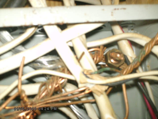

Phillip Posted January 6, 2008 Report Share Posted January 6, 2008 From todays inspection. Image Insert: 104.38 KB Image Insert: 90.66 KB Image Insert: 87.7 KB Image Insert: 140.48 KB Adding a bus bar would fix one of the items wrong with this panel Quote Link to comment Share on other sites More sharing options...
AHI in AR Posted January 6, 2008 Report Share Posted January 6, 2008 Phillip-- (And everyone else sending in close up pics which are out of focus) Some well intentioned advice here...when taking close up pics, most cameras require you to switch to macro mode. It only takes a few seconds, but if you don't, all we and your clients see are blurry photos. That makes it real hard to figure out what's actually going on in some cases. Quote Link to comment Share on other sites More sharing options...
