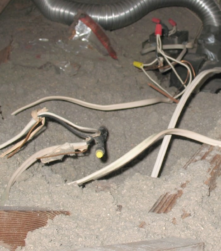

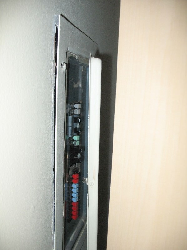

Richard Moore Posted February 24, 2008 Report Share Posted February 24, 2008 Originally posted by Jim Katen There's no way to know. Whenever you get an anomolous reading with a three-light tester, pull out a multi-meter to confirm. I might change that "whenever" to "most times". Had a 1920's beauty the other day. Updated in the 60's with a nice Zinsco panel, completely inaccessible behind an entertainment center. Still lots of KT (much buried) but all of the new wiring, attic and crawl, was as in the photos. There are some times you can trust the tester. [:-crazy] Download Attachment: 080220H055x.jpg 86.68 KB Download Attachment: 080220H060x.jpg 137.54 KB Download Attachment: 080220H115x.jpg 158.82 KB Quote Link to comment Share on other sites More sharing options...
