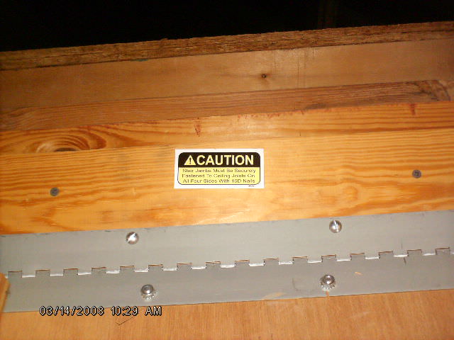

Phillip Posted March 15, 2008 Report Share Posted March 15, 2008 I guess the Installer are not reading the directions or just don't care. Image Insert: 79.22 KB Label says 16 D nail and they use screws. Link to comment Share on other sites More sharing options...
Brian G Posted March 16, 2008 Report Share Posted March 16, 2008 I'd estimate about 1/3 to 1/2 of all folding stairs I see aren't properly installed. Very common. Brian G. We Don't Need No Stinking Instructions [:-dunce] Link to comment Share on other sites More sharing options...
Erby Posted March 16, 2008 Report Share Posted March 16, 2008 Phillip, I think you are way way way way off base here. I mean, do you really expect intallers to read the directions!!!! Somewhere I've got a picture of a drywall screw right through the label that says "use 16D nail" Link to comment Share on other sites More sharing options...

Brandon Chew Posted March 17, 2008 Report Share Posted March 17, 2008 Originally posted by randynavarro Originally posted by Darren Speaking of drywall screws; how many kitchen cabinets do you find with drywall screws? MANY! Lots. I used to write them up frequently but I'm getting a bit more forgiving. There's bigger fish to fry. If someone can give me a good reason to start writing them again, I'll go for it. How about this. Drywall screws are designed to hold the weight of sheets of drywall, and they are strongest when the force is applied on them in the same direction as the shaft of the screw. They are pretty weak screws. I've snapped the heads off of them when trying to drive them into tight grained wood. Use drywall screws to hang upper cabinets and you have a situation where: -- Weight can be substantially greater than sheets of drywall -- Substantially fewer screws are used than when you hang a sheet of drywall -- The weight is being applied to the screws in their weakest direction, perpendicular to the shaft Now, six year old Johnny is thirsty and wants a drink. The glasses are in an upper cabinet that is stacked full of dishes. He hops up to sit on the kitchen counter, opens the door on the cabinet, and then grabs on to the bottom shelf to pull himself up so he can reach the glass on a higher shelf.... Link to comment Share on other sites More sharing options...
Jim Katen Posted March 17, 2008 Report Share Posted March 17, 2008 I've seen hundreds of drywall screws fail as they were being driven but I've never seen one fail after it was driven. - Jim Katen, Oregon Link to comment Share on other sites More sharing options...
Brian G Posted March 17, 2008 Report Share Posted March 17, 2008 I've seen a lot of them fail as I tried to remove them as well, but I also can't think of a time when one failed between installation and removal. Nonethless, they are extraodinarily brittle screws with not much beef at the shaft, and I wouldn't consider using them to hold up folding stairs. Brian G. Maybe For My Wife to Use, on Certain Days [:-dev3][-crzwom] Link to comment Share on other sites More sharing options...
Jim Katen Posted March 17, 2008 Report Share Posted March 17, 2008 Originally posted by Brian G I've seen a lot of them fail as I tried to remove them as well, but I also can't think of a time when one failed between installation and removal. Nonethless, they are extraodinarily brittle screws with not much beef at the shaft, and I wouldn't consider using them to hold up folding stairs. Brian G. Maybe For My Wife to Use, on Certain Days [:-dev3][-crzwom] I don't like to see them holding up folding stairs, cabinets or anything heavy. But it isn't because I'm afraid that they'll fail. It's because I'm afraid that they failed when they were put in and, if they did, I can't see the break. Oftentimes, they snap well below the head. In those cases, the head stays put, but it isn't connected to the shaft of the screw. - Jim Katen, Oregon Link to comment Share on other sites More sharing options...
Erby Posted March 17, 2008 Report Share Posted March 17, 2008 I use this language: =================== Drywall screws are being used to hold the attic drop down stairs in place. Most manufacturer's require size 16D nails to hold these stairs in place as drywall screws do not have sufficient shear (sideways) strength to support the weight placed on most attic ladders. For safety, I recommend that these screws be replaced with the requisite number & size of nails to safely hold the stairs in place in compliance with the manufacturer's instructions. Link to comment Share on other sites More sharing options...
Darren Posted March 17, 2008 Report Share Posted March 17, 2008 Erby, I say just about the same thing except I tell them to use 1/4" X 3 lag screws (as per manufactures instuctions). Banging 16d nails into the ceiling joists will probably cause some cracking or nail pops. Link to comment Share on other sites More sharing options...

Jim Katen Posted March 18, 2008 Report Share Posted March 18, 2008 Originally posted by randynavarro Use drywall screws to hang upper cabinets and you have a situation where: -- Weight can be substantially greater than sheets of drywall -- Substantially fewer screws are used than when you hang a sheet of drywall -- The weight is being applied to the screws in their weakest direction, perpendicular to the shaft What if they're gold-colored? I've seen drywall screws and cabinet screws that look almost identical. The gold colored ones are no stronger than the black ones or the galvanized ones. Cabinet screws look different. Don't ask me how, they just look different. - Jim Katen, Oregon Link to comment Share on other sites More sharing options...
