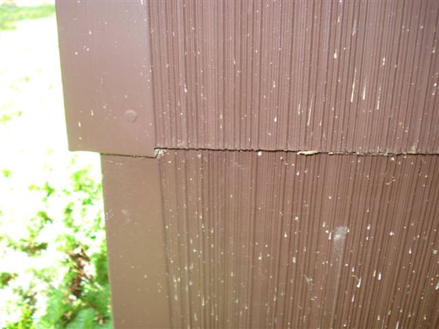

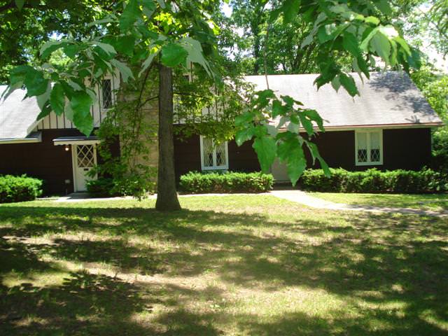

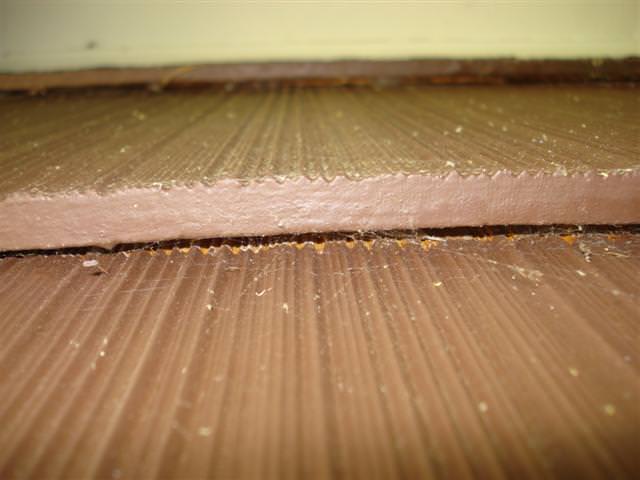

Erby Posted June 2, 2008 Report Share Posted June 2, 2008 A little help with ID of this siding would be appreciated. House is 1960's construction. My first thought was some kind of fiber cement but, as the side view picture shows, it's more flexible than a fiber cement siding piece. Close view Image Insert: 54.26 KB Bottom view. Image Insert: 46.17 KB Side view Image Insert: 47.75 KB Close view Image Insert: 53.24 KB Distant view Image Insert: 98.46 KB Quote Link to comment Share on other sites More sharing options...

AHI in AR Posted June 2, 2008 Report Share Posted June 2, 2008 Erby-- I wouldn't be too quick to rule out wood siding. I see a fair amount of similar siding locally -- usually from the early 1960's. The pattern is one machined to resemble cedar shake siding. More than one RE agent has suspected it to be asbestos-containing due to roughly similar looking materials from previous deacdes but it is actually wood. In my experience, it's cedar. Multiple layers of paint hide some characteristics. Take a knife and carefully scrape an edge to see what you get. Quote Link to comment Share on other sites More sharing options...
hausdok Posted June 2, 2008 Report Share Posted June 2, 2008 Hi, It's combed cedar siding. Some folks refer to it as striated cedar siding. It's as common around here as liberals at a Democratic party convention. OT - OF!!! M. Quote Link to comment Share on other sites More sharing options...

Bill Kibbel Posted April 15, 2014 Report Share Posted April 15, 2014 It's a product called Insul-Shake. It's asphalt-coated Celotex fiber-board (made from sugar cane bagass) with ceramic granules. The same product as the more common Insul-brick, but with a texture that is intended to imitate wood shakes. It was not manufactured with asbestos fibers. I don't know of any material that I would use for repairs. It's at the end of its useful life. Quote Link to comment Share on other sites More sharing options...
