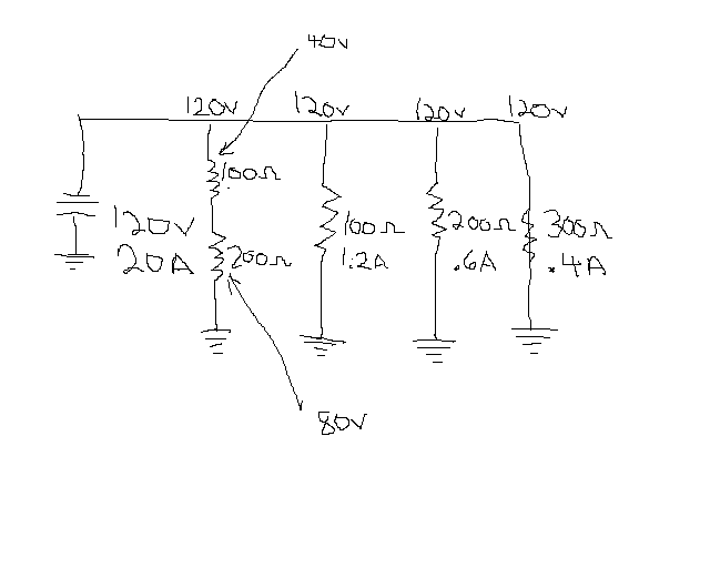

swarga Posted May 20, 2004 Report Share Posted May 20, 2004 After using my sure test for a year I changed how I view voltage drop. 1. All circuits will have some drop. 2. The longer the run the greater the drop. I changed my reporting to over a 5% increase in a circuit. For example first outlet has a VD of 5% and the next has a VD of 10%. This indicates a bad connection and something that may need repair. If I check the first outlet (100 feet from the service panel)and it has a VD of 6% the next is 7% the next is 8% the next is 10%. I can bet that they back stabbed the outlets but I don't get very concerned. Quote Link to comment Share on other sites More sharing options...
Chad Fabry Posted May 20, 2004 Report Share Posted May 20, 2004 Hi, errr Crusty, My point is voltage variance presents a problem for the load device if it exceeds the parameter where the device will operate safely. I'd bet that most devices will operate safely in the 90% to 105% range of specified voltage. If the voltage drop was critical in that range, more stringent guidelines would be applied. Don't mistake my opinion for an endoresement of a 10% percent voltage drop, but current will increase as voltage drops until it kicks a circuit an overload device. The real danger is mostly to the windings of motors. Quote Link to comment Share on other sites More sharing options...
hausdok Posted May 20, 2004 Report Share Posted May 20, 2004 Hi, I think Chad is correct. Electrical devices are supposed to be designed to operate in the 108 to 132 volt range. So, unless you drop below 10% of the 120volt nominal, you are in a safe range for whatever is operating off that circuit. Scott is also correct, voltage drop is affected a great deal by distance from source. Think of water through a pipe. The farther from the source, the less pressure water has, unless you up the size of the pipe. With wiring it is the same way. An outlet 100ft. from the panel can easily have a drop of 10% but have perfectly good connections all the way to the panel. The issue then becomes a question of delivered voltage at that distance, which won't be within parameters. The correction is supposed to be a larger pipe (conductor). If not, delivered voltage is insufficient and whatever is being powered could be at risk. My understanding anyway. Don't rely on it - in my mind electricity and voodoo have similar properties. ONE TEAM - ONE FIGHT!!! Mike Quote Link to comment Share on other sites More sharing options...

swarga Posted May 21, 2004 Report Share Posted May 21, 2004 10-15% voltage drop across a device or in one parallel leg is nothing to be alarmed about at all. Current drop is much more of a concern and if there was a problem with excessive current drop/load, then your breakers and fuses would be tripping and blowing indicating a problem. I beg to differ. I tested a outlet on a bedroom wall and got a VD of 8%. 6 feet down the same wall I test the next outlet and got a VD of 14%. The electrician called me when he got to the house to ask me what the problem was. I explained where I found the volt drop and told him I thought there may be a bad connection somewhere in between. He called me back an hour later and informed me that someone had installed an additional outlet in the linen closet (on the other side of the wall) and that the wires at that outlet were loose and melted. (the outlet was covered with towels)He wanted to know where I bought my Suretest so he could go get one. Doug Hansen has a similar story about someone covering a junction box with loose connections behind a bathroom mirror. He found the problem with a Suretest because of the voltage drop. I say again 5% increase in the same circuit may indicate a problem. (Kurt, next time you do those tests, don't forget to plug it in.[]) Quote Link to comment Share on other sites More sharing options...
kurt Posted May 21, 2004 Report Share Posted May 21, 2004 Originally posted by swarga I beg to differ. I tested a outlet on a bedroom wall and got a VD of 8%. 6 feet down the same wall I test the next outlet and got a VD of 14%. The electrician called me when he got to the house to ask me what the problem was. I explained where I found the volt drop and told him I thought there may be a bad connection somewhere in between. He called me back an hour later and informed me that someone had installed an additional outlet in the linen closet (on the other side of the wall) and that the wires at that outlet were loose and melted. (the outlet was covered with towels)He wanted to know where I bought my Suretest so he could go get one. Doug Hansen has a similar story about someone covering a junction box with loose connections behind a bathroom mirror. He found the problem with a Suretest because of the voltage drop. I say again 5% increase in the same circuit may indicate a problem. (Kurt, next time you do those tests, don't forget to plug it in.[]) Absolutely. It may indicate a problem. Or not. Neither story makes me think about minor VD even one little bit. In the lineup of potential hazards in a home, it is another one. The point was/is that the NEC is an extremely conservative document, & they don't think it's significant enough to include it as a requirement. For the time being, that's good enough for me. If I started to make up my own rules for what is right, things could get complicated. How many times does one discover minor VD & there is a red herring chase for conditions that are never discovered? How many times does one test an outlet & get conflicting results? When one has the coolest hammer, everything becomes a nail. Quote Link to comment Share on other sites More sharing options...
