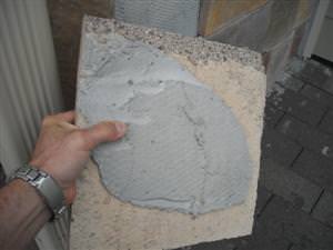

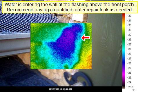

hspinnler Posted December 13, 2008 Report Share Posted December 13, 2008 Randy, I 've been meditating about this very subject. I'm seeing poorly adhered stones & quality of workmanship. Moisture detected in yesterday's inspection beginning from upper level front wall elevation and extending through two finished levels before emerging in OSB in cripple wall in basement. How is it possible to have much confidence that the out of sight moisture-resistant barrier was properly installed when you look at the cladding? The dry stacked look itself presents tons of places where moisture may enter and remain. Anyone see any kickout, diverter or counter-flashing when this product is used? What about the long term effects on wood components of windows and doors with all those gaps? Random falling stones hitting cars or people? Okay, maybe I'm taking this too far. [:-hspin] A few pics. It would be nice to see pictures from others too! Ineffective attempt to caulk gaps to stop water: Image Insert: 165.68 KB Moisture in basement cripple wall (three levels down): Image Insert: 50.69 KB Gaps above window with loosely installed stones: Image Insert: 39.49 KB What's going on with this intersection of roof, wall and gutter? Image Insert: 67.13 KB Quote Link to comment Share on other sites More sharing options...
randynavarro Posted December 13, 2008 Author Report Share Posted December 13, 2008 Good pics. Those are a great example of so many obvious defects, it doesn't take much assuming to know what's underneath is all messed up too. Its tough in our area because all the stone veneer usually looks so nicely installed - no visual blunders so to speak. So without more visual evidence of something wrong, I just usually give it the once over and move on without saying anything, (actually, I always write lack of weeps/drainage at the bottom - that's easy to see). Quote Link to comment Share on other sites More sharing options...

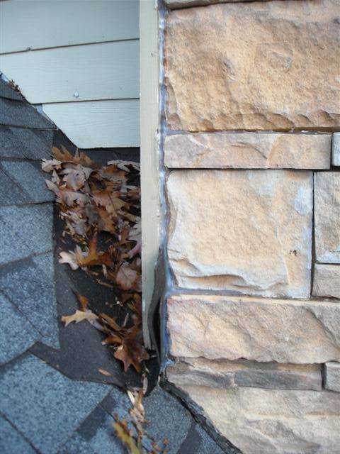

Mike Lamb Posted December 13, 2008 Report Share Posted December 13, 2008 Image Insert: 166.06 KB Image Insert: 99.41 KB Quote Link to comment Share on other sites More sharing options...
hausdok Posted December 13, 2008 Report Share Posted December 13, 2008 Hi, I don't think it's the un-grouted dry-stacked look of that cast stone that's the problem; the problem is the way that it's been installed out over the roof, lack of kickouts and lack of head flashings above that window. If that product is installed right, it drains nicely; just like veneer brick or a conventional stucco wall. When it's installed tight to a roof like that it's wrong and I'd bet a Hershey bar that it hasn't been properly flashed properly under/behind the veneer. The water that blows through the face and in around that window will simply drain into the wall and is probably getting behind the underlayment. If there's a layer of house wrap behind that cast stone, instead of two layers of felt, any water that gets behind the wrap can't dry to the exterior, is trapped and gets absorbed into the OSB and causes it to rot. Looks like just another rotten wall lawsuit on the horizon. ONE TEAM - ONE FIGHT!!! Mike Quote Link to comment Share on other sites More sharing options...
SWagar Posted December 13, 2008 Report Share Posted December 13, 2008 In my area I see a lot of Owens Corning Cultured Stone. They publish a best practices for flashing guide that can be found at: http://www.culturedstone.com/technical/flashing.asp More often than not these stone products are installed no where close to this guide. One of the major offenders I see is improper flashing where the stone meets vertical and horizontal wood trim at windows and walls. Owens Corning calls out J mold, backer rod and sealant. What I see is mortar, which by the time I see it has cracked and or separated away from the wood trim. This joint is no longer water proof. I refer all of my clients to this web page if they have any doubt about proper instalation. I've been in a couple of heated discussions with builders over this topic. I've had one builder tell me his installers were "trained" and "certified" by Owens Corning and yet they still did not follow the OC best practice guide. I agree with the prediction that these fake stone products will be the next EIFS. At a recent association meeting a building defect lawyer told us that he is already seeing claims against this stuff. Keep your eyes on the prize! Image Insert: 97.3 KB Quote Link to comment Share on other sites More sharing options...
hspinnler Posted December 13, 2008 Report Share Posted December 13, 2008 Good pictures guys. Here in GA, I find it necessary to knock on a representative number of stones to see if they are loose. Another inspection with larger flatter stones: Image Insert: 12.29 KB Image Insert: 10.42 KB Thermal imaging scans accompanying pics from first post: Water intrusion at gutter with no kickout: Image Insert: 38.78 KB Scan from interior side of wall: Image Insert: 25.91 KB Quote Link to comment Share on other sites More sharing options...
