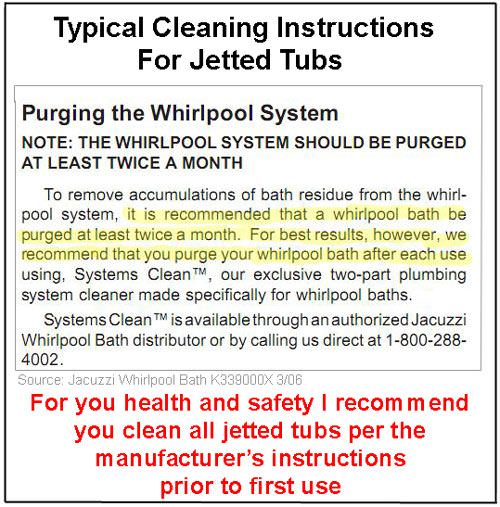

In addition to reporting visibly contaminated discharge from the jets if it's present, I routinely do two things to deal what the jetted tub issues:
1) I verbally explain to clients that jetted tubs require regular cleaning, and more frequently than they might expect.... that "for example Jacuzzi's instructions state that "for best results... we recommend that you purge your whirlpool bath after each use."
2) At every property with the jetted tub, a similar statement goes into the FYI section of the report, recommending cleaning according to the manufacturers operating instructions prior to first use. that way if somebody wants to start a fight over contamination of the jetted tub, the will be fighting with the manufacturers written instructions, not a home inspectors opinion.
If I really want to hammer home the point, this graphic in included.
Download Attachment: icon_photo.gif cleaning-ijacuzzi-500.jpg
96.82 KB
