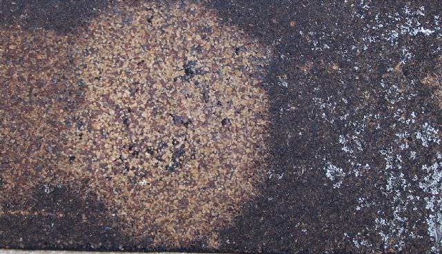

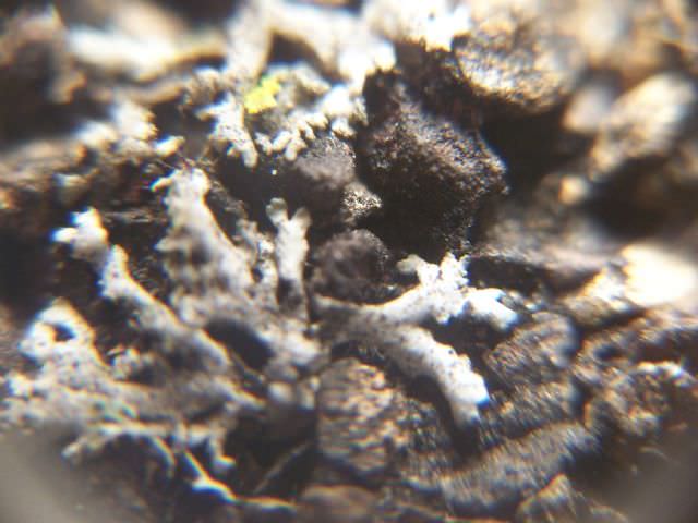

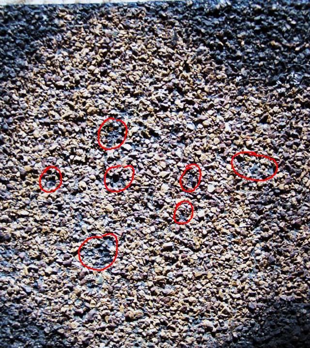

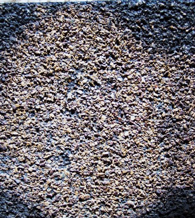

KimR Posted December 28, 2010 Report Share Posted December 28, 2010 Here are some samples of 10 year old shingles that have been cleaned, what is your take on if there is granule loss? One question, have you ever inspected a roof before and after a non-pressure cleaning? Click to Enlarge 210.54 KB Click to Enlarge 86.49 KB Click to Enlarge 73.79 KB Click to Enlarge 52.91 KB Click to Enlarge 105.8 KB Quote Link to comment Share on other sites More sharing options...
Marc Posted December 28, 2010 Report Share Posted December 28, 2010 Here are some samples of 10 year old shingles that have been cleaned, what is your take on if there is granule loss? One question, have you ever inspected a roof before and after a non-pressure cleaning? Click to Enlarge 211.18 KB Hello Kim, Granule loss is evident in the 1st and 2nd photos. Look at the black areas. That's asphalt, not black granules. How do I know it? Look at the shadows. Light source is at the top. Doesn't prove a thing anyway because age is also a factor in granule loss. Try it on a new 3-tab. Rinse with water and let it dry before the 'before' photo is taken because new shingles have loose granules right out of the bundle. I've never witnessed a 'non-pressure washer' cleaning. Still learning about the 'non-pressure' process on your forum and others like it and I may get into that business on the side, but without the chlorine. Marc Quote Link to comment Share on other sites More sharing options...
KimR Posted December 28, 2010 Report Share Posted December 28, 2010 Marc, If you do not use chlorine for cleaning, what method are you leaning to? I think the best way to get to the bottom of this topic is to find a roof with moderate to heavy stains, do a before and after soft wash cleaning inspection.( 10-15 yr old roof , not a 25 yr for obvious reasons ) I have seen the difference and it might be best if as inspectors you could witness it first hand, if you have not done so already. Take Care, Kim R Quote Link to comment Share on other sites More sharing options...
Marc Posted December 28, 2010 Report Share Posted December 28, 2010 Marc, If you do not use chlorine for cleaning, what method are you leaning to? I think the best way to get to the bottom of this topic is to find a roof with moderate to heavy stains, do a before and after soft wash cleaning inspection.( 10-15 yr old roof , not a 25 yr for obvious reasons ) I have seen the difference and it might be best if as inspectors you could witness it first hand, if you have not done so already. Take Care, Kim R Oxygen bleach. Isn't that what SoftWashSystems.com offers? Marc Quote Link to comment Share on other sites More sharing options...
hausdok Posted December 28, 2010 Report Share Posted December 28, 2010 That particular fungi is lichen. It's more aggressive than moss or algae. I usually see it near the peak of the roof where it will grow on the bird crap left at the ends. There's normally a lot of granule loss under that stuff. ONE TEAM - ONE FIGHT!!! Mike Quote Link to comment Share on other sites More sharing options...
