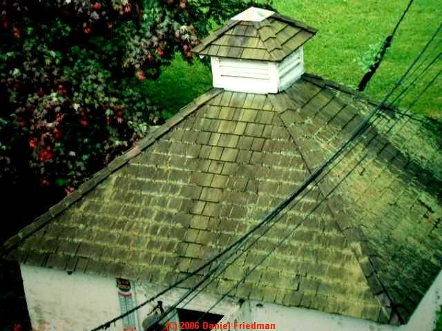

Neal Lewis Posted August 21, 2009 Report Share Posted August 21, 2009 I got a call that a buyer's insurance company has stated that the "mold" on the roof has to be removed or the insurance policy is canceled. The buyer has moved in and wants to know why I didn't know that their insurance company would require this. Has anyone else heard of this insurance requirement? Do you guys just report on the stains or do you recommend cleaning/removal, or what? Would anyone wish to share their verbiage about algae stains on roofs? Quote Link to comment Share on other sites More sharing options...
Kyle Kubs Posted August 21, 2009 Report Share Posted August 21, 2009 Hey Neal, You don't even want to know my response to the "Why didn't you know our insurance company would require this" thing... I'm in a mood and might say something inappropriate. [:-censore I have this .pdf file that I include with my reports. Download Attachment: CASMA - Techincal Bulletin Roof Staining Algae.pdf 81.82 KB The algae is aesthetic only. Tell the insurance agent to go jump off the roof. Quote Link to comment Share on other sites More sharing options...
Robert Jones Posted August 21, 2009 Report Share Posted August 21, 2009 That algae is a regular occurrence around here and really, depending on how long it has been on there, the "stain" may not come out. Just explain to your client that it is not mold, but algae. They can try and use Moss Out, but the algae will more than likely return They could also apply a zinc strip to the ridge and that might help. The blue green algae, is from an airborne source and real common in humid areas. Quote Link to comment Share on other sites More sharing options...
Inspectorjoe Posted August 21, 2009 Report Share Posted August 21, 2009 I've never heard of an insurance company requiring algae be removed. I think if pressed, they'd have a hard time coming up with published validation of their position. But then they don't have to - they're the insurance company. Moss and lichens can damage an asphalt shingle roof. That being said, I have lichens on a corner of my roof, and I'm not doing anything about it. Still, when I encounter it on a roof I'm inspecting, I do recommend having it removed and if possible, eliminating the shade that helped it grow. But you asked about algae. I always point it out to the buyer, just so they don't move in, wonder what that black stuff on the roof is and call me. Here's what goes in the report: The asphalt shingle roofing has discoloration on the surface. This is algae and is mainly a cosmetic issue. There are ways to reduce or eliminate this condition. See Article 3C.25 for more information. Quote Link to comment Share on other sites More sharing options...

Kyle Kubs Posted August 22, 2009 Report Share Posted August 22, 2009 Originally posted by hausdok Hi, Zinc straps are a waste of money. They work for a few feet but after that their effectiveness weakens. If you want them to be effective, you need to install them every few feet. I think I have to beg to differ with you on that one. Click to Enlarge 67.6 KB All that clear area down to the eaves from that little Copper cap at the peak. Personally I think Copper works better then Zinc but they both work. I have a house that faces my yard, heavily wooded and the shingled roof looks like a green shag carpet with moss. All except the completely clear area directly under the skylight that is flashed with Copper, Clear and clean all the way to the gutters, probably around 12', hell the edges are even crisp like someone ran a lawnmower through it. Comparing Moss to Algae is like elephants and ameba's... Yah, moss around here can do a real number on a roof if let go. The fungus we have is even worse, but I've never seen damage or wear from the black staining algae. Quote Link to comment Share on other sites More sharing options...

hausdok Posted August 22, 2009 Report Share Posted August 22, 2009 I have a house that faces my yard, heavily wooded and the shingled roof looks like a green shag carpet with moss. All except the completely clear area directly under the skylight that is flashed with Copper, Clear and clean all the way to the gutters, probably around 12', hell the edges are even crisp like someone ran a lawnmower through it. Comp or wood shingle? Here I see that happening with shakes and wood shingle but not with comp. Here, it seems to work for 3 -4 feet and then peters out on a comp roof but will keep the roof clear to the eaves on shakes and wood shingles. I think it's got to do with absorbency; the wood cover absorbs the stuff leaching off the copper or zinc but the comp doesn't - at least not what I've been seeing here. I suppose there can be different varieties of mosses and alga that are adapted to various regions that react differently. If there are, I can't imagine what it takes for a roofing manufacturer to reach an acceptable balance. Still convinced the stuff does damage roof covers. Bill, for the record, I hate roof cleaning companies. If I were King of the Planet, the state would issue home inspectors seasonal hunting licenses and allow them to thin out the roof cleaner herd once a year. Every inspector would have a 2-kill limit. Inspectors would be lauded as heroes for doing a service to humanity. [:-devil] ONE TEAM - ONE FIGHT!!! Mike Quote Link to comment Share on other sites More sharing options...
msteger Posted August 22, 2009 Report Share Posted August 22, 2009 I see algae pretty often in my area and I do note this in my report. I classify the algae staining as mostly cosmetic, although moss growth can damage over time. I've also never heard of an insurance company caring about mildew/algae on a roof. When I see algae, I verbally suggest a product such as Roof Reviver which works well in cleaning this stuff off gradually, and also mention that when it comes time to re-shingle, thet may want to use an "AR" shingle. Quote Link to comment Share on other sites More sharing options...
Kyle Kubs Posted August 24, 2009 Report Share Posted August 24, 2009 I have a house that faces my yard, heavily wooded and the shingled roof looks like a green shag carpet with moss. All except the completely clear area directly under the skylight that is flashed with Copper, Clear and clean all the way to the gutters, probably around 12', hell the edges are even crisp like someone ran a lawnmower through it. Comp or wood shingle? Here I see that happening with shakes and wood shingle but not with comp. Here, it seems to work for 3 -4 feet and then peters out on a comp roof but will keep the roof clear to the eaves on shakes and wood shingles. I think it's got to do with absorbency; the wood cover absorbs the stuff leaching off the copper or zinc but the comp doesn't - at least not what I've been seeing here. I suppose there can be different varieties of mosses and alga that are adapted to various regions that react differently. If there are, I can't imagine what it takes for a roofing manufacturer to reach an acceptable balance. Still convinced the stuff does damage roof covers. Bill, for the record, I hate roof cleaning companies. If I were King of the Planet, the state would issue home inspectors seasonal hunting licenses and allow them to thin out the roof cleaner herd once a year. Every inspector would have a 2-kill limit. Inspectors would be lauded as heroes for doing a service to humanity. [:-devil] ONE TEAM - ONE FIGHT!!! Mike Sorry, should have been more specific. - My neighbors roof is Asphalt Comp. I've seen it on several others also. I've been wanting to take a picture of my neighbor's roof but I don't know him, he might not take well to me pointing a camera at the back of his house from the the woods in back of mine... Thinking about it, the pic. I posted was pulled from Dan Freidmens web site, I don't even know where it was taken. In regards to that and the Algae causing damage, I'm sure this is an instance where regional factors could easily have a dramatic effect... We have pretty harsh Winters compared to you. Our full year cycle can see temperatures from 115 degrees to -20. We don't have things like your wood destroying fungus' either. Hell you have volcanic gases roaming around your area and coming down in the rain, that alone could account for a hell of a lot of things, including the lime being eaten away from the granule. Out here, that algae is nothing but a stain. Quote Link to comment Share on other sites More sharing options...
