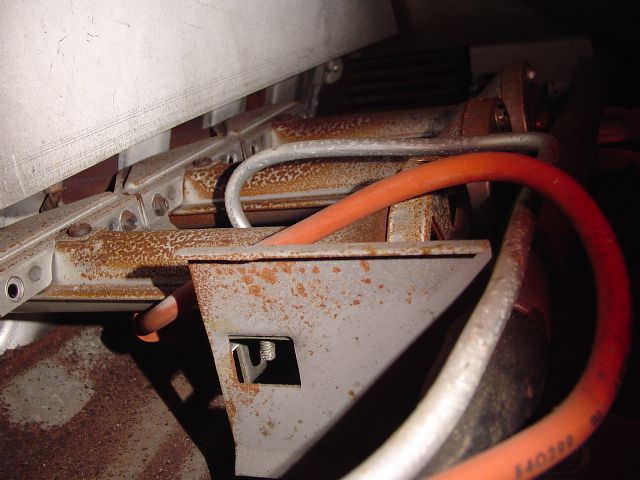

Bain Posted January 19, 2010 Report Share Posted January 19, 2010 HOW TO PROPERLY DERATE A GAS FURNACE: Click to Enlarge 55.14 KB Click to Enlarge 51.95 KB (Kurt, I'm not trying to hijack your thread.) Quote Link to comment Share on other sites More sharing options...
