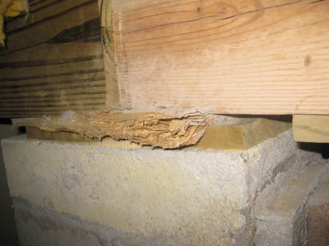

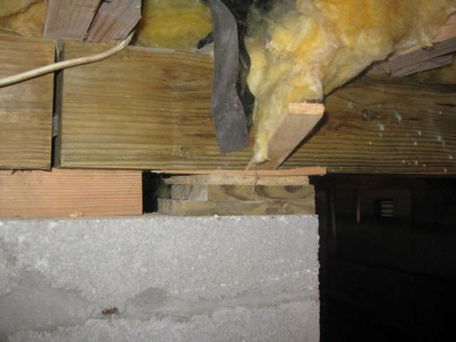

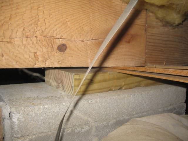

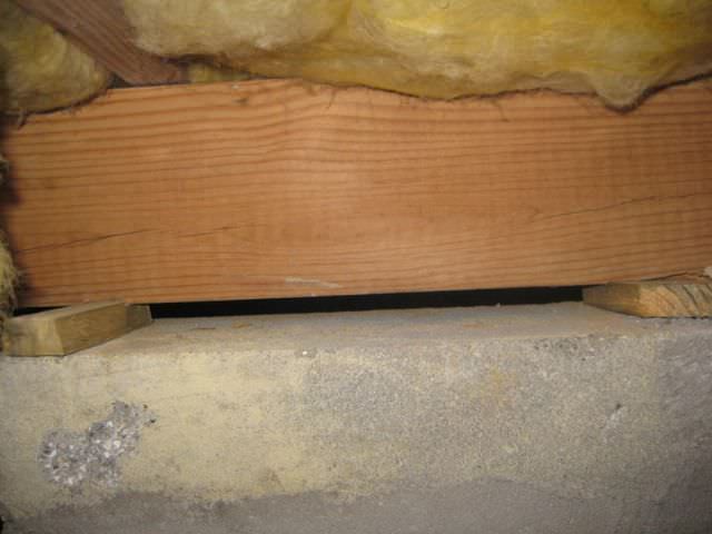

nuker Posted July 8, 2010 Report Share Posted July 8, 2010 I'm a homeowner that recently received inspection report rating the use of these wooden spacers and shims as acceptable after some contractor work to jack and level a house. Overlooking the use of wood, I have concerns about the spacer/shims not matching the width of the supported beam and not running the length of the pier. Also have concerns about the use of particle board and soft wedge shims. I intend to discuss this further with the contractor but want to ensure my thoughts are consistent with the views of others more experienced. The acceptable inspection is causing me to question myself. Please let me know your thoughts on the pics. Thanks. Click to Enlarge 42.98 KB Click to Enlarge 43.84 KB Click to Enlarge 47.26 KB Click to Enlarge 47.93 KB Link to comment Share on other sites More sharing options...
Chad Fabry Posted July 8, 2010 Report Share Posted July 8, 2010 Please let me know your thoughts on the pics. Cheesey? Non-compliant? Squishy? Jackleg? Link to comment Share on other sites More sharing options...

Nolan Kienitz Posted July 8, 2010 Report Share Posted July 8, 2010 History has shown that leftovers are often used for shimming pier & beam foundations and the shims are usually wood. The current and recommended practice by reputable foundation companies and contractors that 'should' know better is the use of steel shims. You can do a web-search and find many opinions, but the true professional engineers, contractors, foundation companies will all try to do the "right thing". Using wood shims on new or current re-work does not fall into that category. Link to comment Share on other sites More sharing options...

hausdok Posted July 8, 2010 Report Share Posted July 8, 2010 Nothwithstanding the other comments, which I agree with, a month ago I had a 50 years old house which has been sitting up on shims since it was new. I didn't detect it until I went into the crawlspace. I'd talk to him about replacing the wood shims with the steel shims and using a very stiff mortar mix to grout any gaps between shims under those beams. ONE TEAM - ONE FIGHT!!! Mike Link to comment Share on other sites More sharing options...
nuker Posted July 8, 2010 Author Report Share Posted July 8, 2010 Thank you all for the feedback and suggestions. As he rebuilt most the piers I am a bit perplexed why the gap was not accounted for during the construction of the pier. Steel shims will work to provide a non-compressible shim but how best should he compensate for the gap between the top of the pier and steel shim (some gaps are greater than 2-3 inches). As this was part of a remodeling job, the interior walls and floors have all been finished and I'm worried that if he jacks again to make repairs to these spacers/shims (if he agrees to do so) that he will crack the work just completed. Is interior damage likely if it's jacked just enough to replace or modify the shims... Thanks for the advice, I'm struggling on how to resolve this. Link to comment Share on other sites More sharing options...

Tom Raymond Posted July 9, 2010 Report Share Posted July 9, 2010 That's just dandy, but totally irrelevant. This is a wood beam supporting a wood framed addition. If that mess of scrap wood was supporting a HUD code home it wouldn't be any more acceptable. It's just shoddy work. If it were mine; I'd cut nice straight grained blocking from treated wood, install them close to the edges of the piers very much like the first pic, and pack grout under the beam between the blocking. Steel would be better, but for the large gaps a single well fit wood block will be more stable and easier to handle than a pile of shims. Once the grout has set the shims are superfluous. It might be wrong, but a hell of a lot less so than what is there. Tom Link to comment Share on other sites More sharing options...
David Meiland Posted July 9, 2010 Report Share Posted July 9, 2010 It should be quite easy to replace the shims with either steel or solid wood, by jacking the beam slightly at each pier.... just enough to take the pressure off. I would bring chunks of 1/4" steel plate, chunks of sheet metal (easy to just buy Simpson tie plates for that), and chunks of dense VG fir 1x. A few layers of 30# felt would go between concrete and wood. I have done significant jacking of finished homes and it's not that easy to break the drywall or anything else, especially not with the <1/8" you need to replace the shims. Grout is a good material but you need to let it cure a bit, so you'd have to go to the job twice, and you'd need enough jacks to support each grouted location. Link to comment Share on other sites More sharing options...

Tom Raymond Posted July 9, 2010 Report Share Posted July 9, 2010 Marc, I'm all for creative reuse of off cuts and such, and on occasion I'll cut shims and wedges from scrap, but I generally purchase manufactured shims in pallet quantities (remember I'm a window and door guy when I'm not in my HI costume). This 'contractor' botched the piers and then bludgeoned a bunch of detritus into place to fix it. Steel shims and grout are the correct repair, and nicely fitted wood blocking would surely be more than adequate, but you aren't actually condoning what this block head did, are you? No offense, but your HUD code post implied that you are. Tom Link to comment Share on other sites More sharing options...

Scottpat Posted July 9, 2010 Report Share Posted July 9, 2010 I don't have a problem with the use of wood to fill in the gap between the beam and the pier as long as it is treated wood, it provides adequate support and it will not squash over time. Use some wood blocking and then metal shim plates and go on with life..... [] Link to comment Share on other sites More sharing options...
