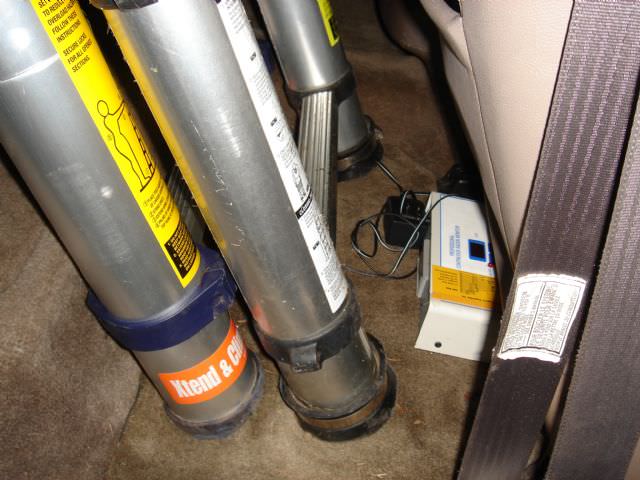

blazenut Posted August 23, 2010 Report Share Posted August 23, 2010 Do any of you guys carry telescopic ladders? I currently use a 12' little giant type ladder for hatch attics, but for various reasons I need to get a smaller ladder. Ive always been hesitant to buy one of these because of ease of use, and i have never seen one in person to test. Which ones are the best, easiest to set up, etc.? Thanks. Quote Link to comment Share on other sites More sharing options...

blazenut Posted August 24, 2010 Author Report Share Posted August 24, 2010 Thanks guys... i really like the one im using, but i need room for a second car seat! Quote Link to comment Share on other sites More sharing options...
