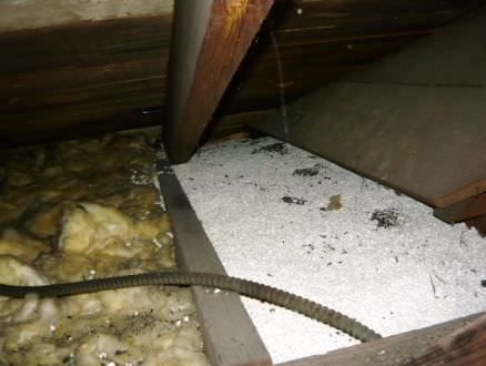

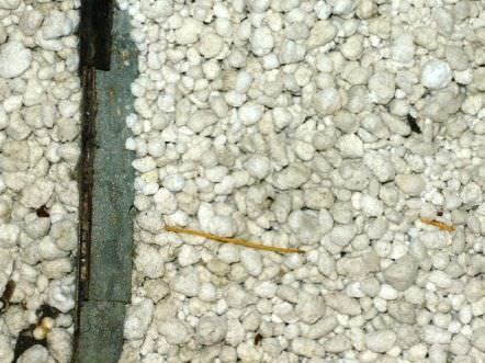

Erby Posted January 15, 2011 Report Share Posted January 15, 2011 From a friend: =============== "I found this stuff in the attic of a 75+ year old home in Louisville today. There was multiple types of insulation in the attic. This stuff looked like and was the same size of Styrofoam beads. But when I pinched a bead of the stuff it easily turned to power. It was the consistence of talcum power." Click to Enlarge 25.76 KB Click to Enlarge 43.53 KB ======================= Perlite doesn't turn to powder in my experience. Any other ideas? - Link to comment Share on other sites More sharing options...
Chad Fabry Posted January 15, 2011 Report Share Posted January 15, 2011 I think it's expanded perlite Link to comment Share on other sites More sharing options...
Erby Posted January 15, 2011 Author Report Share Posted January 15, 2011 Perlite is more like Styrofoam and wouldn't crumble to powder for me. Will "expanded" perlite crumble to powder? Link to comment Share on other sites More sharing options...
Chad Fabry Posted January 15, 2011 Report Share Posted January 15, 2011 Dunno. Urea Formaldehyde does, but I've never seen UFI beads. Link to comment Share on other sites More sharing options...
Bill Kibbel Posted January 15, 2011 Report Share Posted January 15, 2011 Perlite is more like Styrofoam and wouldn't crumble to powder for me. Will "expanded" perlite crumble to powder? Yes. Perlite is a volcanic rock that when heated, the trapped water turns to steam and expands. It then easily crumbles to powder. Link to comment Share on other sites More sharing options...

mgbinspect Posted January 17, 2011 Report Share Posted January 17, 2011 Looks like Perlite to me, as well. We used to use it as core-fill (insulation and sound dampening) in masonry walls for school gymnasiums, classrooms, etc. The tiniest hole in the wall down near the bottom, permits that stuff to sift out just like a sand clock until the core was empty. It made doing such things as installing an electrical box after construction a real pain. Link to comment Share on other sites More sharing options...

Jim Katen Posted July 29, 2011 Report Share Posted July 29, 2011 Just a guess, was there any moisture issues in the atic, or signs of moisture (mold, etc..). Could be a desiccant to soak up moisture? Ha. Sounds like something an engineer would do. The stuff in the pictures is perlite. Link to comment Share on other sites More sharing options...
