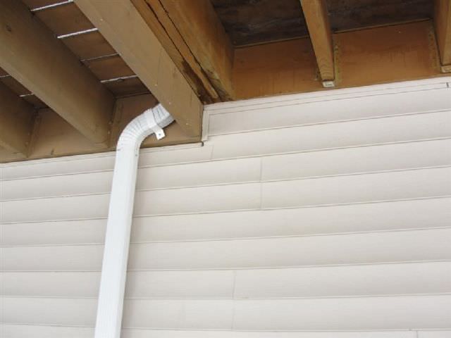

inspectorreuben Posted April 3, 2011 Report Share Posted April 3, 2011 In the photo below, there was water leaking in to the wall where the deck heights changed. I'm sure that water is running horizontally along the ledgerboard flashing and then dumping in to the wall where the flashing ends. I've found this defect on a lot of decks, but it's usually not this obvious. Does anyone have any photos or diagrams showing the proper way to terminate the ledgerboard flashing to prevent this from happening? I've gone through every archived issue of the JLC (only $45 for the DVD), and couldn't find a single article that dealt with this detail. Click to Enlarge 28.9 KB - Reuben Quote Link to comment Share on other sites More sharing options...

kurt Posted April 3, 2011 Report Share Posted April 3, 2011 I think it'd have to be done like an end dam, with a tailer that got the water out farther away from the house than conventional ledger flashing. Quote Link to comment Share on other sites More sharing options...
hausdok Posted April 3, 2011 Report Share Posted April 3, 2011 Hi, They should have integrated some self-adhering bituthene (ice and water membrane) into the flashings at the transition between the two decks behind the siding. I'd have used coil stock behind the whole thing and spacers like below. Click to Enlarge 79.86 KB ONE TEAM - ONE FIGHT!!! Mike Quote Link to comment Share on other sites More sharing options...

kurt Posted April 3, 2011 Report Share Posted April 3, 2011 Hi, They should have integrated some self-adhering bituthene (ice and water membrane) into the flashings at the transition between the two decks behind the siding. I'd have used coil stock behind the whole thing and spacers like below. Click to Enlarge 79.86 KB ONE TEAM - ONE FIGHT!!! Mike I like that idea better, although, the flashing should still have an end dam. Quote Link to comment Share on other sites More sharing options...
Bain Posted April 3, 2011 Report Share Posted April 3, 2011 Hi, They should have integrated some self-adhering bituthene (ice and water membrane) into the flashings at the transition between the two decks behind the siding. I'd have used coil stock behind the whole thing and spacers like below. Click to Enlarge 79.86 KB ONE TEAM - ONE FIGHT!!! Mike I like that idea better, although, the flashing should still have an end dam. I will never see end-dam flashing on a deck in my area . . . not that it isn't a good idea. I see decks flashed like Reuben's all the time and, even when there's no change in heights, water runs between the trim coil--which is overwhelmingly the flashing of choice--and the siding. The secret is having the lower portion of flashing act like drip-edge, as in Mike's drawing. But . . . I can't imagine I'll ever see that, either. Quote Link to comment Share on other sites More sharing options...
