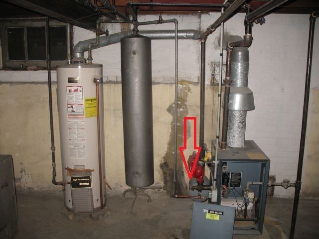

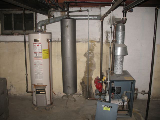

smarcus Posted May 12, 2011 Report Share Posted May 12, 2011 I am not sure if I am posting to the correct forum or if this belongs in the plumbing forum. I saw this cold water storage tank (precariously balanced) in the basement of a 30s home in Chicago. It is difficult to see from the photo (sorry for the bad picture) but water flows from down into the tank from above, cold water to the boiler doesn't flow through the tank it branches to the right just before the top of the tank. The water to the water heater goes through the tank. I thought that it may have been originally intended for use by the boiler. Being used by the water heater I would think that its current purpose would be to bring water to room temperature before entering the water heater. Can someone explain this? I am sorry if this is obvious, but it is escaping me for now. Click to Enlarge 48.51 KB Quote Link to comment Share on other sites More sharing options...
John Dirks Jr Posted May 12, 2011 Report Share Posted May 12, 2011 I've never seen a setup like that but it looks like its just a big expansion tank for the water heater. As far as water heater expansion tanks are concerned, its a bit of overkill maybe. BTW, the vent for the water heater doesnt look too good all horizontal like it is. Quote Link to comment Share on other sites More sharing options...
smarcus Posted May 12, 2011 Author Report Share Posted May 12, 2011 Thanks, I hadn't considered water heater expansion tank. Good eye, I hadn't yet realized that the vent was horizontal. I did mention that the venting was in need of correcting. There is corrosion below the dielectric union where it appears that some spillage occurs and what you can't see is that the flue empty into the chimney which is unlined for the first three feet and at the base of the chimney at the exterior there are loose mortar joints and efflorescence on a recently repointed building. Thanks for the quick reply. Quote Link to comment Share on other sites More sharing options...
Terence McCann Posted May 12, 2011 Report Share Posted May 12, 2011 Click to Enlarge 48.95 KB The arrow is pointing to an expansion tank (laying on the floor). Was this piped into the domestic water system? I would think that the tank in question was from the original boiler system and used as a water heater. Kurt or Bill K should be able to say for sure. If the cold water enters the tank and then just goes to the water heater then there is no need for it. I'm sure you noted it but the domestic water system is loaded with galvinized piping. How were your water flows? Quote Link to comment Share on other sites More sharing options...
Rob Amaral Posted May 12, 2011 Report Share Posted May 12, 2011 Looks like the original boiler's expansion tank, mounted vertically... you can see the pipe leaving the top and being connected to the distribution system of the boiler to the top-right. .. A piece of stuff no longer needed... "remove it if you want more space in your basement near the water heater and boiler'.. Quote Link to comment Share on other sites More sharing options...
mgbinspect Posted May 12, 2011 Report Share Posted May 12, 2011 Actually, I believe I posted a similar tank about two years ago and Les chimed in with an identification. I don't think it turned out to be an expansion tank. Terence, I'm drawing a blank: What's it called when you have tons of tubing within a jacket - a form of heat exchanger (notice the ports in the jacket at the top and bottom closed loop)? I think turned out to be a heat exchanger (domestic water heater) that used the original boiler for heating. Quote Link to comment Share on other sites More sharing options...
kurt Posted May 12, 2011 Report Share Posted May 12, 2011 We call them "tempering tanks". They were located next to the original coal fired boiler to pre-warm the water before it got to the water heater. You did say water flows through it to the water heater, right? I find them in the old joints all the time, but not so much anymore. I tell folks to take them out. I found one that was lead lined once. Quote Link to comment Share on other sites More sharing options...
Terence McCann Posted May 12, 2011 Report Share Posted May 12, 2011 Terence, I'm drawing a blank: What's it called when you have tons of tubing within a jacket - a form of heat exchanger (notice the ports in the jacket at the top and bottom closed loop)? I think turned out to be a heat exchanger (domestic water heater) that used the original boiler for heating. Shell & Tube. Quote Link to comment Share on other sites More sharing options...
Terence McCann Posted May 12, 2011 Report Share Posted May 12, 2011 We call them "tempering tanks". They were located next to the original coal fired boiler to pre-warm the water before it got to the water heater. You did say water flows through it to the water heater, right? I find them in the old joints all the time, but not so much anymore. I tell folks to take them out. I found one that was lead lined once. How was heating of the water accomplished then Kurt? A seperate coal fired water heater or such? Quote Link to comment Share on other sites More sharing options...
smarcus Posted May 12, 2011 Author Report Share Posted May 12, 2011 Water flow was great to the first floor and pretty low to the second. I did conclude while I was there discussing with the client that it did not appear to do anything significant and could be removed. I hadn't considered that it may be lined with lead, but that is a good point with the age of the tank. There was another old boiler expansion tank mounted horizontally between the joists (just out of photo) so I don't believe that it ever functioned as an expansion tank for the boiler. Tempering tank makes sense with its proximity to the boiler. Thanks for all the responses, nothing is worse than looking at a system that looks like it is functioning perfectly well and not knowing what a part of it does. Quote Link to comment Share on other sites More sharing options...
kurt Posted May 13, 2011 Report Share Posted May 13, 2011 How was heating of the water accomplished then Kurt? A seperate coal fired water heater or such? I'm not sure. Folklore from one of my old plumbing gurus (who, if he were alive, would be about 110 years), told me these were tempering tanks. I've only ever found these in smaller working class housing. I have some suspicion that it was the sole heating component, i.e., it was a water warmer in winter, and in summer it was cold shower time. Quote Link to comment Share on other sites More sharing options...
Jerry Simon Posted May 13, 2011 Report Share Posted May 13, 2011 I find them in the old joints all the time, but not so much anymore. That's a la Yogi Berra, right? Quote Link to comment Share on other sites More sharing options...
kurt Posted May 13, 2011 Report Share Posted May 13, 2011 I need an editor. I meant to say "used to"......didn't. It is kinda like a Yogism, except his are funny. Mine are just confused. Quote Link to comment Share on other sites More sharing options...
Bill Kibbel Posted May 14, 2011 Report Share Posted May 14, 2011 That tank was manufactured to be part of a "range boiler" domestic hot water system. It is now being used as a tempering tank for the boiler feed and cold supply to the gas water heater. A range boiler is a system that generated hot water by a "water back" in the firebox of coal range. Click to Enlarge 17.88 KB Quote Link to comment Share on other sites More sharing options...
John Kogel Posted May 14, 2011 Report Share Posted May 14, 2011 Thanks for the pic, Bill. We called that thing in the stove a "water jacket". The tall shape made for better separation of the hot from the cold. Steve, that one is being held up by the plumbing. You are right it is a tempering tank and should be strapped to the wall. I don't know about the lead. They could do a water test. They are usually just a nice copper tank, I think? They could run that WH gas vent in a nearly straight line from the tank to the chimney, maybe with a slight curve around the front of the plumbing pipes. Quote Link to comment Share on other sites More sharing options...
Terence McCann Posted May 14, 2011 Report Share Posted May 14, 2011 That tank was manufactured to be part of a "range boiler" domestic hot water system. It is now being used as a tempering tank for the boiler feed and cold supply to the gas water heater. A range boiler is a system that generated hot water by a "water back" in the firebox of coal range. Click to Enlarge 17.88 KB Thanks Bill. The tank can be removed from the system. It's no longer needed as a water heater and the boiler is being used for hydronic heating. For residential steam systems, at least around here, I've never seen a pre-heater for makup water whether it's for a single or two pipe system (and we've got some pretty old shacks around ch'ere). For two pipe it typically goes into the condensate return. I asked once before, and I'll try once more (however I doubt the traction is any better) where do you gold mine all your pictures Bill? You had one of a structural terra cotta foundation layout (that I swiped) and I searched high and low for that, via Google, with no joy. Here, email, PM, IM, Skype, smoke signals, telepathatcly - just not after 9 PM, can't stay up late anymore. Quote Link to comment Share on other sites More sharing options...
