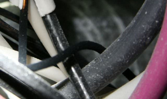

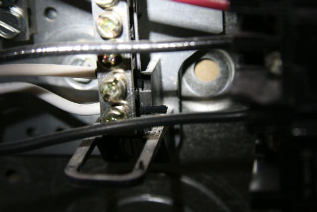

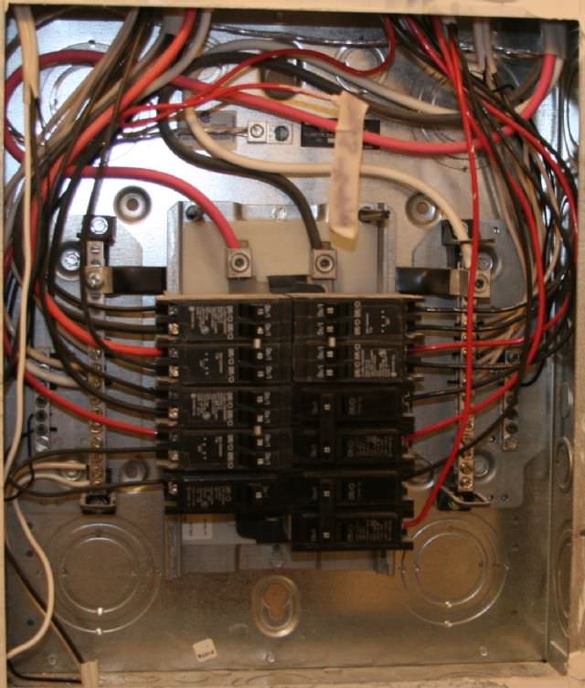

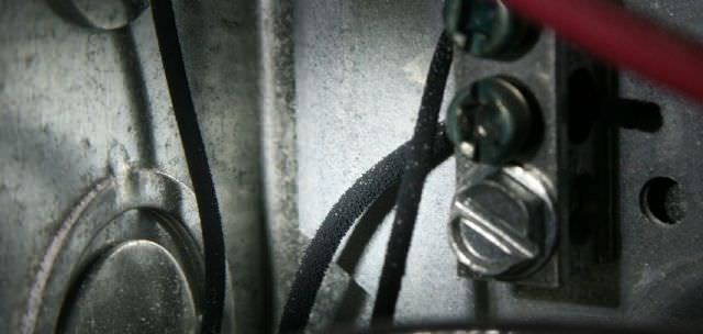

ejager Posted July 23, 2011 Report Share Posted July 23, 2011 Good morning Brain trust! I did an inspection of a 2001 condo with blackened copper wires. This was in Calgary so "high-sulpher" drywall is not really suspected, though it is not ruled out. The wires are almost 'fuzzy black' not just a simple black/grey corrosion. First noticed it in the panel, which was in a dry storage closet. In the tightest corners of the panel, the ground wires still have patches of copper. I went looking at wall outlets and saw the same problem. Water pipe is all PEX so it was no indicator. No pool, no signs of high humidity.... any other ideas what might be a cause? Click to Enlarge 31.43 KB Click to Enlarge 30.4 KB Click to Enlarge 49.51 KB Click to Enlarge 32.21 KB Quote Link to comment Share on other sites More sharing options...

gpdewitt Posted July 24, 2011 Report Share Posted July 24, 2011 In the 3rd picture, the receptacle, is that a hot, neutral or ground? By it's location, looks like a hot or neutral, so is that black fuzz on the insulation as well, or is that way too much bare wire for a current carrying wire? Quote Link to comment Share on other sites More sharing options...
ejager Posted July 24, 2011 Author Report Share Posted July 24, 2011 The 'black wire' in the third picture was the uninsulated black ground wire, they back-stabbed the hot and neutral wires. this receptacle was 15 ft from the hall closet. The receptacle in the kitchen across the condo showed similar copper corrosion. So the US Consumer Protection remediation guidance for homes with problem drywall calls for the replacement of all: problem drywall; fire safety alarm devices, including smoke and carbon monoxide alarms; electrical distribution components, including receptacles, switches and circuit breakers; and gas service piping and fire suppression sprinkler systems . http://www.cpsc.gov/cpscpub/prerel/prhtml11/11176.html Assuming this is not drywall for the time being, would these guidelines still be the recommended course of action for electrical repairs? And why would steel gas piping and steel fire supression sprinklers systems need repalcing? - Overly cautious? Quote Link to comment Share on other sites More sharing options...

Rocon Posted July 24, 2011 Report Share Posted July 24, 2011 Guys, I am not completely buying into the sulfur or off gassing. The fuzz only occurs on black wires, and it seems only the 12-14 ga. not the larger conductors. Some may say that the larger wires are not copper, however sulfur oxidizes aluminum also. The photos I have seen of homes with the Chinese drywall, they have no visible damage to the insulation. The sulfur passes through the insulation and corrodes the wires along the length of the wires. That is why homes with Chinese drywall cannot just strip some more insulation to expose fresh wire. Additionally in the top left of photo #2, I can see some bright or very lightly tarnished copper. If sulfur was the issue the copper would have a complete black patina, it is next to the insulation with fuzz and should be subject to the same environmental effects. I think it might be wise to look towards the plasticizer in the insulation casing. The plasticizer might be reacting to an environmental issue or it could be something related to the particular manufacturer of that wire. Some more questions I would ask: â⬢ Can the wire be identified by any of the casing marks? o If the wire can be identified research if any insulation failures are known. â⬢ Could the wire have been exposed to chemicals before installation? o (back of the truck) â⬢ Could those wires be/have been conducting too much current? Quote Link to comment Share on other sites More sharing options...
ejager Posted July 25, 2011 Author Report Share Posted July 25, 2011 Sorry if I confused the issue Rocon. The fuzz occurs only on the bare copper wires, but it was so thick that I thought I might be looking at nylon covered wires. On the exposed end of the neutral wires in the previoiusly posted photo one, we can see the black corrosion. In the second photo, as you pointed out there is some very bright copper. This is the ground wire and where the outher sheating for the cable protected it, it was unaffected. In the last photo there is some regular green oxidation of screws in the grounding bar, as well as black oxidation of the ground wire. You are right that there didn't appear to be any effect on the aluminum SEC. Here is a whole panel pic... Click to Enlarge 89.95 KB My clients are not interested in pursuing the why's of how this came to be, there were enough other things off-putting about the unit and building to make them search elsewhere. I on the other hand, want to rip apart the wall, to find the brand/manufacturerer of the wire as you suggest. I want to knock on the neighbour's door and ask if I can remove the cover from their panels, and remove some switch plates in the front lobby. Oh, and thanks to all for all the help, insight and discussion! This board is fantastic! Quote Link to comment Share on other sites More sharing options...
