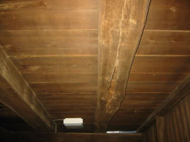

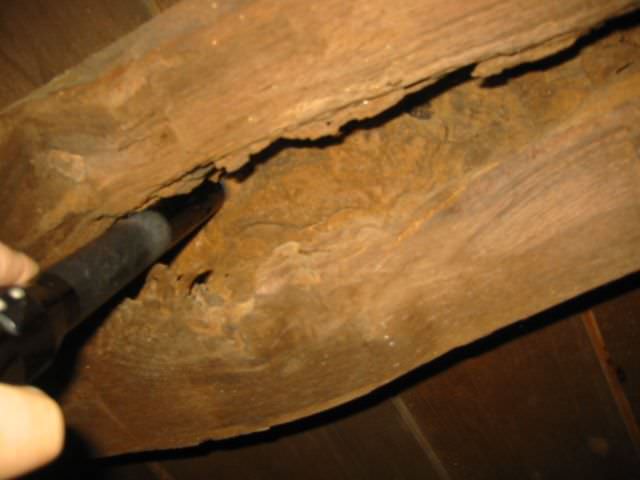

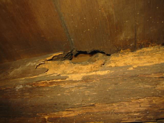

Inspectorjoe Posted October 30, 2011 Report Share Posted October 30, 2011 Tuesday, I'm inspecting an 1860 bank barn which was converted to a residence in 1974. I'm concerned about insect damage/rot in the floor structure and I'm not sure what I should say about it. The floor planks and support structure were used with no apparent modifications or repairs when it was converted, other than a finish being applied. Walking around the main floor, there are many potential trip hazards due to unevenness. At least one of the timbers is mostly hollowed out, and some of the planks are pretty much gone above their supporting timbers. There's some give in these areas when walked on. It seems to have been performing OK for the past 37 years, but I don't want to get a call someday informing me that the piano mover fell through the floor, and the piano landed on top of him. Any advice would be greatly appreciated. Click to Enlarge 37.92 KB Click to Enlarge 36.34 KB Click to Enlarge 47.4 KB Click to Enlarge 46.63 KB Quote Link to comment Share on other sites More sharing options...

Inspectorjoe Posted October 31, 2011 Author Report Share Posted October 31, 2011 At least one of the timbers is nearly completely hollowed out. Those epoxies wouldn't be effective on something like that, would they? Quote Link to comment Share on other sites More sharing options...

davidlord Posted October 31, 2011 Report Share Posted October 31, 2011 Looks like powder post beetle damage Quote Link to comment Share on other sites More sharing options...
allseason Posted October 31, 2011 Report Share Posted October 31, 2011 Looks like powder post beetle damage Sure does. Another repair alternative is recycled old lumber from an old building demolition. There are lumber yards that specialize in this stuff and that would likely be a stronger repair and true to the original construction. Quote Link to comment Share on other sites More sharing options...
Bill Kibbel Posted November 3, 2011 Report Share Posted November 3, 2011 Joe, Sorry to have not replied sooner. Mom passed away Thursday night, then Saturdays storm placed hundreds of trees in all/any roads leading to home. Power has finally been restored late this afternoon. I don't see anything there that would benefit from an epoxy sealer, filler or consolidant. It needs repairs and the typical, traditional repair for hand-hewn timbers is what Mike O'. suggested, although lumberyards only have milled timbers. There's plenty of salvaged hewn timbers and hand-planed floor planks available in these parts. Quote Link to comment Share on other sites More sharing options...
