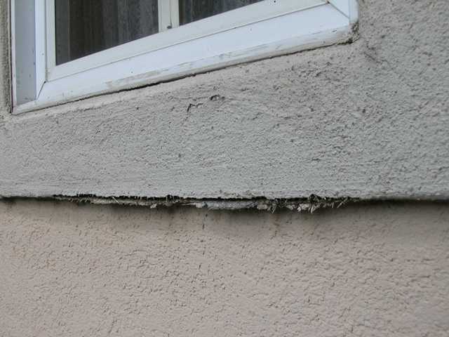

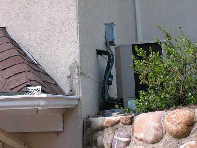

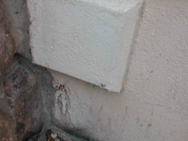

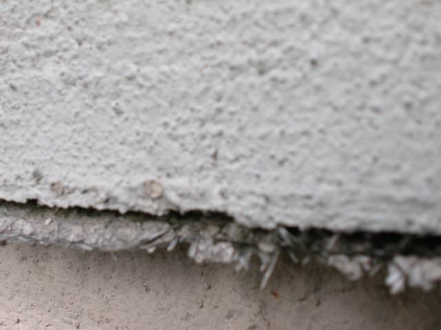

Steven Hockstein Posted May 28, 2005 Author Report Share Posted May 28, 2005 One more time. Here are the stucco photos in a smaller format. The deck photo shows what can happen when a deck is cantilevered and the framing is not properly flashed. This is an accident waiting to happen. Download Attachment: rotted deck.jpg 45.23 KB Download Attachment: Stucco corner.jpg 37.38 KB Download Attachment: Visible Lathe.jpg 46.74 KB Download Attachment: Window close-up.jpg 47.05 KB Download Attachment: Window trim.jpg 38.39 KB Quote Link to comment Share on other sites More sharing options...
hausdok Posted May 28, 2005 Report Share Posted May 28, 2005 Yeah, That's a hack job. No expansion accessories, in contact with the ground, no casing beads, poorly applied mortar, too close to the roof, needs kickouts, on and on and on. That guy should have his contractor's license pulled. ONE TEAM - ONE FIGHT!!! Mike Quote Link to comment Share on other sites More sharing options...
